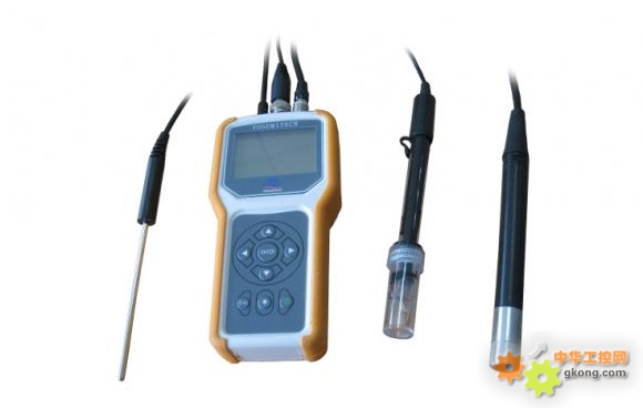

ÓíɽÐÂÒ»´ú¶à²ÎÊýË®ÖÊ·ÖÎöÒDzÉÓÃSmart Meter¼¼Êõ£¬RS485Êý×Ö½Ó¿Ú£¬MODBUSÐÒ飬¿É²âÈܽâÑõ¡¢µçµ¼¡¢×Ƕȡ¢PH¡¢ORPºÍζȵȲÎÊý£¬¾ß±¸Ë®ÎºʹóÆøÑ¹Á¦×Ô¶¯²¹³¥¹¦ÄÜ¡£Í¬Ê±£¬ËüÒ²¿ÉÒÔºÍÖÇÄÜÊÖ»úÒÔ¼°Æ½°åµçÄÔͨ¹ýÀ¶ÑÀ½øÐÐÁ¬½Ó£¬ÔÚSmart Meter appµÄÖ§³ÖÏÂÓÉÊÖ»ú»òÊÇÆ½°åÀ´¿ØÖÆ£¬ÊµÏÖÐí¶à´«Í³ÒDZíÎÞ·¨ÊµÏֵŦÄÜ¡£
²úÆ·ÌØµã
- Ò»»ú¶àÓ㬿ÉͬʱÁ¬½ÓÓíɽÊý×Ö´«¸ÐÆ÷¡¢pHºÍζȴ«¸ÐÆ÷£»
- ÈÜÑõ´«¸ÐÆ÷²ÉÓÃÓ«¹âÊÙÃü¼¼Êõ£¬ÎÞÁ÷ËÙÏÞÖÆ£¬ÄêÆ¯ÒÆ<1%£»
- ×Ô¶¯ÆøÑ¹²¹³¥£¬128 x 64 LCD ´ø±³¹âÏÔʾ½çÃæ£»
- ÎÞÏßÀ¶ÑÀͨÐÅ£¬Ö§³ÖÊý¾Ý´æ´¢ºÍÓû§Ð£×¼£»
- Smart Meter App£ºÖ§³ÖÓëAndriodÊÖ»ú»òƽ°åÁ¬½Ó¡£¿ÉʵÏÖÓû§Ð£×¼¡¢ÅÄÕÕ¡¢¶¨Î»¡¢Óʼþ·¢Ëͼ°Êý¾Ý¼Ç¼µÈ¹¦ÄܸüÇ¿´ó£¬Ê¹Óøü±ã½Ý¡£

Y2001
¶à¹¦ÄÜË®Öʼì²âÖ÷»ú¡¢ÈܽâÑõ´«¸ÐÆ÷¡¢pH¸´ºÏµç¼«¡¢Î¶ȼơ¢4½ÚAAAµç³Ø£¬²Ù×÷ÊÖ²á
Y602-A
¶à¹¦ÄÜË®ÖÊ·ÖÎöÒÇ±í¡£±íÍ·£¬¿É½ÓÊý×ֵ缫£¬pH£¬Î¶È̽ͷ
Y602-B
¶à¹¦ÄÜË®ÖÊ·ÖÎöÒÇ±í¡£±íÍ·£¬Ö§³ÖÀ¶ÑÀ£¬¿Éͨ¹ýSmart Meter appÓ밲׿ÊÖ»úͨѶ£¬¿É½ÓÊý×ֵ缫£¬PH£¬Î¶È̽ͷ
Y500-B
±ãЯʽӫ¹â·¨ÈܽâÑõ´«¸ÐÆ÷
Y530-A
PHµç¼«£¬0-14£¬µ¥ÑÎÇÅ£¬ÅäºÏY602-AʹÓÃ
Y540-A
ζȴ«¸ÐÆ÷£¬ÍêÈ«½þûʽ£¬3.5mm¶ú»ú½Ó¿Ú£¬ÅäºÏY602-AʹÓÃ
