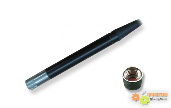

Óíɽ±ãЯʽӫ¹â·¨ÈܽâÑõ´«¸ÐÆ÷£¬²ÉÓÃÁ˹ú¼ÊÁìÏȵÄÓ«¹âÊÙÃü¼¼Êõ¡£RS485Êä³ö£¬Ö§³ÖMODBUS£¬ÃâÓÚά»¤£¬¿ÉÒÔ¿ìËÙ׼ȷµØ²âÁ¿³öÈܽâÑõº¬Á¿£¬ÄÚÖÃζȴ«¸ÐÆ÷£¬¾ß±¸Ë®ÎÂ×Ô¶¯²¹³¥¹¦ÄÜ¡£Äܹ»ÌṩÎȶ¨£¬Öظ´ÐԸߣ¬¸ßÁéÃô¶ÈµÄÈܽâÑõ·ÖÎö½á¹û¡£
²â¶¨ÔÀí
Ó«¹â·¨ÈܽâÑõ²â¶¨ÒÇÊÇ»ùÓÚÎïÀíѧÖÐÌØ¶¨ÎïÖʶԻîÐÔÓ«¹âµÄâ§Ï¨ÔÀí¡£À´×ÔÒ»¸ö·¢¹â¶þ¼«¹Ü£¨LED£©·¢³öµÄÀ¶¹âÕÕÉäÔÚÓ«¹âñÄÚ±íÃæµÄÓ«¹âÎïÖÊÉÏ£¬ÄÚ±íÃæµÄÓ«¹âÎïÖÊÊÕµ½¼¤·¢£¬·¢³öºì¹â£¬Í¨¹ý¼ì²âºì¹âÓëÀ¶¹âÖ®¼äµÄÏàλ²î£¬²¢ÓëÄÚ²¿±ê¶¨Öµ±È¶Ô£¬´Ó¶ø¼ÆËã³öÑõ·Ö×ÓµÄŨ¶È£¬¾¹ýÎÂ¶ÈºÍÆøÑ¹×Ô¶¯²¹³¥Êä³ö×îÖÕÖµ¡£
´«¸ÐÆ÷ÌØµã
- Êý×Ö´«¸ÐÆ÷£¬RS485Êä³ö£¬Ö§³ÖMODBUS
- ÎÞĤ£¬ÎÞÐèµç½âÒº£¬ÎÞ¸ÉÈÅ£¬ÎÞÐèÆµ·±Ð£×¼
- ²»»áÏûºÄÑõ£¬Ã»ÓÐÁ÷ËÙÏÞÖÆ
- ÄÚÖÃζȴ«¸ÐÆ÷£¬×Ô¶¯Î¶Ȳ¹³¥
¼¼Êõ²ÎÊý
Ãû³Æ
²ÎÊý
Á¿³Ì·¶Î§
0~20mg/L»ò0~200%±¥ºÍ¶È
¾«¶È
1%
ÏìӦʱ¼ä
10 sec
´«¸ÐÆ÷Æ¯ÒÆ
<1% per year
ζȷ¶Î§
0 ~ 50¡æ
ζȾ«¶È
±0.2¡æ
·À»¤µÈ¼¶
IP68
×î´ó²Ù×÷ѹÁ¦
6bar
´«¸ÐÆ÷½Ó¿Ú
Ö§³ÖRS-485£¬ MODBUSÐÒé
µçÔ´ÐÅÏ¢
DC 6~12V£¬µçÁ÷<50mA
´«¸ÐÆ÷³ß´ç
Φ16*180 mm
̽ͷÏßÀ³¤¶È
5m£¬ÁíÍâ¿Í»§¿ÉÑ¡10m¡¢15mºÍ30mÏßÀÂ
У׼
Ò»µã»òÁ½µãУ׼
Ó«¹âñÊÙÃü
±£Ö¤Ê¹ÓÃÒ»Ä꣨Õý³£Ê¹ÓÃÏ£©
´«¸ÐÆ÷²ÄÁÏ
POM»ò²»Ðâ¸Ö
