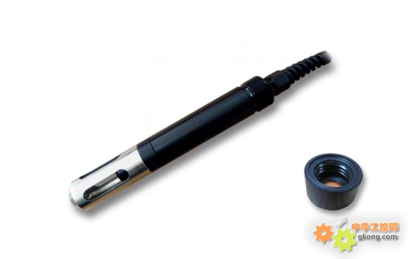

²úÆ·Ãû³Æ£º ÔÚÏßÓ«¹â·¨ÈܽâÑõ´«¸ÐÆ÷
ÐÍ ºÅ£º Y502-A
ÓíÉ½ÍÆ³öÐÂÒ»´úÔÚÏßÓ«¹â·¨ÈܽâÑõ´«¸ÐÆ÷£¬²ÉÓÃÁ˹ú¼ÊÁìÏȵÄÓ«¹âÊÙÃü¼¼Êõ¡£RS485Êä³ö£¬Ö§³ÖMODBUS£¬ÃâÓÚά»¤£¬¿ÉÒÔ¿ìËÙ׼ȷµØ²âÁ¿³öÈܽâÑõº¬Á¿£¬ÄÚÖÃζȴ«¸ÐÆ÷£¬¾ß±¸Ë®ÎÂ×Ô¶¯²¹³¥¹¦ÄÜ¡£Äܹ»ÌṩÎȶ¨£¬Öظ´ÐԸߣ¬¸ßÁéÃô¶ÈµÄÈܽâÑõ¼à²â½á¹û¡£
´«¸ÐÆ÷ÌØµã
  • Êý×Ö´«¸ÐÆ÷£¬RS485Êä³ö£¬Ö§³ÖMODBUS
  • ÎÞĤ£¬ÎÞÐèµç½âÒº£¬ÎÞ¸ÉÈÅ£¬ÎÞÐèÆµ·±Ð£×¼
  • ²»»áÏûºÄÑõ£¬Ã»ÓÐÁ÷ËÙÏÞÖÆ
  • ÄÚÖÃζȴ«¸ÐÆ÷£¬×Ô¶¯Î¶Ȳ¹³¥
¼¼Êõ²ÎÊý
Ãû³Æ
²ÎÊý
Á¿³Ì·¶Î§
0~20mg/L»ò0~200%±¥ºÍ¶È
¾«¶È
1%
ÏìӦʱ¼ä
10 sec
´«¸ÐÆ÷Æ¯ÒÆ
<1% per year
ζȴ«¸ÐÆ÷
NTC
ζȷ¶Î§
0 ~ 50¡æ
ζȾ«¶È
±0.2¡æ
·À»¤µÈ¼¶
IP68
×î´ó²Ù×÷ѹÁ¦
6bar
´«¸ÐÆ÷½Ó¿Ú
Ö§³ÖRS-485£¬ MODBUSЭÒé
×°Åä
6·ÖÔ²ÖùÂÝÎÆ£¬½þÈëʽ°²×°
µçÔ´ÐÅÏ¢
DC 6~12V£¬µçÁ÷<50mA
´«¸ÐÆ÷³ß´ç
Φ26*177.5 mm
̽ͷÏßÀ³¤¶È
10m£¬ÁíÍâ¿Í»§¿ÉÑ¡5m¡¢15mºÍ30mÏßÀÂ
У׼
Ò»µã»òÁ½µãУ׼
Ó«¹âñÊÙÃü
±£Ö¤Ê¹ÓÃÒ»Ä꣨Õý³£Ê¹ÓÃÏ£©
´«¸ÐÆ÷²ÄÁÏ
POM»ò²»Ðâ¸Ö
¶©¹ºÐÅÏ¢
ÐͺÅ
ÃèÊö
Y502-A
ÔÚÏßÓ«¹â·¨ÈܽâÑõ´«¸ÐÆ÷£¬¹Ò»·Ê½
Y504-A
ÔÚÏßÓ«¹â·¨ÈܽâÑõ´«¸ÐÆ÷£¬6·ÖÔ²ÖùÂÝÎÆ
Y610-A
ÔÚÏß±äËÍÆ÷£¬¿É½ÓÓíɽÊý×Ö´«¸ÐÆ÷£¬Ò»Â·Êý×ÖÊäÈ룻Á½Â·4-20mAÄ£ÄâÊä³ö£»Ò»Â·Êý×ÖÊä³ö
¿ÉÑ¡¸½¼þ
ÐͺÅ
ÃèÊö
Y9002
ÔÚÏßÈܽâÑõÓ«¹âñ¡£Õý³£Ê¹ÓÃÇé¿öÏ£¬½¨ÒéÒ»Äê¸ü»»Ò»´ÎÓ«¹âñ
