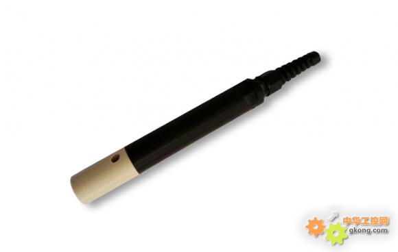

²úÆ·Ãû³Æ£º Ëĵ缫µçµ¼ÂÊ´«¸ÐÆ÷
ÐÍ ºÅ£º Y520-A
Óíɽ´«¸ÐÍÆ³öÐÂÒ»´úËĵ缫µçµ¼ÂÊ´«¸ÐÆ÷£¬²ÉÓùú¼ÊÁìÏȵÄËĵ缫¼¼Êõ£¬RS485Êý×Ö½Ó¿Ú£¬Ö§³ÖMODBUSЭÒ飬»·±£ÐÍÉè¼Æ¡£
Óíɽ´«¸ÐÍÆ³öÐÂÒ»´úËĵ缫µçµ¼ÂÊ´«¸ÐÆ÷£¬²ÉÓùú¼ÊÁìÏȵÄËĵ缫¼¼Êõ£¬RS485Êý×Ö½Ó¿Ú£¬Ö§³ÖMODBUSЭÒ飬»·±£ÐÍÉè¼Æ¡£Ïà±È´«Í³µÄÁ½µç¼«µçµ¼´«¸ÐÆ÷²»½ö¾«¶È¸ü¸ß£¬²âÁ¿·¶Î§¸ü¹ã£¬Îȶ¨ÐÔ¼«¼Ñ¡£Ëĵ缫µçµ¼ÂÊ´«¸ÐÆ÷»¹¾ßÓжÀÌØµÄÁ¿´óÓÅÊÆ£ºÒ»Êdz¹µ×½â¾öÁ˸ߵ絼ÂʲâÊÔʱµÄ¼«»¯ÄÑÌ⣻¶þÊǽâ¾öÁ˵缫ÎÛȾÔì³É¶ÁÊý²»×¼µÄÎÊÌâ¡£
´«¸ÐÆ÷ÌØµã
  • Êý×Ö´«¸ÐÆ÷£¬RS485Êä³ö£¬Ö§³ÖModbus
  • ²ÉÓÃËĵ缫¼¼Êõ£¬²»»á¼«»¯£¬Î¬»¤ÖÜÆÚ¸ü³¤
  • Á¿³Ì¼«Æä¿í¹ã£¬¿¹¸ÉÈÅÄÜÁ¦Ç¿
  • ÄÚÖÃζȴ«¸ÐÆ÷£¬ÊµÊ±Î¶Ȳ¹³¥

Á¿³Ì·¶Î§
1uS/cm~200 mS/cm
ÏìӦʱ¼ä
<2 sec
·À»¤µÈ¼¶
IP68
µçµ¼¾«¶È
1%
µç¼«²ÄÁÏ
Äø
»¤ÌײÄÁÏ
PEEK
ζȷ¶Î§
0 ~ 50¡æ
´«¸ÐÆ÷½Ó¿Ú
Ö§³ÖRS-485£¬ MODBUSЭÒé
µçÔ´ÐÅÏ¢
DC 5~12V £¬µçÁ÷<50mA
ζȴ«¸ÐÆ÷
NTC
´«¸ÐÆ÷³ß´ç
Φ22x146.5 mm
̽ͷÏßÀ³¤¶È
10m£¬ÁíÍâ¿Í»§¿ÉÑ¡5m¡¢15mºÍ30mÏßÀÂ
У׼
Ò»µã»òÁ½µãУ׼
¶©¹ºÐÅÏ¢
ÐͺÅ
ÃèÊö
Y520-A
Êý×ÖËĵ缫µçµ¼ÂÊ´«¸ÐÆ÷£¬±êÅä10Ã×ÏßÀ£¬RS485Êä³ö
