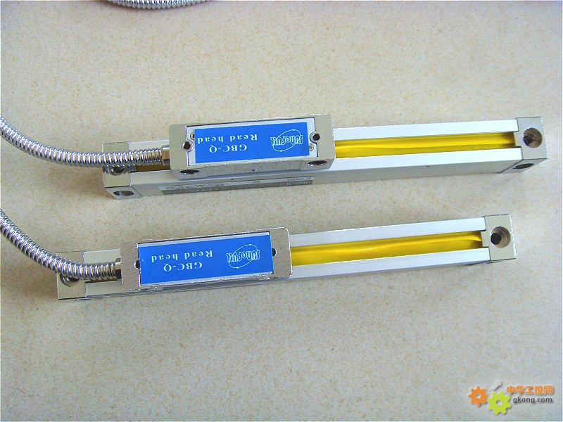

´ÅÐԳ߲âÁ¿ÏµÍ³×¨ÎªÏßÐÔÎ»ÒÆ²âÁ¿¶øÉè¼Æ¡£
´ÅÕ¤³ß¾­¼Ã,ЧÂÊÌØ±ðÊÊÓÃÓÚ³¤¾àÀëµÄ²âÁ¿.
ÌØ±ðÊÊÓÃÓÚÈçÓÍÎÛ,ÇÐÏ÷м,Õ𶯵ȶñÁÓ»·¾³.
´ÅÕ¤³ßÒÀÓ¦ÓÃÐÔÖʲ»Í¬¿É¶¨Òå³öÁ½¸ö²»Í¬µÄϵͳ
´ÅÕ¤³ß²âÁ¿ÏµÍ³:
ʹÓÃÓÚÏßÐÔÎ»ÒÆ²âÁ¿²¢ÓÚÏÔʾÆ÷ÏÔʾ²âÁ¿Öµ
´ÅÐÔ±àÂëÆ÷:
ʹÓÃÓÚÏßÐÔÎ»ÒÆ²âÁ¿²¢½«Î»ÒÆÁ¿×ª»»Îª¶ÔÓ¦µÄÂö²¨ÊýÊä³ö¸øPLC»ò¿ØÖÆÆ÷.
´ÅÕ¤³ßÌØµã£º
¾«¶È¸ß:´ÅÕ¤³ß·Ö±æÂʿɴï0.0002MM,ϵͳ¾«¶È0.01MM
ÐźÅÇ¿:´ÅÕ¤³ß¶ÁÍ·Êä³öÐźÅΪ24VPPÊä³ö,¿ÉÒÔÖ±½Ó¸ø¶þ´ÎÉ豸,ÈçPLC,¼ÇÊýÆ÷µÈ
´ÅÕ¤³ßÐźÅÊä³öÐÎʽ¶à:PP/OP/LD/TTL; SSI/RS485/RS422 (5V,24V) 1V~~ÕýÏÒ²¨ÐźŠ4-20MAµçÁ÷ÐźŠ0-10VDC µç×è¶àÖÖÐÎʽ
´Å´ø´ÅÐÔÎȶ¨,ʹÓÃÊÙÃü³¤,10Äê²»¶ª´Å
²úÆ·ÆëÈ«. (·Ö±æÂÊ:0.0002MM,0.001MM,0.01MM,0.025MM,0.04MM,0.1MM,
0.25MM,1MM)
·À»¤µÈ¼¶¸ß:IP67,¿ÉÖ±½Ó¹¤×÷ÓÚÓÍ,Ë®,100¶È¸ßεȶñÁÓ»·¾³
