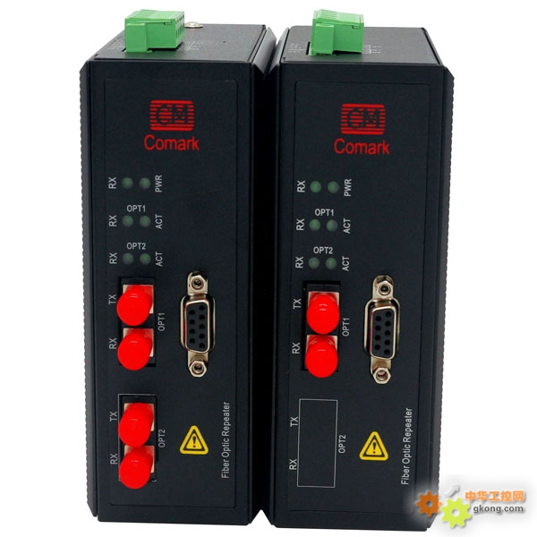

²úÆ·Ãû³Æ£º profibus×ÜÏßת¹âÏË
ÐÍ ºÅ£º CI-PF110/120
PROFIBUS×ÜÏß¹âÏËÖÐ¼ÌÆ÷ÔÚ¹¦ÄÜÉÏ¿ÉÒÔÌæ´úSiemens(Î÷ÃÅ×Ó) OLM-G11¡¢G12(6GK1502¡¢6GK1503)¹âÏËÁ´Â·Ä£¿é£¬ÔÚ¹úÄÚÊ×¼ÒÍÆ³ö²¢ÖÁ½ñÒѾ­ÉÏÍǫ̀ʹÓá£
  Ci-PF110/120ϵÁвúÆ·ÊÇÒ»¿î¹¤Òµ¼¶PROFIBUS×ÜÏß¹âµçת»»Æ÷£¬Ö§³ÖProfibus-DPЭÒ飬 Í¨ÐÅËÙÂÊ6Mbps£¨¿ÉÑ¡12Mpbs£©£¬µ¥¹â¿Ú/Ë«¹â¿ÚÁ´ÍøÖ§³Ö¡£IP30·À»¤µÈ¼¶£¬²¨ÀËÎÆÂÁÖÆ¼ÓÇ¿»ú¿Ç£¬35mm DINµ¼¹ì°²×°£¬DC£¨9~30V£©¿íµçÔ´£¬¾ß±¸¼ÌµçÆ÷¸æ¾¯Êä³ö£¬Ë«µçÔ´ÈßÓàºÍ¸ôÀë±£»¤¹¦ÄÜ¡£ Ci-PF110Ö§³Öһ·¹âÏ˽ӿڣ¬Ò»Â·×ÜÏßÊý¾Ý½Ó¿Ú£¬Ci-PF120Ö§³ÖÁ½Â·¿É¼¶ÁªÉÏÏÂÐйâÏ˽ӿڣ¬Ò»Â·×ÜÏßÊý¾Ý½Ó¿Ú¡£
×ÜÏßÊý¾Ý½Ó¿Ú
* DB9F½Ó¿ÚÐÎʽ
* ×ÜÏßÊý¾Ý½Ó¿ÚÍêÈ«¼æÈÝProfibus-DP×ÜÏßµçÀ½ӿڣ¬Í¨ÐÅËÙÂÊ£º6Mbps£¨¿ÉÑ¡12Mbps£©
* ¸ôÀëµçѹ£ºË²¼ä¸ôÀëµçѹ5000V£¬³ÖÐø¸ôÀëµçѹ1000V
* Öն˵ç×裺±¾»úÄÚ²¿²»´øÖն˵ç×裬Çë°´ÐèÒª¾ö¶¨ÊÇ·ñÍâ½Ó
¹âÏ˽ӿÚ
* ¹âÏ˲¨³¤£º¶àÄ£850nm¡¢1310nm£»µ¥Ä£1310nm¡¢1550nm
* ´«Êä¹âÏË£º¶àÄ£50/125um¡¢62.5/125um¡¢100/140um£¬µ¥Ä£8.3/125um¡¢9/125um¡¢10/125um
* ´«Êä¾àÀ룺¶àÄ£2km£¬µ¥Ä£20km£¬¸üÔ¶¾àÀë¿ÉÑ¡
* ¹âÏ˽ӿÚÀàÐÍ£ºST¡¢SC¡¢FC¿ÉÑ¡£¬±êÅäST¹â½Ó¿Ú
µçÔ´¼°±£»¤
* µçÔ´£ºË«µçÔ´ÈßÓàÊäÈ룬DC(9~30V)£¬µäÐÍDC24V£¬¹¦ºÄСÓÚ1.5W£¬¾ßÓÐDC1000Vµçѹ¸ôÀëÒÔ¼°·´½Ó±£»¤¹¦ÄÜ£¬¹¤Òµ¶Ë×Ó½Ó¿Ú
* ¼ÌµçÆ÷¸æ¾¯Êä³ö£º¹âÏËÁ´Â·¹ÊÕϸ澯Êä³ö£¬´¥µã×î´óÈÝÁ¿£ºDC48V/1A£¬¹¤Òµ¶Ë×Ó½Ó¿Ú
»úÐµÌØÐÔ
* ÍâÐγߴ磺136×106×54mm
* Íâ¿Ç£ºIP30·À»¤µÈ¼¶£¬²¨ÀËÎÆÂÁÖÆ¼ÓÇ¿»ú¿Ç
* °²×°·½Ê½£º35mm DINµ¼¹ì°²×°
* ¾»ÖØ£º800g
¹¤×÷»·¾³
* ¹¤×÷ζȣº-10¡æ~70¡æ£¬¿ÉÑ¡¿íβúÆ·£¨-40~85¡æ£©
* ´æ´¢Î¶ȣº-40¡æ~85¡æ
* Ïà¶Ôʪ¶È£º≤90%£¨ÎÞÀäÄý£©
