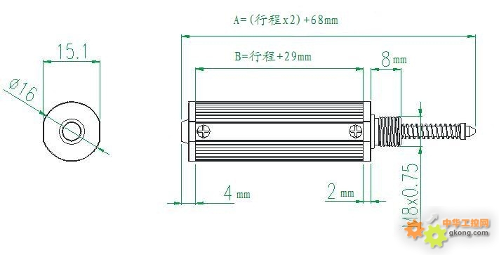

SKP΢ÐÍÎ»ÒÆ(Ô²ÐÎ΢ÐÍ×Ô»Ö¸´Ê½)
Ò»¡¢²úÆ·½éÉÜ
SKP³¬Ð¡ÐÍ×Ô»Ö¸´Ê½Î»ÒÆ´«¸ÐÆ÷£¬Ðг̴Ó0-25mm ,ͨ¹ý±äËÍÆ÷Êä³ö·½Ê½¿ÉÑ¡0-5V,0-10V,4-20mA£¬¸ß¾«¶È 0.3%FSÌå»ýС£¬°²×°·½±ã£¬Ê¹ÓÃÊÙÃü³¤¡£
¶þ¡¢¼¼Êõ²ÎÊý
ÓÐЧÐгÌ
5
10
15
20
25
ÏßÐÔ¾«¶È (±%FS)
0.3%
×èÖµ±10%
2.0
2.0
3.0
4.0
5.0
ÖØ¸´¾«¶È
0.01mm
½âÎö¶È
InfiniteÎ޶ϽâÎö
ζÈϵÊý
                                    ≤1.5ppm/¡æ
¹¤×÷µçѹ
( 4KΩ¡«5K Ω): ≤24VDC; ( 2KΩ¡«3K Ω): ≤12VDC; (  1KΩ): ≤5VDC;
»·¾³Î¶È.
 -30¡æ¡«+125¡æ
¸ºÔØÌØÐÔ
≥1KΩ
Êä³öÀàÐÍ
0~100%¸ø¶¨ÊäÈ빤×÷µçѹ£¨ËæÎ»ÒƱ仯¶ø±ä»¯£©»ò24VDC¹©µç£¬Êä³ö0-5V¡¢0-10¡¢ 4-20mA
·À»¤µÈ¼¶
IP65
×î´óÔËÐÐËÙ¶È
5m/s;
×î´ó·µ»ØËÙ¶È
1m/s
ʹÓÃÊÙÃü
10X106
×ܳ¤ A (mm)
78
88
98
108
118
Ó¦Ó÷¶Î§£º×¢ËÜ»ú,ѹÖý»ú,Ï𽺻ú,Ь»ú.EVA×¢Éä»ú,ÖпմµÆ¿»ú,ľ¹¤»úе,ϴú»úе¡¢ÒºÑ¹»úеµÈ.
