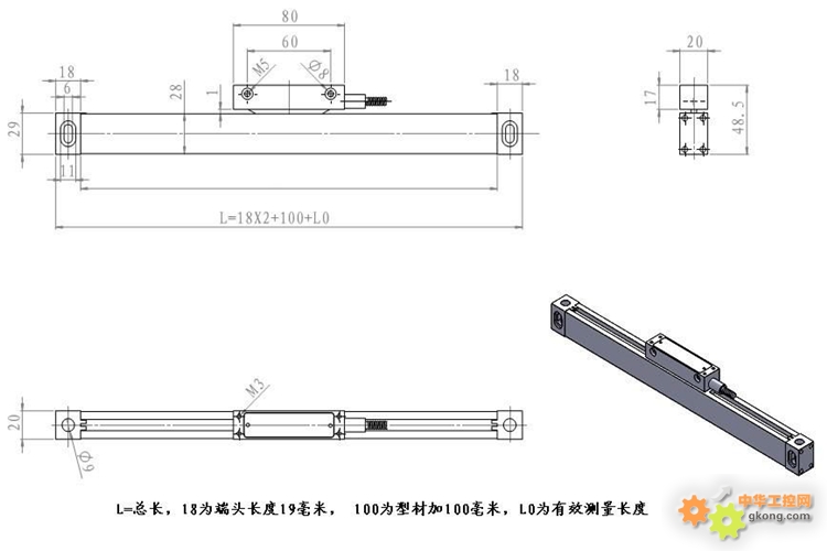

ÐÍ ºÅ£º SMW-GSC
SMW-GSC¹âÕ¤Î»ÒÆ´«¸ÐÆ÷£¨¹âÕ¤µç×ӳߣ©
²úÆ·ÌØµã£º
¹âÕ¤Î»ÒÆ´«¸ÐÆ÷(¹âÕ¤µç×ӳ߷ÖΪСÐÍ¡¢ÖÐÐÍ¡¢´óÐÍÈýÖÖÀàÐÍ¡£Ã¿Ò»Àà¾ù¿ÉÓÃ50 Ï߶ԵĹâÕ¤×÷Ϊ²âÁ¿»ù×¼£¬µ±ºÍÊýÏÔ±íÅäÌ×ʹÓÃʱ£¬ÐÔÄܿɿ¿£¬°²×°·½±ã¡£Ä¥²ÁС£¬ÁéÃô¶È¸ß£¬Ê¹ÓÃÊÙ
Ãü³¤¡£¿ÉÒÔÂú×ã¸÷ÖÖÖС¢Ð¡ÐÍ»ú´²ºÍÆäËü¾«ÃܲâÁ¿µÄÏßÎ»ÒÆÊý×ÖÏÔʾϵͳ¡£
¹âÕ¤³ß²ÎÊý£º
²úÆ·Ãû³Æ
ÐͺÅ
SMW-GSC-S£¨Ð¡ÐÍ£©
SMW-GSC-M(ÖÐÐÍ£©
SMW-GSC-L£¨´óÐÍ£©
²âÁ¿ÐгÌ
£¨10-500mm£©Ö®¼äÁ¿³ÌÈÎÒâ¿ÉÑ¡
£¨50-1200mm£©Ö®¼äÁ¿³ÌÈÎÒâ¿ÉÑ¡
£¨1300-3000mm£©Ö®¼äÁ¿³ÌÈÎÒâ¿ÉÑ¡
Ó¦ÓÃÔ­Àí
͸ÉäʽºìÍâÏß¹âѧ²âÁ¿ÏµÍ³
¶ÁÊýͷϵͳ
´¹Ö±Ê½ÎåÖá³Ðϵͳ
·Ö±æÂÊ
0.5um¡¢1um ¡¢5um
ÁãµãλÖÃ
ÎÞÁãλ£¨Ä¬ÈÏ£©¡¢ÔÚÖм䣬ÔÚ×ó±ß£¬ÔÚÓÒ±ß
×î´óÒÆ¶¯ËÙ¶È
60m/min
¹¤×÷ζÈ
ζÈ0-50¡æ ʪ¶È≤90(20±5°)
¹¤×÷µçѹ
5V±5%DC 24V±5%DC£¨PLC רÓã©
Êä³öÐźÅ
TTL ·½²¨ELA-422A
±êÅäÏß³¤
2 Ã×
¹âÕ¤³ßÖ÷ÒªÓ¦ÓÃ:
1¡¢¸÷Àà²âÁ¿»ú¹¹¡¢ÒÇÆ÷µÄÎ»ÒÆ²âÁ¿£ºµ¯»ÉÊÔÑé»ú¡¢Èý×ø±ê»ú¡¢Í¶Ó°ÒÇ
2¡¢¸÷Àà»ú´²µÄÊýÏÔϵͳ£º³µ´²¡¢Ï³´²¡¢Ä¥´²¡¢ïÛ´²¡¢µç»ð»¨¡¢¾«ÃÜÒÇÆ÷µÈ
3¡¢¸÷ÀàÊý¿Ø»ú´²µÄÅäÌ×ʹÓãºÊý¿ØÏ³¡¢¼Ó¹¤ÖÐÐÄ¡¢Êý¿ØÄ¥µÈ
4¡¢Åä½ÓPLC,ÓÃÓÚ¸÷Àà×Ô¶¯»¯»ú¹¹µÄÎ»ÒÆ²âÁ¿.
²úÆ·ÌØµã£º
1¡¢×îÏȽøµÄ¹âѧ²âÁ¿ÏµÍ³£¬²ÉÓÿɿ¿ÄÍÓõĸ߾«¶ÈÎåÖá³ÐϵͳÉè¼Æ£¬ ±£Ö¤¹âѧ»úеϵͳµÄÎȶ¨ÐÔ£¬ÓÅÒìµÄÖØ¸´¶¨Î»ÐԺ͸ߵȼ¶²âÁ¿¾«¶È¡£
2¡¢´«¸ÐÆ÷²ÉÓÃÃÜ·âʽ½á¹¹£¬ÐÔÄܿɿ¿£¬°²×°·½±ã¡£
3¡¢²ÉÓÃÌØÊâµÄÄÍÓÍ¡¢ÄÍÊ´¡¢¸ßµ¯ÐÔ¼°¿¹ÀÏ»¯Ëܽº·ÀË®£¬·À³¾ÓÅÒ죬ʹÓÃÊÙÃü³¤¡£
4¡¢¾ßÌå¸ßˮƽµÄ¿¹¸ÉÈÅÄÜÁ¦£¬Îȶ¨¿É¿¿¡£
5¡¢¹âÔ´²ÉÓýø¿ÚºìÍâ·¢¹â¶þ¼«¹Ü£¬Ìå»ýСÊÙÃü³¤¡£
6¡¢ÐźÅÏß²ÉÓöà²ã¸ôÀëÏßÍø¼°½ðÊôÈí¹Ü±£»¤£¬·ÀË®¼°¿¹¸ÉÈÅÐÔÄÜÓÅÁ¼
7¡¢²ÉÓÃÏȽøµÄ¹âÕ¤ÖÆ×÷¼¼Êõ£¬ÄÜÖÆ×÷¸÷¹æ¸ñµÄ¸ß¾«¶È¹âÕ¤²£Á§³ß¡£
