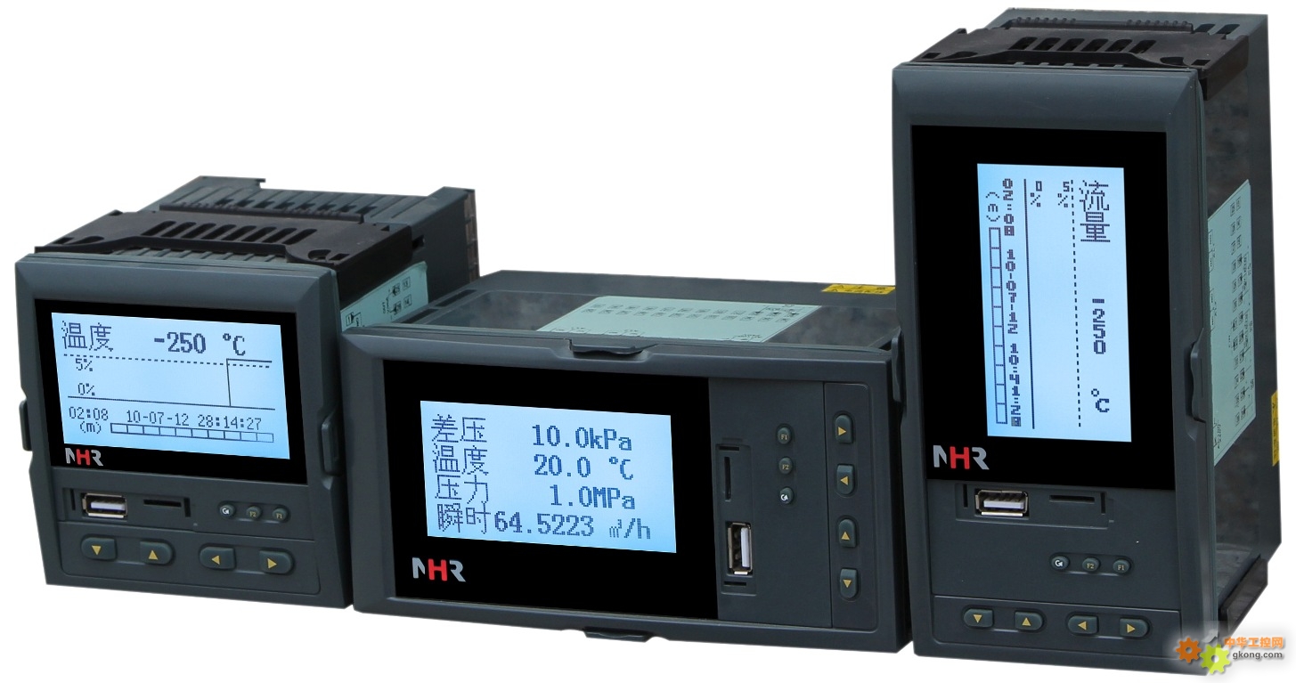

 ºçÈóNHR-7600/7600RϵÁÐÒº¾§Á÷Á¿(ÈÈÄÜ)»ýËã¿ØÖÆÒÇ/¼Ç¼ÒǶÔÏÖ³¡Î¶ȡ¢Ñ¹Á¦¡¢Á÷Á¿ µÈ¸÷ÖÖÐźŽøÐвɼ¯¡¢ÏÔʾ¡¢¿ØÖÆ¡¢Ô¶´«¡¢Í¨Ñ¶¡¢´òÓ¡µÈ´¦Àí£¬¹¹³ÉÊý×ֲɼ¯ÏµÍ³¼°¿ØÖÆÏµÍ³£¬ÊʺÏÓÚ¶ÔÆøÌå¡¢ÒºÌåºÍÕôÆûÁ÷Á¿½øÐйý³Ì¼à²â£¬×ÜÁ¿ÀÛ»ý¼°¶¨Á¿¿Ø ÖÆ£¬Í¬Ê±¿ÉÓëV×¶µÈ¶àÖÖÁ÷Á¿´«¸ÐÆ÷ÅäÌ×ʹÓ㻿É×Ô¶¯ÅжϹýÈÈÕôÆûÏò±¥ºÍÕôÆûת»»²¢ÊµÏÖÕôÆûÈÈÄܲâÁ¿ºÍÀÛ»ý¡£
¼ôÍ·2.gifÍòÄÜÐźÅÊäÈ룬¿ÉÊäÈëÖ±Á÷µçÁ÷¡¢Ö±Á÷µçѹ¡¢ºÁ·ü¡¢Èȵç×è¡¢Èȵçż¡¢ÆµÂʵÈÐźţ»0.2¼¶²âÁ¿¾«¶È¡£
1415955134947645.gifÒDZí¾ßÓÐóÒ×½áË㹦ÄÜ£¬¿ÉÉèÖÃСÁ÷Á¿²¹×㡢ͣµç²¹×ã¡¢ÐźŶÏÏß²¹³¥¹¦ÄÜ¡¢±¨±í¹¦ÄÜ¡¢Í£µç/Éϵç¼Ç¼¹¦ÄÜ¡¢±¨±í¹¦ÄÜ¡¢×ܵôµçʱ¼äºÍ×ܵôµç´ÎÊý¼Ç¼¹¦ÄÜ£¬Í¬Ê±¾ßÓÐÁ¼ºÃµÄ“·ÀµÁ”¹¦ÄÜ¡£
1415955134947645.gifÄÚÖöàÖÖÁ÷Á¿»ýË㹫ʽ£¬ÊÊÓ¦¸÷²âÁ¿³¡ºÏ£¬¾ß±¸Á÷Á¿ÏµÊýK×Ô¶¯ÑÝË㹦ÄÜ¡£
1415955134947645.gif¿É¶Ô²âÁ¿½éÖʽøÐж¨Á¿¿ØÖÆ£¬´øÊÖ/×Ô¶¯Æô¶¯¡¢Í£Ö¹¡¢ÇåÁ㹦ÄÜ¡£
1415955134947645.gifÖ§³ÖRS485¡¢RS232´®Ðнӿڣ¬²ÉÓñê×¼MODBUS RTUͨѶЭÒé¡£
1415955134947645.gifÖ§³ÖRS232C´òÓ¡¹¦ÄÜ£¬¾ßÓÐÊÖ¶¯´òÓ¡¡¢¶¨Ê±´òÓ¡¹¦ÄÜ¡£
1415955134947645.gif´øDC24VÀ¡µçÊä³ö£¬ÎªÏÖ³¡±äËÍÆ÷Åäµç¡£
1415955134947645.gif´øUSBÊý¾Ýת´æ¹¦ÄܺÍSD¿¨À©Õ¹¹¦ÄÜ¡£
1415955134947645.gifÊäÈë¡¢Êä³ö¡¢µçÔ´¡¢Í¨Ñ¶Ï໥֮¼ä²ÉÓùâµç¸ôÀë¼¼Êõ¡£
