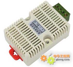

²úÆ·Ãû³Æ£º HONSOR»ú·¿¾­¼ÃÐÍÎÂʪ¶È´«¸ÐÆ÷
ÐÍ ºÅ£º H-THS2RS485
Ò»¡¢²úÆ·¸ÅÊö
   H-THS2RS485ÊÇÒ»¿î¸ß¾«¶È¾­¼ÃÐÍÎÂʪ¶È±äËÍÆ÷£¬ÍâÐÎÃÀ¹ÛСÇÉ£¬±ê×¼µ¼¹ì½á¹¹Éè¼Æ£¬½ÓÏß¼òµ¥£¬±ãÒ×°²×°¡£Ê¹Óýø¿Ú¸ß¾«¶È̽ͷ£¬±£Ö¤Á˲úÆ·µÄÓÅÒì²âÁ¿ÐÔÄÜ¡£³¬Ç¿Îȶ¨ÐԺͿ¹¸ÉÈÅÄÜÁ¦£¬²úÆ··À»¤ÐÔÄÜÇ¿£¬Ò»¼¶·ÀÀ×±£»¤¡£RS485½Ó¿Ú£¬¿ÉÒÔ¶à¸öÄ£¿é¹²Í¬½ÓÈë×ÜÏß×éÍø£¬ÊµÊ±¼à¿Ø¶à¸öÏÖ³¡µÄ»·¾³¡£
¶þ¡¢Ó¦Ó÷¶Î§
  ¹ã·ºÓ¦ÓÃÓÚͨѶ»ú·¿¡¢ÖÇÄÜÂ¥Óî¡¢³§·¿³µ¼ä¡¢²Ö¿â¡¢Ò©¿â¡¢Í¼Êé¹Ý¡¢²©Îï¹Ý¡¢ÊµÑéÊÒ¡¢°ì¹«ÊÒ¡¢Í¨·ç¹ÜµÀ¡¢´óÅïµÈ³¡Ëù¡£
Èý¡¢²úÆ·ÌØµã
1.RS485½Ó¿Ú£¬Í¨ÐžàÀë¿É´ï1200Ãס£
2.½ø¿Ú̽ͷ£¬¾«¶È¸ß£¬·¶Î§¿í£¬Ò»ÖÂÐԺá£
3.±ê×¼µ¼¹ì½á¹¹Éè¼Æ£¬Ò×ÓÚ°²×°¡£
4.³¬Ç¿Îȶ¨ÐԺͿ¹¸ÉÈÅÄÜÁ¦¡£
5.¿íµçѹÊäÈ룬DC9-30V¡£
6.±ê×¼MODBUS RTUЭÒé¡£
7.²úÆ··À»¤ÐÔÄÜÇ¿£¬Ò»¼¶·ÀÀ×±£»¤¡£
ËÄ¡¢Ö÷Òª¼¼Êõ²ÎÊý
¶î¶¨µçѹ£ºDC9V~DC30V £¨ÍƼö12V£©
²âÁ¿·¶Î§£ºÎ¶ȣº-20¡æ~70¡æ
ʪ¶È·¶Î§£º0¡«100%rh
²âÁ¿¾«¶È£ºÎ¶ȣº±0.5¡æ ·Ö±æÂÊ0.1¡æ
ʪ¶È¾«¶È£º±3%rh  ·Ö±æÂÊ0.1 rh
Êä³ö½Ó¿Ú£ºRS485
ͨѶЭÒ飺MODBUS RTU
ͨѶµØÖ·£º1-247,
²¨ÌØÂÊ£º 9600
ƽ¾ù¹¦ºÄ£º£¼0.1W
°²×°·½Ê½£ºµ¼¹ì°²×°£¬ÊÒÄÚÇ½Ãæ°²×°£¬Ì컨°å°²×°
²úÆ·³ß´ç£º65*46*29mm
