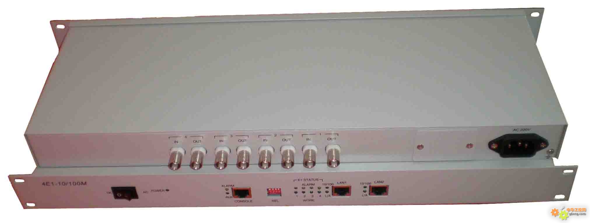

²úÆ·Ãû³Æ£º 4E1 ÒÔÌ«Íø´«ÊäÉ豸
ÐÍ ºÅ£º DA-2004/RACK
    DA-2004ת»»Æ÷ ¿É½«1-4·E1 (2048Kb/s)½¨Á¢ÐŵÀ£¬²¢Í¨¹ýרÓü¯³ÉоƬ×齫ÒÔÌ«Êý¾ÝÔÚÕâÒ»ÐŵÀÄÚ½øÐд«Ê䣬´Ó¶øÀûÓÃÒÑÓеÄE1´«ÊäͨµÀ£¬ÊµÏÖÊý¾ÝµÄ¿í´ø´«Ê䡣ϵͳͨ¹ý±¾ÉíËù´øµÄ¹ÜÀí½Ó¿ÚʵÏÖ¹¦ÄܵÄÁé»îÅäÖã¬Âú×ãÓû§¶ÔÍøÂçµÄ²»Í¬ÐèÇóºÍÒªÇó¡£
Ö÷ÒªÌØµã
  • ²ÉÓôó¹æÄ£Ð¾Æ¬£¬µç·¼òµ¥£¬¹¦ºÄµÍ£¬¿É¿¿ÐԸߣ»
  • É豸¾ùÌṩ1-4·E1ÅäÖã¬E1½Ó¿Ú×迹֧³Ö75ΩºÍ120Ω£¬ ÆäÖÐFE1-10/100M¡¢KFE1-10/100M¡¢FE1-10/100M 4¡¢KFE1-10/100M 4Ö§³Ön×64K£¨n = 1~31£©³É֡ģʽE1£»
  • 1/2/4E1-10/100MÌṩ1-2¸ö10/100 Base-Tx¶Ë¿Ú£»
  • 1/2/4E1-10/100M 4Ìṩ4¸ö10/100 Base-Tx¶Ë¿Ú£¬ 4¸öÒÔÌ«¿Ú¿É½øÐб¾µØ½»»»ºÍͨµÀ¸ôÀ룻
  • 10/100 Base-Tx¶Ë¿Ú¾ùÖ§³Ö10/100M£¬È«Ë«¹¤¡¢°ëË«¹¤£¬²¢Ö§³Ö×Ô¶¯Ð­ÉÌ»úÖÆ£»
  • E1ͨµÀÖ§³ÖÄÚÖÃBERT£¨Bit Error Rate Test£©¹¦ÄÜ£»
  • ×Ô¶¯Ì½²âE1Ïß·»·»Ø£¬¸æ¾¯Ìáʾ²¢¹Ø±ÕÒÔÌ«½Ó¿Ú£¬±ÜÃâÓ°ÏìÏÂÓÎÒµÎñ£»
  • Ö§³Ö802.1pÓÅÏȼ¶¹¦ÄÜ£»
  • Ö§³Ö»ùÓÚ802.3xµÄÁ÷Á¿¿ØÖƹ¦ÄÜ£»
  • Ö§³ÖVLANÒÔ̫֡͸Ã÷´«Ê䣻
  • Ìṩ1¸ö¹ÜÀí½Ó¿Ú£¬¿ÉÒÔÁé»îÉèÖÃÉ豸µÄ¹¦ÄÜ£»
  • Ìṩ1×é¿ØÖÆ¿ª¹Ø£¬ÓÃÓÚÉèÖÃÉ豸ά»¤²âÊÔ£»
  • ÊÊÓ¦¶àÖÖµçÔ´»·¾³£¬+24VDC¡¢-24VDC¡¢±24VDC¡¢-48VDC»ò220VAC¡£
