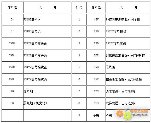

²úÆ·ÍâÐμ°¶Ë×ÓÐźŶ¨Ò壺
RS485/422½ÓÏß¶Ë×ÓÐźŶ¨Òå

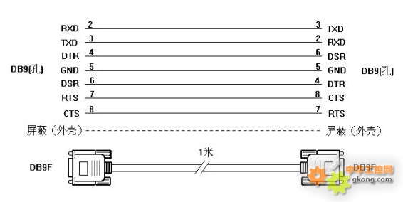

FS-485CÓëÉ豸µÄRS232¿ÚµÄÁ¬½Ó£º
FS-485C¿ÉÁ¬½ÓÈκÎRS232´®¿Ú£¬±¾²úÆ·µÄRS232²å×ùÊǰ´±ê×¼µÄDTE½Ó¿Ú¶¨ÒåµÄ£¬Á¬½Ó±ê×¼DCE½Ó¿Ú¿ÉÓÃֱͨµçÀÂÁ¬½Ó£¬Á¬½ÓÏóµçÄÔÕâÑùµÄDTE½Ó¿ÚÐè×öÒ»Ìõ½»²æµçÀ£¬ÈçÏÂͼËùʾ£¬Ëæ²úÆ·ÒÑÅäÓиõçÀ¡£¶ÔÓÚÆäËüδ°´±ê×¼ÐźÅÅÅÁеÄRS232¿Ú£¬Óû§°´ÕÕ"·¢ËÍÁ¬½ÓÊÕ£¬½ÓÊÕÁ¬·¢ËÍ"µÄÔ­ÔòÁ¬½Ó¼´¿É¡£

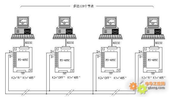

1¡¢¶þÏß°ëË«¹¤RS485ͨÐÅÍøÂ磺
½«FS-485Cת»»Æ÷ÉϵÄRS485ºÍRS422Ñ¡Ôñ¿ª¹ØK1²¦µ½"485"£¬½«ÍøÂçµÄʼ¶ËºÍÖն˵ÄFS-485CÉϵÄÖն˵ç×èÉèÖÿª¹ØK2²¦µ½"R"£¬ÍøÂçÉÏµÄÆäËüFS-485CÉϵÄÖն˵ç×èÉèÖÿª¹ØK2²¦µ½"OFF"¡£

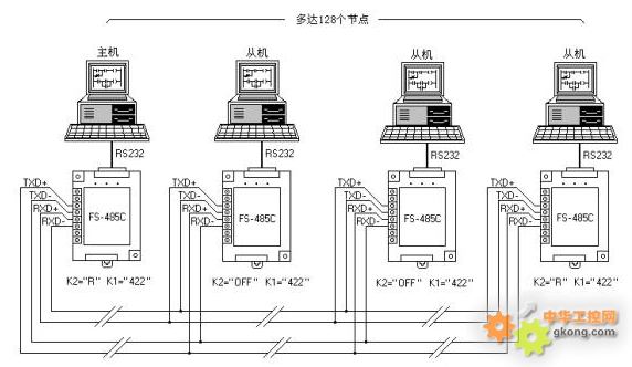

2¡¢ËÄÏßȫ˫¹¤RS422ͨÐÅÍøÂç
½«FS-485Cת»»Æ÷ÉϵÄRS485ºÍRS422Ñ¡Ôñ¿ª¹ØK1²¦µ½"422"£¬½«ÍøÂçµÄʼ¶ËºÍÖն˵ÄFS-485CÉϵÄÖն˵ç×èÉèÖÿª¹ØK2²¦µ½"R"£¬ÍøÂçÉÏµÄÆäËüFS-485CÉϵÄÖն˵ç×èÉèÖÿª¹ØK2²¦µ½"OFF"¡£
