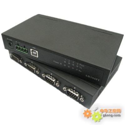

²úÆ·Ãû³Æ£º USBËÄ´®¿ÚRS232/485/422ת»»Æ÷
ÐÍ ºÅ£º AR104FI
²úÆ·ÌØµã
  • AR104F/AR104FIËĸö´®¿Ú¿É·Ö±ðÉèÖóɣºÈ«Ë«¹¤232¡¢È«Ë«¹¤422¡¢È«Ë«¹¤485¡¢°ëË«¹¤485£»
  • Ö§³ÖUSB 2.0£¬×î¸ßËÙÂʿɴï480 Mbps£»
  • ´®¿ÚͨÐÅËÙÂʿɴï460.8 Kbps£»
  • ÿ¸ö¶Ë¿Ú128×ֽڵĽÓÊÕ»º³åÇøºÍ128×ֽڵķ¢ËÍ»º³åÇø£»
  • ÄÚ½¨ESD±£»¤,2 KV µç´Å¸ôÀë±£»¤(½öAR104FI)£»
  • COM¿Ú¼ÇÒ书ÄÜ£¬·½±ãά»¤Ö÷»úCOM¿ÚÁÐ±í£»
  • ÿ¶Ë¿ÚTX / RXָʾµÆ£»
  • ×Ô¶¯Ê¹ÄÜ¿ØÖÆRS485Ë«ÏòÊý¾Ý£»
  • USB´óÈÝÁ¿Êý¾Ý´«Êäģʽ£¨512¸ö×Ö½ÚµÄÊý¾Ý°ü£¬ÔÚ¸ßËÙģʽÏ£©£»
  • Ö§³Ö×ÜÏߺÍÍâ½ÓµçÔ´¹©µç¹¤×÷µçÔ´£º£«9V¡«24V DC£»¿É¸ù¾ÝÐèÇóÌṩ5V½Ó¿Ú£»
  • °²×°·½Ê½£º¿ÉÑ¡±ê×¼DIN µ¼¹ì°²×°»ò¼òµ¥¹Ì¶¨·½Ê½£»
  • ²úÆ·³ß´ç£º170×95×30 mm¡£
1.3¡¡¹æ¸ñ
  • ͨÐÅËÙÂÊ£º¸ßËÙ480 Mbps£¬È«ËÙ12 Mbps
  • Ö§³ÖUSB 1.1£¬2.0
  • Á¬½ÓÆ÷£ºUSB BÐÍ
  • Ðźţº
    • RS-232£ºTxD£¬RxD£¬RTS£¬CTS£¬DTR£¬DSR£¬DCD£¬GND
    • RS-422£ºTxD+(A)£¬TxD-(B)£¬RxD+(A)£¬RxD-(B)£¬GND
    • 4ÏßRS-485£ºTxD+(A)£¬TxD-(B)£¬RxD+(A)£¬RxD-(B)£¬GND
    • 2ÏßRS-485£ºData+(A)£¬Data-(B)£¬GND
  • Á¬½ÓÆ÷£ºÕëʽDB9
  • FIFO£º128 byte
  • ²¨ÌØÂÊ£º50 bps ~ 460.8Kbps
  • Êý¾Ýλ£º7£¬8
  • ֹͣλ£º1£¬2
  • I/OµØÖ·/IRQ£ºBIOS·ÖÅä
  • УÑéλ£ºNone£¬Even£¬Odd£¬Space£¬Mark
  • Á÷¿Ø£ºRTS/CTS£¬XON/XOFF
  • Ö§³ÖÒÔϲÙ×÷ϵͳ£º
    • Windows 2000, Server 2003, Server 2008
    • Windows XP and XP 64-bit
    • Windows Vista and Vista 64-bit
    • Windows XP Embedded
    • Windows CE 4.2, 5.0, 5.2 and 6.0
    • Mac OS-X
    • Windows 7 and Windows 7 64-bit
    • Windows 8.1 and Windows 8.1 64-bit
  • µçÔ´ºÍ»·¾³£º
  • AR 104F-232: 100mA(max) @ 5 VDC×ÜÏßµçÔ´
  • AR 104F: 300mA(max) @ 9-24VDCÍâ½ÓµçÔ´
  • AR 104FI: 460mA(max) @ 9-24 VDCÍâ½ÓµçÔ´
  • ¹¤×÷ζȣº-40 ~ 85 °C
  • ¹¤×÷ʪ¶È£º5 ~ 95% RH
  • ´æ´¢Î¶ȣº-40 ~ 85 °C
