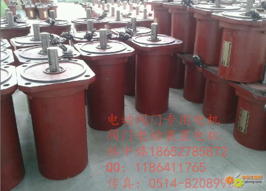

ÑïÖÝÊи£ÀÖ˹·§ÃÅ¿ØÖÆÓÐÓÐÏÞ¹«Ë¾YDF-WF-321-4·§ÃÅÈýÏàÒì²½µç»úÊǰ´ÕÕÖлªÈËÃñ¹²ºÍ¹ú»úеÐÐÒµ±ê×¼JB/T 2195-1998YDFϵÁз§Ãŵ綯װÖÃÓÃÈýÏàÒì²½µç»ú¼¼ÊõÌõ¼þÑϸñÉú²úµÄ£¬µç»ú¶î¶¨¹¦ÂÊΪ2.2KW£¬¶î¶¨ÆµÂÊΪ50HZ£¬¶î¶¨µçѹΪ380V£¬¶î¶¨×ªËÙΪ1440r/min£¬µç»ú²ÉÓÃF¼¶¾øÔµ¡£
YDF·§Ãŵ綯װÖÃרÓõç»úÖ÷ÒªÐͺÅÓУº
YDF-WF-111-4£¬YDF-WF-112-4£¬YDF-WF-121-4£¬YDF-WF-211-4£¬YDF-WF-212-4£¬YDF-WF-221-4£¬YDF-WF-222-4£¬YDF-WF-231-4£¬YDF-WF-311-4£¬YDF-WF-312-4£¬YDF-WF-321-4£¬YDF-WF-322-4£¬YDF-WF-411-4£¬YDF-WF-412-4£¬YDF-WF-422-4µÈ¸÷ÖÖÐͺŵç»ú¡£
ÓÐ0.06KW£¬0.09KW£¬0.12KW£¬0.18KW£¬0.25KW£¬0.37KW£¬0.55KW£¬0.75KW£¬1.1KW£¬1.5KW£¬2.2KW£¬3KW£¬4KW£¬5.5KW£¬7.5KW£¬11KW£¬15KWµÈ¸÷ÖÖ¹¦Âʵç»ú¡£
·§Ãŵ綯װÖõç»úYDFϵÁÐÈýÏàÒì²½µç¶¯»úÊǸ£ÀÖ˹¸Ä½øÉè¼Æ¿ª·¢µÄ²úÆ·£¬ÆäŤ¾Ø¡¢ÔëÉù¡¢Õñ¶¯¡¢ÎÂÉýµÈÖ¸±êÍêÈ«´ïµ½Éè¼ÆÒªÇó£¬Ö÷ÒªÐÔÄÜÖ¸±ê´ïµ½¹ú¼ÊÏȽøË®Æ½¡£YDFϵÁÐÊÊÓÃÓڷDZ¬Õ¨Î£ÏÕ³¡Ëù£¬±¾ÏµÁе綯»ú°´ÏÂÁй¦ÂÊÖÆÔ죺0.01¡¢0.015¡¢0.025¡¢0.04¡¢0.06¡¢0.09¡¢0.12¡¢0.18¡¢0.2¡¢0.25¡¢0.37¡¢0.55¡¢0.75¡¢1.1¡¢1.5¡¢2.2¡¢3¡¢4¡¢5.5¡¢7.5¡¢11 KW£¬ÆäÖÐ0.18KWÒÔϲÉÓÃÂÁÖÆ»ú×ù£¬0.18 KW¼°ÒÔÉϲÉÓÃÖýÌú»ú×ù¡£
