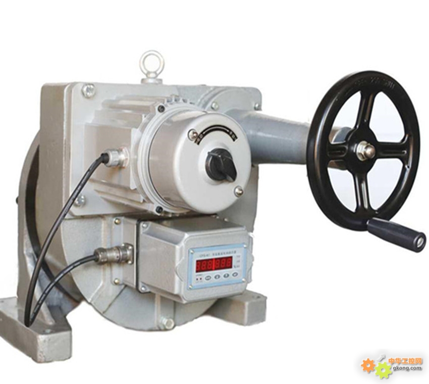

²úÆ·Ãû³Æ£º dkj-5100°ÙÒ¶´°µ²°åÃÅÖ´Ðлú¹¹
ÐÍ ºÅ£º DKJ-5100
ZKJ/SKJ/DKJ-5100M/B/D/ZÐͽÇÐг̵綯ִÐлú¹¹£¬
µçÔ´µçѹ£º220V£¨380V£©
Á¬½Ó·½Ê½£ºÖ±Á¬Ê½ µ××ùʽ
¿ØÖÆ·½Ê½£ºÊÖ¶¯£¨ÊÖÂÖ¿ØÖÆ£©¡¢µç¶¯£¨¿ª¹ØÁ¿¿ØÖÆ£©
ÊäÈëÐźţºÄ£ÄâÁ¿»ò¿ª¹ØÁ¿ÐźÅ
Êä³öÐźţº4-20mA
  ¸£ÀÖË¹ÅÆDKJÐ͵綯ִÐлú¹¹£¬ÊÇDDZÐ͵綯µ¥Ôª×éºÏÒDZíÖеÄÖ´Ðе¥Ôª£¬Ëü½ÓÊÜÉÏλÒDZíµÄ¿ØÖÆÐźţ¬×Ô¶¯µØ²Ù×ÝÖ´Ðлú¹¹Íê³Éµ÷½ÚÈÎÎñ£¬¹ã·ºµØÓÃÓÚµçÕ¾¡¢»¯¹¤¡¢Ê¯ÓÍ¡¢Ò±½ð¡¢½¨²Ä¡¢Ë®´¦Àí¡¢¹©ÈÈ¡¢ÇṤµÈÐÐÒµ¡£
ÐͺŹæ¸ñ£ºDKJ-5100   ³öÖáÁ¦¾Ø£º1600N.£í   ÏûºÄ¹¦ÂÊ£º180W   ÖØÁ¿£º145KG
DKJ-5100ÐÍÖ÷Òª¼¼ÊõÖ¸±ê£¨ÓëDFCËÅ·þ·Å´óÆ÷ÅäºÏ£©
1¡¢ÊäÈëÐźţº¢òÐÍ0-10mA,DC;¢óÐÍ4-20mA,DC
2¡¢ÊäÈëͨµÀ£ºÈý¸ö
3¡¢ÊäÈëͨµÀ×迹£º¢òÐÍ200Ω£»¢óÐÍ250Ω
4¡¢Êä³öÍÆÁ¦£º¼û±í
5¡¢È«ÐгÌʱ¼ä£º¼û±í
6¡¢»ù±¾Îó²îÏÞ£º±2.5%
7¡¢ËÀÇø£º≤3%
8¡¢×èÄáÌØÐÔ£º≤3Èý´Î°ëÖÜÆÚ
9¡¢»Ø²î£º1.5%
10¡¢µçÔ´µçѹ£º220V(+10%,-15%) ÆµÂÊ50Hz
11¡¢Ê¹Óû·¾³Î¶ȣºÖ´Ðлú¹¹£º-10¡«+55¡æ»ò-25¡«+70¡æ£»·Å´óÆ÷£º0¡«+50¡æ
12¡¢Ê¹Óû·¾³Ïà¶Ôʪ¶È£ºÖ´Ðлú¹¹£º≤95%£»·Å´óÆ÷£º10%¡«70%
ÑïÖݸ£ÀÖ˹·§ÃÅ¿ØÖÆÓÐÏÞ¹«Ë¾Éú²úµÄÖ´Ðлú¹¹Î»Ö÷¢ËÍÆ÷¾ù²ÉÓÃ×îеĴ«¸ÐÔª¼þ£¬²Î¿¼¹úÍ⹫˾µÄ×îеç·,¼¯µçÔ´±äѹÆ÷£¬ÕûÁ÷¡¢ÎÈѹ¡¢¹¦·Å¡¢ºãÁ÷ÓÚÒ»Ì壬֯³ÉÄ£¿é£¨M£©Ê¹Ö´Ðлú¹¹µÄ¿É¿¿ÐÔ¡¢Îȶ¨ÐÔ¸ü¸ß£¬´Ó¶øÊ¹ÏµÍ³¸ü¼Ó°²È«¿É¿¿¡£
