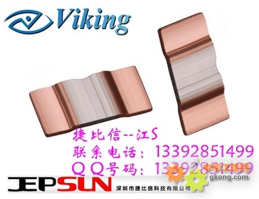

²úÆ·Ãû³Æ£º ¹âò¡´ó¹¦ÂÊ·ÖÁ÷оƬµç×èLRSϵÁÐ
ÐÍ ºÅ£º 10.5*5.0mm 1% TCR100 4W 2m¦¸
¹âò¡´ó¹¦ÂÊ·ÖÁ÷оƬµç×èLRSϵÁÐÓ¦ÓÃÁìÓò£º¸÷Ààµç×Ó²úÆ·¡¢µçÁ¦É豸¡¢Á¿²âÉ豸¡¢Æû³µÏà¹Ø¿ØÖư塢ÊÖ»ú¡¢ÊÖÌáµçÄÔ¡¢Ö÷»ú°å¡¢¼ÆËã»úÖܱ߿ØÖư塢µçԴת»»Æ÷¡¢¸÷Àà³äµçÆ÷¿ØÖư塢µçÔ´¹©Ó¦Æ÷¡¢µç¶¯³µÈ¼ÁÏµç³ØµÈ¡£
¹âò¡´ó¹¦ÂÊ·ÖÁ÷оƬµç×èLRSϵÁÐÏêϸ²ÎÊý£º
×èÖµ·¶Î§£º4mΩ¡¢3mΩ¡¢2mΩ¡¢1mΩ¡¢0.5mΩ¡¢0.2mΩ
·â×°£º1050£¨10.5*50mm£©¡¢1575£¨15.2*7.5mm£©
ÎÂÆ¯ÏµÊý£º±120PPM/¡æ¡¢±120PPM/¡æ¡¢±75PPM/¡æ¡¢±60PPM/¡æ¡¢±50PPM/¡æ
¾«¶È£º±5£¥¡¢±2£¥¡¢ ±1£¥
¹¦ÂÊ·¶Î§£º7W ¡¢6W¡¢5W¡¢4W¡¢3.5W¡¢3W¡¢2.5W
×îС°ü×°£º2K/1575·â×°¡¢3K/1050·â×°
¹âò¡´ó¹¦ÂÊ·ÖÁ÷оƬµç×èLRSϵÁвúÆ·ÌØÐÔ£º
Í­½ÓÍ·
¾ßÓм«ºÃµÄ³¤ÆÚÎȶ¨ÐԺ͵͸ÐÓ¦Öµ
¿É°²×°Ê¹ÓÃÔÙ»ØÁ÷º¸½Ó»òÍ­º¸ÉÏ
LRS 1050 5W£¬¸ß´ï100AÔÚ0.5mΩ
LRS 1575 7W£¬¸ß´ï180AÔÚ0.2mΩ
×î´óº¸½Óζȸߴï350°C /30Ãë»ò250¡æ/10·ÖÖÓ
ÏÖÓÐÑùÆ·²ÎÊý£º1050 1% TCR60 4W 1ºÁÅ·¡¢1050 1% TCR100 2.5W 4ºÁÅ·¡¢1050 1% TCR60 4W 2ºÁÅ·¡¢1575 1% TCR120 4W 2ºÁÅ·µÈ£»Viking£ºÅ·ÖÞ±ê×¼¡¢ÊÀ½çÆ·ÅÆ¡¢»·±£ÈÏÖ¤£¡ÏêÇéÇëÖµçË÷È¡Ïêϸ²úÆ·¹æ¸ñÊ飬ÏÖÔÚÖµç¸üÓÐÃâ·ÑÑùÆ·ÉêÇ룡
