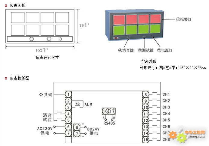

ÐÍ ºÅ£º NHR-5810A
ºçÈóÍÆ³ö°Ë·ÉÁ¹â±¨¾¯Æ÷£¬
  NHR-5810ϵÁаË·ÉÁ¹â±¨¾¯Æ÷ÊÇÒ»ÖÖ½ÓµãʽÉù¹â±¨¾¯ÏÔʾÒÇ±í£¬¾ßÓеç·¼òµ¥¡¢Ôª¼þÉÙ¡¢¿É¿¿ÐԸߡ¢¿¹¸ÉÈÅÄÜÁ¦Ç¿¡¢µÍ¹¦ºÄ¡¢µÍÔëÉù¡¢EMCµç´Å¼æÈݵÈÌØµã£¬¹ã·ºÔËÓÃÓÚµçÁ¦¡¢Ê¯»¯¡¢Ò±½ð¡¢ÇṤ¡¢ÖÆÒ©¡¢º½¿ÕµÈÖî¶àÁìÓò¡£
    ¡ï¿Éͬʱ¼ì²â°Ë·ÊäÈëÐźţ¬°Ë·Ðźžù²ÉÓøßÁÁ¶ÈÆ½Ãæ·¢¹â¹Ü£¬±¨¾¯Òǿɷ¢³öÉù¡¢¹â±¨¾¯Ðźţ¬²¢ÇÒ¿ÉÊä³ö±¨¾¯½ÓµãÐźÅ
    ¡ï¿ÉÑ¡Ôñ½Óµãʽ¿ªÂ·/±Õ·±¨¾¯»òTTLµçƽ
    ¡ï¿ÉÖ§³ÖRS485ͨѶ½Ó¿Ú£¬²ÉÓñê×¼MODBUS  RTUͨѶЭÒé
    ¡ï¾ßÓжàÖÖ±¨¾¯¿ØÖÆÊä³ö·½Ê½£¬¿É×ÔÓÉÑ¡ÔñÉÁ¹â±¨¾¯¡¢ÉùÒô±¨¾¯¡¢¼ÌµçÆ÷±¨¾¯´¥µã¿ØÖÆÊä³ö¼°´ø±¨¾¯¼ÇÒä»ò²»´ø±¨¾¯¼ÇÒ书ÄÜ¡£
 Ö÷Òª¼¼Êõ²ÎÊý
1. °Ëµã±¨¾¯ÐźÅÊäÈ룺TTLµçƽÐźŻòÕßÎÞÔ´½ÓµãÐźţ¨³£¿ª³£±Õ¿ÉÉèÖã©¡£
2.  Êä³öÐźţº°Ëµã·¢¹â±¨¾¯Ö¸Ê¾£¬¾ßÓÐÒôÏì½ÓµãÊä³ö±¨¾¯£¬ÒôÏ춯×÷Ϊ½Óµã±ÕºÏ¡£
3. Êä³ö¼ÌµçÆ÷½ÓµãÈÝÁ¿£ºAC 220V/3A£»DC 24V/2A¡£
4.  È·ÈÏ·½Ê½£ºÊÖ¶¯£¨ÒôÏ챨¾¯Ïû³ý£©¡£
5.  ¹¤×÷Ìõ¼þ£º
   a£©»·¾³Î¶ȣº0-50¡æ
   b£©Ïà¶Ôʪ¶È£º≤85£¥RH
   c£©ÖÜΧ¿ÕÆøÖв»Ó¦º¬Óи¯Ê´ÐÔÆøÌå¡£
6. ¹¤×÷µçÔ´£ºAC  100-240V(50/60HZ)£¬DC 24V(±10%)
7. ¹¦ºÄ£º≤3W
ÒDZíÑ¡ÐÍ
NHR-5810¡õ-¡õ-¡õ-¡õ
        ¢Ù ¢Ú ¢Û ¢Ü
¢ÙÉù¹â±¨¾¯·½Ê½ ¢ÚÊäÈëÀàÐÍ
´úÂë Éù¹â±¨¾¯·½Ê½ËµÃ÷ ´úÂë ÊäÈëÀàÐÍ˵Ã÷
A °Ë»ØÂ·¸ßÁÁ¶ÈLEDÆ½Ãæ°åÏÔʾ£¨µÆ¹âʽ£©
A
B
C
D
½Óµãʽ±Õ·±¨¾¯ÊäÈë
½Óµãʽ¿ªÂ·±¨¾¯ÊäÈë
±ê×¼TTLµçƽÊäÈë
ÌØÊâÒªÇó
¢ÛͨѶ·½Ê½ ¢Ü¹©µçµçÔ´
´úÂë ͨѶÊä³ö ´úÂë µçѹ·¶Î§
X
D1
ÎÞÊä³ö
RS485Êä³ö
A
D
AC 100-240V(50/60Hz)
DC 24V  (±10%)
±¸×¢£º
1¡¢ÌØÊâÐͺźÍÒªÇóµÄ£¬ÇëÌṩÏà¹Ø¼¼Êõ²ÎÊý£¬¶©»õʱÇë˵Ã÷¡£
2¡¢ÔÚдÐͺÅʱ±ØÐëÍêÕû£¬Ã»ÓÐÑ¡µ½µÄ¹¦ÄÜÏî²»ÄÜÊ¡ÂÔ£¬±ØÐëÓÓX”²¹ÉÏ¡£
Àý1£ºNHR-5810A-A-D1-A£»
Àý2£ºNHR-5810A-C-X-D¡£
