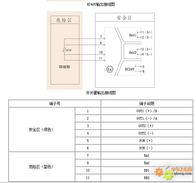

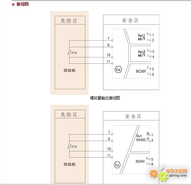

ºçÈóÍÆ³öËÄÏßÖÆÈȵç×èÊäÈë¼ì²â¶Ë¸ôÀëÕ¤£¬NHR-A32-4ϵÁÐËÄÏßÖÆÈȵç×èÊäÈë¼ì²â¶Ë¸ôÀëÕ¤£¬½«Î£ÏÕÇøµÄÈȵç×è²âÁ¿ÐźÅת»»³É¶ÔÓ¦µÄµçѹ¡¢µçÁ÷¡¢RS485ÐźŻò¿ª¹ØÁ¿ÐźŸôÀë´«Êäµ½°²È«Çø¡£¸Ã²úÆ·Ðè¶ÀÁ¢¹©µç£¬ÊäÈë/Êä³ö/µçÔ´Èý¸ôÀë¡£±¾²úÆ·¿ÉÓÃÔÚËÄÏßÖÆÈȵç×èÐźÅÊä³öÉ豸¡£

¶Ë×Ó 11-10-8-7
×î´óÔÊÐíµçѹ Um=250V
µçѹ Uo=7.71V
µçÁ÷ Io=297mA
¹¦ÂÊ Po=0.58W
µçÈÝ Co=9.3μF
µç¸Ð Lo=0.35mH
