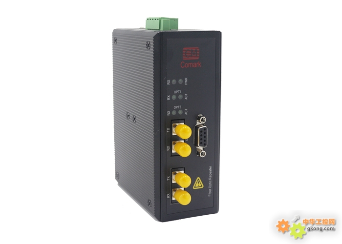

    profibus dp×ÜÏßÊý¾Ý¹â¶Ë»ú£¨Ci-PF110/120ϵÁУ©ÊµÏÖÁËPLCÖ÷Õ¾ÓëÔ¶³ÌÕ¾Ö®¼äprofibus dpÏÖ³¡×ÜÏߵĹâÏËÔ¶³Ì´«Êä¡£ÍêÈ«×ÔÖ÷֪ʶ²úȨ£¬¹úÄÚÊ×´´£¡²úÆ·ÒÑ»ñCE¡¢RoHSµÈ¸÷ÖÖÈÏÖ¤£¬³ö¿ÚÅ·ÃË¡¢Ó¡¶È¡¢É³ÌØ¡¢°ÍÎ÷µÈ¶à¸ö¹ú¼ÒºÍµØÇø¡£
ÐÔÄÜÌØµã
Ö§³ÖÂß¼­¶ÀÁ¢Ë«Profibus DP×ÜÏߣ¬Ö§³Ö±ê×¼¹æ·¶ÖеÄÈ«²¿Ô¤¶¨Í¨ÐÅËÙÂÊ
Ö§³Ö²¦Â뿪¹ØÉèÖÃÎªÌØ¶¨µÄͨÐÅËÙÂÊ»òÕßËÙÂÊ×ÔÊÊÓ¦
1~2·Profibus DPµç½Ó¿Ú¼°1~2·155Mbps¹âÏ˽ӿÚÁé»îÑ¡Ôñ£¬Ö§³ÖÈßÓàË«ÍøºÍ¹âÏË»·ÍøÍØÆË
³¤´ï20kmÒÔÉϵĹâÏËͨОàÀ룬155Mbps£¬¸ßËÙ¹â½Ó¿Ú¸üºÃÖ§³ÖÍ»·¢Êý¾ÝµÄ³¤¾àÀë¿É¿¿´«Êä
5¸ö˫ɫLED״ָ̬ʾµÆ£¬¹âÏËÁ´Â·ÒÔ¼°µçÔ´¹ÊÕϼ̵çÆ÷Êä³ö¸æ¾¯
µç½Ó¿Ú4000VµÄ·ÀÀ×£¬1.5A¹ýÁ÷£¬600WÀËÓ¿±£»¤£¬¹¤Òµ¼¶Éè¼Æ£¬EMC²âÊÔÈÏÖ¤
DC£¨12~36V£©¿íÈßÓàË«µçÔ´£¬·´½Ó±£»¤
IP30·À»¤µÈ¼¶£¬²¨ÀËÎÆÂÁÖÆ¼ÓÇ¿»ú¿Ç£¬²ÉÓñê×¼¹¤Òµ35mmµ¼¹ì°²×°·½Ê½
×ÜÏßÊý¾Ý½Ó¿Ú
9ÕëµÄSub_D²å¿×Á¬½ÓÆ÷£¬¹Ü½Å¶¨Òå·ûºÏProfibus DPµÄЭÒ鹿·¶
 Ö§³ÖProfibus DP×ÜÏß±ê×¼
ͨÐÅËÙÂÊ£º£¨ËÙÂÊ×ÔÊÊÓ¦£¬½¨ÒéÓɲ¦Â뿪¹ØÉèÖóÉÌØ¶¨µÄͨÐÅËÙÂÊ£©9.6Kbps¡¢19.2 Kbps¡¢45.45Kbps¡¢93.75Kbps¡¢187.5Kbps¡¢500Kbps¡¢1.5Mbps¡¢6Mbps ¡¢12Mbps
ÐźÅÑÓʱ£¨µç¿Ú£©£º≤11Bit
¾ß±¸4000VµÄ·ÀÀ×»÷ÒÔ¼°1.5AµÄ¹ýÁ÷±£»¤ºÍ600WÀËÓ¿±£»¤¹¦ÄÜ
Öն˵ç×裺±¾»ú²»´øÖն˵ç×裬Çë°´ÐèÒªÍâ½Ó
¹âÏ˽ӿڠ
¹âÏ˲¨³¤£º¶àÄ£850nm¡¢1310nm£»µ¥Ä£1310nm¡¢1550nm
´«Êä¹âÏË£º¶àÄ£50/125um¡¢62.5/125um¡¢100/140um£»µ¥Ä£8.3/125um¡¢9/125um¡¢10/125um
´«Êä¾àÀ룺¶àÄ£2km£¬µ¥Ä£20km£¬¸üÔ¶¾àÀë¿ÉÑ¡
¹âÏ˽ӿÚÀàÐÍ£ºSC¡¢FC¡¢ ST¿ÉÑ¡£¬±êÅäSC¹â½Ó¿Ú
¹âÏß·ÎóÂëÂÊ£º<10-9
ÐźÅÑÓʱ£¨¹â¿Ú£©£º≤2.3us/½Úµã
µçÔ´¼°±£»¤
µçÔ´£ºË«µçÔ´ÈßÓàÊäÈ룬DC£¨12-36V£©£¬µäÐÍDC24V£¬¹¦ºÄСÓÚ4W£¬¾ßÓз´½Ó±£»¤¹¦ÄÜ£¬¹¤Òµ¶Ë×Ó½Ó¿Ú
¼ÌµçÆ÷¸æ¾¯Êä³ö£º¹âÏËÁ´Â·¹ÊÕϸ澯Êä³ö£¬´¥µã×î´óÈÝÁ¿£ºDC48V/1A£¬¹¤Òµ¶Ë×Ó½Ó¿Ú
»úÐµÌØÐÔ
ÍâÐγߴ磺£¨136x106x54£©mm
Íâ¿Ç£ºIP30·À»¤µÈ¼¶£¬²¨ÀËÎÆÂÁÖÆ¼ÓÇ¿»ú¿Ç
°²×°·½Ê½£º35mmDINµ¼¹ì°²×°
¾»ÖØ£º800g
¹¤×÷»·¾³
¹¤×÷ζȣº£¨-10¡« 70£©¡æ£¬¿ÉÑ¡¿íΣ¨-40¡« 85£©¡æ
Ïà¶Ôʪ¶È£º≤90%£¨ÎÞÀäÄý£©
´æ·Åζȣº£¨-40¡« 85£©¡æ
ÈÏÖ¤
CEÈÏÖ¤: EN55022:2010(RE) Band:120KHz Frequency:30-1000MHz
              IEC61000-4-2:2001(ESD) Air: ±8KV Contact:±4KV Criterion:B Level 2
              IEC61000-4-3:2006(RS) 3V/m(80-1000MHz) Criterion:A Level 2
ROHSÈÏÖ¤: Test Standards:EN1122:2001,EPA3050B,EPA3052,EPA3540C,EPA3060A
              Testing Item:Pb Cd Hg Cr6  PBBs
              Test Results:N.D.
