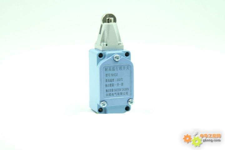

²úÆ·Ãû³Æ£º NHG2Ä͸ßÎÂÐг̿ª¹Ø
ÐÍ ºÅ£º NHG2
¸ÅÊö£º
NHG2Ϊ¶¥²¿¹öÂÖÖù×´£¬Í¨¹ýÅöײÉϲ¿µÄ¹öÂÖÖù£¬Ê¹¹öÂÖÖùÍùÏÂѹ£¬´Ó¶øÊ¹¿ª¹ØµÄ´¥µã¶¯×÷¶øÊµÏÖµç·Çл»¡£
¿ª¹ØÕûÌåÍⲿΪȫ½ðÊôÂÁºÏ½ð²ÄÖÊ,ËüµÄ¿ª¹ØÄÚ²¿²ÉÓÃÄ͸ßβÄÁϽ½Öý³ÉµÄÈ«·â±Õ´¥µã¿ª¹Ø£¬Ò»×é³£¿ªÒ»×é³£±Õ×î´óÔÊÐíµçÁ÷5A/AC 220V£¨ÆäËûµçѹ½ÓÊÜÔ¤¶¨£©£¬´¥µã¾­¹ýÌØÊâ´¦Àíºó¿ÉÔÚ¸ßλ·¾³Ï³¤Ê±¼äʹÓöø²»±»Ñõ»¯»òÎÛȾ¶øµ¼ÖÂË𻵡£
±¾²úÆ·¹ã·ºÊ¹ÓÃÓÚµçÁ¦¡¢»¯¹¤¡¢Ê¯ÓÍ¡¢·ÄÖ¯¡¢¸ÖÌúµÈ¸ßλ·¾³É豸³¡ËùÐÐÒµ£¬Ìæ´úÆÕͨÐг̿ª¹ØÔÚ¹ý¸ßζȶøÒýÆð¿ª¹ØË𻵣¬Ôì³É²»±ØÒªµÄËðʧºÍÂé·³¡£

²úÆ·Ö÷Òª¼¼Êõ²ÎÊý£º
Ë«»ØÂ·ÐÍÏÞ¶¯¿ª¹Ø£¬ÓÃ;¹ã·º?
¾ß¼á¹ÌÖ®Ò»ÌåÖýÔìÂÁºÏ½ðÍâ¿Ç
¸ß»úеǿ¶È
¾ßÄÍÓÍ¡¢·ÀË®ºÍ·Àѹ½á¹¹
Òò×°ÓÐÉ趨λÖÃָʾ°å£¬¹Êά»¤ÈÝÒ×
Òý¶¯Æ÷ÖÖÀà¶à£¬·½±ãʹÓÃ
Äڲؽӵã×ùÓÐË«»ÉƬÉè¼Æ£¬»úеÊÙÃü³¤
ÌØÐÔ
²Ù×÷ËÙ¶È
    1mmÖÁ2m/S(NHG2ÐÍ)
¶¯×÷ƵÂÊ
    »úе:120´Î/·Ö µçÆø:30´Î/·Ö
½Óµãµç×è
    15MΩÒÔÏÂ(³õÆÚ)
¾øÔµµç×è
    100MΩÒÔÉÏ(500VDC)
Ä͵çѹ
    ·ÇÁ¬Ðø¶Ë×Ó¼ä1,000VAC,50/60Hz³ÖÐø1·ÖÖÓ
ÔØµçÁ÷ÓëÎÞÔØµçÁ÷Áã¼þ¼äÓë¶Ë×ӺͽӵØÖ®¼ä2,200VAC,50/60Hz³ÖÐø1·ÖÖÓ
Õñ¶¯
    Îó¶¯×÷Ä;ãº10ÖÁ55Hz,1.5mmË«Õñ·ù
³å»÷
    »úеÄ;ãº1,000m/Sec2(Ô¼100G,S)
Îó¶¯×÷Ä;ãº300m/Sec2(Ô¼30G,S)
ÖÜΧζÈ
    Ê¹ÓÃʱ:-30 ÖÁ +550¡æ
ʪ¶È
    ×î´ó95%RH , Max 95% RH
ʹÓÃÊÙÃü
    »úе:15,000,000´ÎÒÔÉÏ(ÔڶOTÖµÏÂ) µçÆø:500,000´ÎÒÔÉÏ
ÖØÁ¿
    Ô¼270g(NHG2)
·À»¤µÈ¼¶
    IEC ¹æ¸ñ:IP65

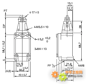

Ä͸ßÎÂÐг̿ª¹Ø³ß´ç
