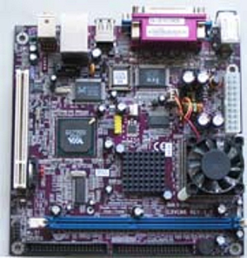

     ECS C3VCM6Ö÷»ú°åÊôÓÚϵÁР17 x 17 ¹«·ÖµÄСÐ͹æ¸ñ×îвúÆ·£¬ÍâÐÍÇᱡ¡¢×îµÍÔëÒô¼°µÍ¹¦ÂʵÈÌØÉ«£¬ÊÇ´´ÔìÏȽøÊý×Ö¶àýÌåÓéÀÖµÄ×î¼Ñ½â¾ö·½°¸¡£PC1500EϵÁÐÓг¬Ç¿µÄ¶àýÌåÐÅÏ¢´¦ÀíÄÜÁ¦£¬Ö§³Ö×îеÄMPEG2¹¦ÄÜ£¬¿ÉÇáËÉÌṩȫ·½Î»µÄÊý×Ö¶àýÌåÓéÀÖÓ¦Óã¬ÎÞÂÛÊÇÓлú¶¥ºÐ(Set-Top-Box)¡¢¼ÒÍ¥¶àýÌåÖÐÐÄ(Home Media Center)¡¢Òº¾§¶àýÌåµçÊÓÓë¼ÆËã»ú(LCD PC)µÈÓ¦Óö¼ÊÇ×î¼ÑµÄÑ¡Ôñ¡£Ö§³ÖMicrosoft Windows XP and Linux operating systems¡£
     C3VCM6£ºCPUΪ¼¯³ÉVIA C3 1G Mhz£¬Ð¾Æ¬×éVIA CLE 266£¬1 DIMM£¬1¸ö3.5´çÓ²ÅÌIDE£¬2 COM£¬1 Print£¬1 VGA£¬6 USB£¬1 Íø¿Ú£¬1Êó¼ü£¬Audio£¬Flex ATXµçÔ´£¬170mm*170mm¡£
¹æ¸ñ˵Ã÷
                                                                   ECS  C3VCM6 MINI-ITXǶÈëʽÖ÷°å¹æ¸ñ
ÐͺŠ• ECS C3VCM6
´¦ÀíÆ÷ • VIA  C3 1 GHz ´¦ÀíÆ÷
оƬ×é • VIA CLE266 + VT 8235M
ϵͳÄÚ´æ • 1 ¸ö DDR1 266 DIMM ²å¿Ú
•  ×î¶àÖ§³Ö 1GB ÄÚ´æÈÝÁ¿
ͼÐÎÏÔʾ • VIA UniChrome IGP¼¯³ÉÏÔʾºËÐÄ
À©Õ¹²å²Û • 1 ¸ö PCI ²å²Û
°åÔØ IDE • 2 ¸ö UltraDMA 133/100/66 Á¬½ÓÆ÷
°åÔØ´®ÐÐ ATA • ÎÞ
°åÔØ LAN • Ö÷°å¼¯³É VIA VT6105 LOM+VT6103 оƬ£¬Ö§³Ö 10/100 °ÙÕ×ÒÔÌ«ÍøÂç
°åÔØÒôЧоƬ • Ö÷°å¼¯³É VIA VT1612A 2оƬ£¬Ö§³Ö AC'97 ¹æ¸ñ 2 ÉùµÀÒôƵ½âÂë
°åÔØ TV Êä³ö • ÎÞ
°åÔØ I/O ½Ó¿Ú • 2 ¸ö USB 2.0½Ó¿Ú
• 1 ¸ö ´®¿Ú
• 1 ¸ö ǰÖÃÒôÔ´½Ó¿Ú (Mic and Line Out)
• 1 ¸ö IR½Ó¿Ú
±³°å I/O • 1 ¸ö 10/100 Íø¿Ú
• 1 ¸ö VGA ½Ó¿Ú
• 4 ¸ö USB 2.0 ½Ó¿Ú
• 1 ¸ö Line out / MIC ½Ó¿Ú
• 1 ¸ö ²¢¿Ú
• 2 ¸ö PS2½Ó¿Ú
• 1 ¸ö ´®¿Ú
BIOS • Award BIOS
• LPC 2/4Mbit ÉÁ´æ
ϵͳ¼à¿ØºÍ¹ÜÀí • CPU µçѹ¼à¿Ø
• ÍøÂ绽ÐÑ£¨Wake-on-LAN£©¡¢¼üÅÌ¿ª»ú£¨Keyboard-Power-on£©¡¢¶¨Ê±¿ª»ú£¨Timer-Power-on£©
• ϵͳµçÔ´¹ÜÀí
• AC ¶Ïµç»Ö¸´»úÖÆ
²Ù×÷ϵͳ • Windows 2000/XP
• Linux
• Win CE
• XPe
¹¤×÷»·¾³ÎÂ¶È 0°C~ 45°C
¹¤×÷»·¾³Êª¶È 0% ~ 93%£¨Ïà¶Ôʪ¶È£»ÎÞÀäÄý£©
°åÐÍ • Mini-ITX
• 17 cm x 17 cm
