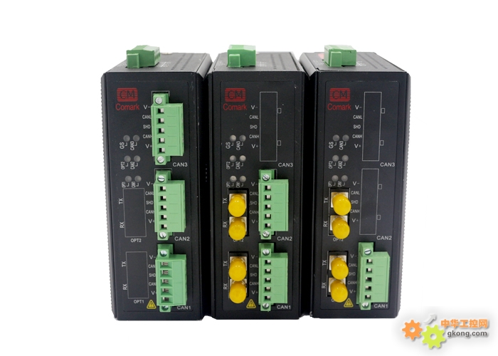

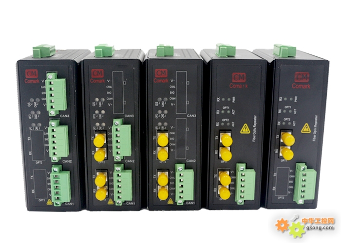

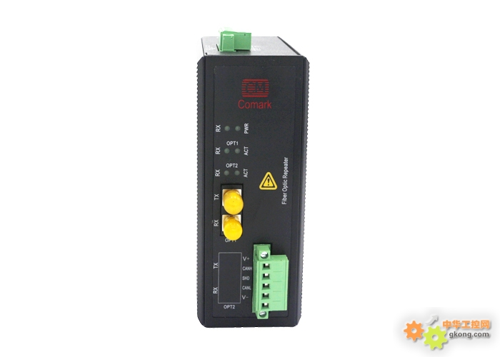

Ci-AF110/120ϵÁйâÏËÖÐ¼ÌÆ÷IP30·À»¤µÈ¼¶£¬²¨ÀËÎÆÂÁÖÆ¼ÓÇ¿»ú¿Ç£¬35mmDINµ¼¹ì°²×°£¬DC£¨9~30V£©¿íµçÔ´,¾ß±¸¼ÌµçÆ÷¸æ¾¯Êä³ö£¬Ë«µçÔ´ÈßÓàºÍ¸ôÀë±£»¤¹¦ÄÜ¡£ Ci-AF110Ö§³Öһ·¹âÏ˽ӿڣ¬Ò»Â·Êý¾Ý½Ó¿Ú£»Ci-AF120Ö§³ÖÁ½Â·¿É¼¶ÁªÉÏÏÂÐйâÏ˽ӿڣ¬Ò»Â·Êý¾Ý½Ó¿Ú¡£
×ÜÏßÊý¾Ý½Ó¿Ú
*    5Pin¶Ë×Ó½Ó¿ÚÐÎʽ
*    Ö§³ÖCAN2.0A/BЭÒé
*    Í¨ÐÅËÙÂÊ£º×î¸ß¿É´ï500Kbps£¬´«ÊäËÙÂÊÓë´«Êä¾àÀëµÄ¹ØÏµÈçϱíʾ
ËÙÂÊ£¨Kbps£©
500
250
125
100
20
10
¾àÀ루m£©
130
270
530
620
1300
3300
6700
 ×¢£ºÊµ¼Ê´«Êä¾àÀëÓë×éÍø×´¿öÓйء£
*    ¾ß±¸¹ýÔØ±£»¤ÒÔ¼°600WÀËÓ¿±£»¤¹¦ÄÜ
*    Öն˵ç×裺±¾»úÄÚ²¿²»´øÖն˵ç×裬Çë°´ÐèÒª¾ö¶¨ÊÇ·ñÍâ½Ó
¹âÏ˽ӿÚ
*    ¹âÏ˲¨³¤£º¶àÄ£850nm¡¢1310nm£»µ¥Ä£1310nm¡¢1550nm
*    ´«Êä¹âÏË£º¶àÄ£50/125um¡¢62.5/125um¡¢100/140um£¬µ¥Ä£8.3/125um¡¢9/125um¡¢10/125um
*    ´«Êä¾àÀ룺¶àÄ£2km£¬µ¥Ä£20km£¬¸üÔ¶¾àÀë¿ÉÑ¡
*    ¹âÏ˽ӿÚÀàÐÍ£ºST¡¢SC¡¢FC¿ÉÑ¡£¬±êÅäST¹â½Ó¿Ú
µçÔ´¼°±£»¤
*    µçÔ´£ºË«µçÔ´ÈßÓàÊäÈ룬DC£¨9~30V£©£¬µäÐÍDC24V£¬¹¦ºÄСÓÚ1.5W£¬¾ßÓÐDC1000Vµçѹ¸ôÀëÒÔ¼°·´½Ó±£»¤¹¦ÄÜ£¬¹¤Òµ¶Ë×Ó½Ó¿Ú
*    ¼ÌµçÆ÷¸æ¾¯Êä³ö£º¹âÏËÁ´Â·¹ÊÕϸ澯Êä³ö£¬´¥µã×î´óÈÝÁ¿£ºDC48V/1A£¬¹¤Òµ¶Ë×Ó½Ó¿Ú
»úÐµÌØÐÔ
*    ÍâÐγߴ磺136×106×54mm
*    Íâ¿Ç£ºIP30·À»¤µÈ¼¶£¬²¨ÀËÎÆÂÁÖÆ¼ÓÇ¿»ú¿Ç
*    °²×°·½Ê½£º35mm DINµ¼¹ì°²×°
*    ¾»ÖØ£º800g
¹¤×÷»·¾³
*    ¹¤×÷ζȣº-10¡æ~70¡æ£¬¿ÉÑ¡¿íβúÆ·£¨-40~85¡æ£©
*    ´æ´¢Î¶ȣº-40¡æ~80¡æ
*    Ïà¶Ôʪ¶È£º≤90%£¨ÎÞÀäÄý£©
²úÆ·±àºÅ ÃèÊö
  Ci-AF110-M ¶àÄ£2km£¬µ¥¹â¿Ú£¬¹â½Ó¿ÚÀàÐÍST¡¢SC¡¢FC¿ÉÑ¡£¬Ö§³Ö×î¸ßËÙÂÊΪ500Kbps¡£
  Ci-AF120-M ¶àÄ£2km£¬Ë«¹â¿Ú£¬¹â½Ó¿ÚÀàÐÍST¡¢SC¡¢FC¿ÉÑ¡£¬Ö§³Ö×î¸ßËÙÂÊΪ500Kbps¡£
  Ci-AF110-S µ¥Ä££¬´«Êä¾àÀë20km£¬¸üÔ¶¾àÀë¿ÉÑ¡£¬µ¥¹â¿Ú£¬¹â½Ó¿ÚÀàÐÍST¡¢SC¡¢FC¿ÉÑ¡£¬Ö§³Ö×î¸ßËÙÂÊΪ500Kbps¡£
  Ci-AF120-S µ¥Ä££¬´«Êä¾àÀë20km£¬¸üÔ¶¾àÀë¿ÉÑ¡£¬Ë«¹â¿Ú£¬¹â½Ó¿ÚÀàÐÍST¡¢SC¡¢FC¿ÉÑ¡£¬Ö§³Ö×î¸ßËÙÂÊΪ500Kbps¡£
