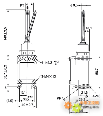

²úÆ·Ãû³Æ£º ̨ÍåÄ͸ßÎÂÏÞλ¿ª¹Ø
ÐÍ ºÅ£º NHA5
¸ÅÊö£º
Ä͸ßÎÂÏÞλ¿ª¹ØNHA5²Ù×÷ÊÖ±úΪ³¤Ìõµ¯»É£¬Í¨¹ýÅöײ¿ª¹ØÉϲ¿µÄ³¤Ìõµ¯»É£¬Ê¹¿ª¹Ø¶¥²¿³¤Ìõµ¯»ÉËæÒ⳯ÈÎÒâ·½Ïò¶¯×÷£¬´Ó¶øÊ¹¿ª¹ØµÄ´¥µã¶¯×÷¶øÊµÏÖµç·Çл»£¬ÎªÁËÔö¼ÓNHA5¿ª¹ØµÄµ¯»É»Ø¸´Á¦£¬ÓÀŸµçÆøÓÐÏÞ¹«Ë¾ÌØÖƵ¯»É¿¨»ÉÔÚ³¤Ìõµ¯»É¸ù²¿£¬Ôö¼ÓÁ˵¯»É»Ø¸´Á¦µÄÐÔÄÜ¡£

²úÆ·Ö÷Òª¼¼Êõ²ÎÊý£º
Ë«»ØÂ·ÐÍÏÞ¶¯¿ª¹Ø£¬ÓÃ;¹ã·º?
¾ß¼á¹ÌÖ®Ò»ÌåÖýÔìÂÁºÏ½ðÍâ¿Ç
¸ß»úеǿ¶È
¾ßÄÍÓÍ¡¢·ÀË®ºÍ·Àѹ½á¹¹
Òò×°ÓÐÉ趨λÖÃָʾ°å£¬¹Êά»¤ÈÝÒ×
Òý¶¯Æ÷ÖÖÀà¶à£¬·½±ãʹÓÃ
Äڲؽӵã×ùÓÐË«»ÉƬÉè¼Æ£¬»úеÊÙÃü³¤
ÌØÐÔ
²Ù×÷ËÙ¶È
    1mmÖÁ2m/S(NHÐÍ)
¶¯×÷ƵÂÊ
    »úе:120´Î/·Ö µçÆø:30´Î/·Ö
½Óµãµç×è
    15MΩÒÔÏÂ(³õÆÚ)
¾øÔµµç×è
    100MΩÒÔÉÏ(500VDC)
Ä͵çѹ
    ·ÇÁ¬Ðø¶Ë×Ó¼ä1,000VAC,50/60Hz³ÖÐø1·ÖÖÓÔØµçÁ÷ÓëÎÞÔØµçÁ÷Áã¼þ¼äÓë¶Ë×ӺͽӵØÖ®¼ä2,200VAC,50/60Hz³ÖÐø1·ÖÖÓ
Õñ¶¯
    Îó¶¯×÷Ä;ãº10ÖÁ55Hz,1.5mmË«Õñ·ù
³å»÷
    »úеÄ;ãº1,000m/Sec2(Ô¼100G,S)Îó¶¯×÷Ä;ãº300m/Sec2(Ô¼30G,S)
ÖÜΧζÈ
    Ê¹ÓÃʱ:-10 ÖÁ +350¡æ
ʪ¶È
    ×î´ó95%RH , Max 95% RH
ʹÓÃÊÙÃü
    »úе:15,000,000´ÎÒÔÉÏ(ÔڶOTÖµÏÂ) µçÆø:500,000´ÎÒÔÉÏ
ÖØÁ¿
    Ô¼360g(NH)
·À»¤µÈ¼¶
    IEC ¹æ¸ñ:IP65
