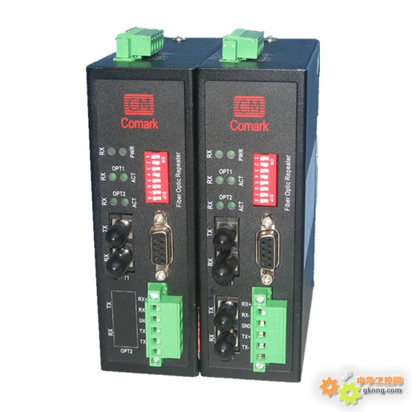

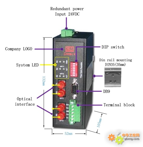

ÉîÛÚѶ¼ÇÍÆ³öCi-UF110/120ϵÁвúÆ·ÊÇÒ»¿î¹¤Òµ×ÜÏß¹â¶Ë»ú/¹âµçת»»Æ÷£¬Ö§³ÖRS232/422/485´®¿Ú£¬»ùÓÚModbus¡¢Modbus RTU¡¢Modbus-RS485µÄ×ÜÏßͨÐÅЭÒ飬µ¥¹â¿Ú/Ë«¹â¿ÚÁ´ÍøÖ§³Ö¡£ 35mmµ¼¹ì°²×°£¬DC£¨9~30V£©¿íµçÔ´£¬¾ß±¸¼ÌµçÆ÷¸æ¾¯Êä³ö£¬Ë«µçÔ´ÈßÓàºÍ¸ôÀë±£»¤¹¦ÄÜ¡£ Ci-UF110Ö§³Öһ·¹âÏ˽ӿڣ¬Ò»Â·×ÜÏßÊý¾Ý½Ó¿Ú£¬Ci-UF120Ö§³ÖÁ½Â·¿É¼¶ÁªÉÏÏÂÐйâÏ˽ӿڣ¬Ò»Â·×ÜÏßÊý¾Ý½Ó¿Ú¡£
×ÜÏßÊý¾Ý½Ó¿Ú
* RS232ËÙÂÊ£º0~115.2Kbps£¬Ö§³Ö RXD¡¢TXD¡¢GNDÈýÏß¹¤×÷·½Ê½
* RS422Ö§³ÖRX-¡¢RX+¡¢TX-¡¢TX+ȫ˫¹¤¹¤×÷ģʽ
* RS485Ö§³ÖA¡¢B°ëË«¹¤¹¤×÷ģʽ
* RS422/485ͨÐÅËÙÂÊ£º0~10Mbps¿ÉÑ¡
* ¸ôÀëµçѹ£ºË²¼ä¸ôÀëµçѹ5000V£¬³ÖÐø¸ôÀëµçѹ1000V
* Öն˵ç×裺±¾»úÄÚ²¿²»´øÖն˵ç×裬Çë°´ÐèÒª¾ö¶¨ÊÇ·ñÍâ½Ó
¹âÏ˽ӿÚ
* ¹âÏ˲¨³¤£º¶àÄ£850nm¡¢1310nm£»µ¥Ä£1310nm¡¢1550nm
* ´«Êä¹âÏË£º¶àÄ£50/125um¡¢62.5/125um¡¢100/140um£¬µ¥Ä£8.3/125um¡¢9/125um¡¢10/125um
* ´«Êä¾àÀ룺¶àÄ£2km£¬µ¥Ä£20km£¬¸üÔ¶¾àÀë¿ÉÑ¡
* ¹âÏ˽ӿÚÀàÐÍ£ºST¡¢SC¡¢FC¿ÉÑ¡£¬±êÅäST¹â½Ó¿Ú
µçÔ´¼°±£»¤
* µçÔ´£ºË«µçÔ´ÈßÓàÊäÈ룬DC£¨9~30V£©£¬µäÐÍDC24V£¬¹¦ºÄСÓÚ1.5W£¬¾ßÓÐDC1000Vµçѹ¸ôÀëÒÔ¼°·´½Ó±£»¤¹¦ÄÜ£¬¹¤Òµ¶Ë×Ó½Ó¿Ú
* ¼ÌµçÆ÷¸æ¾¯Êä³ö£º¹âÏËÁ´Â·¹ÊÕϸ澯Êä³ö£¬´¥µãÈÝÁ¿£ºDC48V/1 A£¬¹¤Òµ¶Ë×Ó½Ó¿Ú
»úÐµÌØÐÔ
* ÍâÐγߴ磺136×106×54mm
* Íâ¿Ç£ºIP30·À»¤µÈ¼¶£¬²¨ÀËÎÆÂÁÖÆ¼ÓÇ¿»ú¿Ç
* °²×°·½Ê½£º35mmµ¼¹ì°²×°
* ¾»ÖØ£º800g
¹¤×÷»·¾³
* ¹¤×÷ζȣº-10¡æ~70¡æ£¬¿ÉÑ¡¿íβúÆ·£¨-40~85¡æ£©
* ´æ´¢Î¶ȣº-40¡æ~80¡æ
* Ïà¶Ôʪ¶È£º≤90%£¨ÎÞÀäÄý£©
¿ÉÑ¡ÐͺÅ
  ²úÆ·±àºÅ ÃèÊö
  Ci-UF110-M ¶àÄ£2km£¬µ¥¹â¿Ú£¬¹â½Ó¿ÚÀàÐÍST¡¢SC¡¢FC¿ÉÑ¡£¬¿ÉÑ¡£¨Í¨ÐÅËÙÂÊΪ0~10Mbps¿ÉÑ¡£©¡£
  Ci-UF120-M ¶àÄ£2km£¬Ë«¹â¿Ú£¬¹â½Ó¿ÚÀàÐÍST¡¢SC¡¢FC¿ÉÑ¡£¬¿ÉÑ¡£¨Í¨ÐÅËÙÂÊΪ0~10Mbps¿ÉÑ¡£©¡£
  Ci-UF110-S µ¥Ä££¬´«Êä¾àÀë20km£¬¸üÔ¶¾àÀë¿ÉÑ¡£¬µ¥¹â¿Ú£¬¹â½Ó¿ÚÀàÐÍST¡¢SC¡¢FC¿ÉÑ¡£¬¿ÉÑ¡£¨Í¨ÐÅËÙÂÊΪ0~10Mbps¿ÉÑ¡£©¡£
  Ci-UF120-S µ¥Ä££¬´«Êä¾àÀë20km£¬¸üÔ¶¾àÀë¿ÉÑ¡£¬Ë«¹â¿Ú£¬¹â½Ó¿ÚÀàÐÍST¡¢SC¡¢FC¿ÉÑ¡£¬¿ÉÑ¡£¨Í¨ÐÅËÙÂÊΪ0~10Mbps¿ÉÑ¡£©¡£
