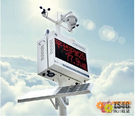

²úÆ·Ãû³Æ£º ZS4GÐÍÑï³¾ÔëÉù¼à²âÉ豸
ÐÍ ºÅ£º BR-ZS4G
-------È«ÄÜÐÍÁ¬ÐøÊµÊ±Ñï³¾ÔëÉù¼à²âÒÇ
²ÉÓÃ90°É¢Éäʽ¹â¶È¼Æ£¨×Ƕȼƣ©Ô­Àí£¬ÊÇ´óÆøÎÛȾ·ÀÖÎÁìÓòÐü¸¡¿ÅÁ£Îï¼à²âרÓÃÒÇÆ÷¡£¸÷µØ»·±£²¿ÃÅÈϿɲ¢ÍƼöµÄ»·¾³¼à²âÉ豸¡£
ZS4GÐÍÑï³¾ÔëÉù¼à²âÉ豸Ö÷ÒªÌØµã
  Á¿³Ì0.001~50mg/m³
  ¿ÕÆøÖÊÁ¿£¨AQI£©´«¸ÐÆ÷À©Õ¹½ÓÈë
  ¹âÕÕ¡¢ÓêÑ©Á¿µÄÀ©Õ¹½ÓÈë
  Ò»Ì廯½á¹¹Ê½LEDÉè¼Æ
  ÄÚÖÃÊ®´ç¹¤Òµ¼¶´¥ÃþÆÁ
  ¹¤ÒµÈý·À±ê×¼£¬20000ʱÎÞ¹ÊÕÏ
ÈýͨµÀͬ²½¼à²â
µÃÒæÓÚµÚÎå´úǶÈëʽ¼¯³ÉµÄ³ÉÊìÓ¦Óã¬ZS4GʵÏÖÁËTSP/PM10/PM2.5ÈýͨµÀͬ²½¼à²â£¬Ê¹µÃ×îÖÕÊý¾Ý
Öµ¾ß±¸¸ü¶àÊý¾ÝÐÅÏ¢£¬±ãÓÚ·ÖÎöʹÓá£
ZS4GÐÍÑï³¾ÔëÉù¼à²âÉ豸²ÎÊý
Ñï³¾¿ÅÁ£Îï¼à²â
Ũ¶È²ÎÊý       £¨0.001¡«50£©mg/m³
²âÁ¿Ô­Àí       90°¹âÉ¢Éäʽ
¼¤¹âÔ´    650nm¿É¼ûºì¹â£¬Éé»¯ïØ°ëµ¼Ì弤¹âÆ÷
²âÁ¿²ÎÊý       PM2.5/PM10/TSPÈýͨµÀͬ²½Í¬²â
×îС¿ÅÁ£ÎïÁ£¾¶    0.1μm
²âÁ¿Á£¾¶·¶Î§       PM2.5£º£¨0.1¡«2.5)μm PM10£º£¨0.1¡«10£©μm TSP£º£¨0.1¡«100£©μm
Ũ¶È²âÁ¿Ïà¶ÔÎó²î£¨×¼È·¶È£©    ±10%£¬¿ÉËÝÔ´µ½SAE²âÊÔ
ÖØÏÖÐÔÎó²î£¨Öظ´ÐÔ£©       7%
·Ö±æÂÊ    0.0005mg/m³
Îȶ¨ÐÔÏà¶ÔÎó²î    ±2.5%
Á÷Á¿       2L/min
24СʱÁ÷Á¿Îó²î   £¼5%
²ÉÑùÁ÷Á¿Îȶ¨ÐÔÎó²î    ±2.5%
Îȶ¨ÐÔÏà¶ÔÎó²î    ±5%
Êý¾Ý´æ´¢ÖÜÆÚ       1min
²ÉÑùʱ¼ä       20s/´Î
ÔëÉù¼à²â
´«ÉùÆ÷          Φ12.7mm(1/2″)²âÊÔµçÈÝ´«ÉùÆ÷£¬ÁéÃô¶ÈÔ¼30mV/Pa
ƵÂÊ·¶Î§      10Hz¡«20£¬000Hz
ÒÇÆ÷¾«¶È      ·ûºÏGB/T3785-2010  2¼¶  IEC61672
·Ö±æÂÊ          0.1dB
ƵÂʼÆÈ¨      A/C¼ÆÈ¨
²âÁ¿·¶Î§      25dB¡«130DdB
²Î¿¼·½Ïò      µçÈÝ´«ÉùÆ÷µÄÖáÏò
²Î¿¼Éùѹ¼¶   94dB
ʱ¼ä¼ÆÈ¨       ¿ì£¨F£©¡¢Âý£¨S£©¡¢Âö³å£¨I£©
ÆäËû
ÍâÐÎ³ß´ç¼°ÖØÁ¿     L*W*H£¨mm£©810*350*1500   ≈50kg
