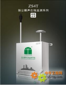

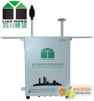

²úÆ·Ãû³Æ£º ËÄ´¨²tÍû¹¤µØÑï³¾ÔÚÏßÔ¤¾¯ÏµÍ³
ÐÍ ºÅ£º BR-ZS4T
ËÄ´¨²tÍû¹¤µØÑï³¾ÔÚÏßÔ¤¾¯ÏµÍ³£¨ZS4T£©

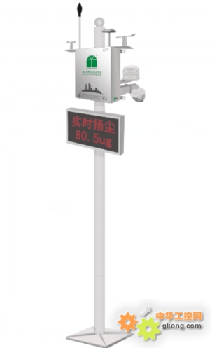

ËæÊ±³ÇÊеĿìËÙ·¢Õ¹£¬³ÇÊÐÔÚ½¨¹¤µØÔ½À´Ô½¶à£¬¹¤µØÑï³¾¡¢ÔëÉù²ôÔÓÓÚÎÒÃÇÉú»îÖ®ÖУ¬ÔëÉùÎÛȾ¡¢Ë®ÎÛȾºÍ¿ÕÆøÎÛȾ£¬ÊÇÊÀ½çµÄÈý´ó¹«º¦¡£¹¤µØÑï³¾ÔëÉùÖÎÀí¡¢¹ÜÀíµÄÄѶȺܴó£¬Í¬Ê±£¬ÎÒÃǹúÄÚʵʩµÄÑï³¾¹ÜÀíÊÖ¶ÎÂäºó£¬ËäÈ»Óжà¸ö²¿ÃÅͬʱ¼à¹Ü£¬ÒÀÈ»²»Äܺܿ췢ÏÖÑï³¾ÎÛȾ£¬²»ÄܽøÐÐÓÐЧµÄ¿ØÖÆ£¬×îÖ÷ÒªµÄÔ­ÒòÊÇȱ·¦Êʺϵļà²âÊֶΡ£ËÄ´¨²tÍû×ÔÖ÷Ñз¢µÄ¹¤µØÑï³¾ÔÚÏßÔ¤¾¯ÏµÍ³ºÜºÃµÄ½â¾öÁËÕâÒ»ÄÑÌâ¡£¹¤µØÑï³¾ÔÚÏßÔ¤¾¯ÏµÍ³ÓÉÔëÉù¼à²âµ¥Ôª¡¢Ñï³¾£¨PM2.5¡¢PM10£©¼à²âµ¥Ôª¡¢ÊÓÆµ¼à²âµ¥Ôª¡¢LEDÏÔʾµ¥Ôª¡¢ÖÇÄܹÜÀíÆ½Ì¨¡¢ÊÖ»úAAP¼¸´ó²¿·Ö×é³É£¬ÊµÏÖ¹¤µØÑï³¾ÔëÉùÔÚÏßÔ¤¾¯£¬ÌصãΪ£º
1.°²×°·½±ã£¬²Ù×÷¼òµ¥£»
2.¼à²âÊý¾Ý¾«×¼£¨Óë¹ú¿Ø²âÊý¾ÝÎó²îΪ10%£©£»
3.¿ÉÎÞ·ì½ÓÈëÕþ¸®ÒÑÓÐ¹Ü¿ØÆ½Ì¨£¨ÌṩSDK¼°Íø¿ÚͨѶЭÒ飩
4.ÖÇÄܹÜÀíÆ½Ì¨+AAPµÄÍêÃÀ½áºÏ£¬½«¹Ì¶¨°ì¹«£¬ÌáÉýµ½Ô¶³Ì°ì¹«£¨Õþ¸®¼°Ïà¹Ø¸ºÔðÈËͨ¹ýÊÖ»úAAPʵʱ²éѯÑï³¾ÎÛȾ״¿ö£©£»
ZS4TÑï³¾²ÎÊýÖ¸±ê
Ũ¶ÈÁ¿³Ì£º0.001~10/30mg/m³
²âÁ¿Ô­Àí£º45¶ÈÉ¢Éäʽ
ÌØÊ⹦ÄÜ£º¼ÓÈÈ¿ØÊª£¬Êª¶ÈÐÞÕý
²âÁ¿²ÎÊý£ºPM2.5/PM10ͬ²â»òµ¥¶ÀTSP
²âÁ¿Á£¾¶·¶Î§£ºPM2.5£º0.3-2.5µm£»PM10£º0.3-10µm £»TSP:0.3-100µm
Ũ¶È²âÁ¿Ïà¶ÔÎó²î£¨×¼È·¶È£©£º±10%£¬¿ÉËÝÔ´µ½SAE²âÊÔ
ÖØÏÖÐÔÎó²î£¨Öظ´ÐÔ£©£º 0-10mg/m³£º7% £»10-30mg/m³£º15%
·Ö±æÂÊ£º0.001mg
Îȶ¨ÐÔÏà¶ÔÎó²î£º±2.5%
Á÷Á¿£º 2L/min
24СʱÁ÷Á¿Îó²î£º£¼5%
²ÉÑùÁ÷Á¿Îó²î£º±2.5%
²ÉÑùÁ÷Á¿Îȶ¨ÐÔÎó²î£º±5%
Êý¾Ý´æ´¢Æ½¾ùÖÜÆÚ£º1·ÖÖÓ
²ÉÑùʱ¼ä£º1·ÖÖÓ
ZS4TÔëÉù²ÎÊý£¨¿ÉÑ¡£©
´«ÉùÆ÷£ºΦ12.7mm(1/2″)²âÊÔµçÈÝ´«ÉùÆ÷£¬ÁéÃô¶ÈÔ¼26mV/Pa
ƵÂÊ·¶Î§£º20Hz¡«12£¬500Hz
ÒÇÆ÷¾«¶È£º·ûºÏGB/T3785-2010  IEC61672  2¼¶
·Ö±æÂÊ£º0.1dB
ƵÂʼÆÈ¨£ºA¼ÆÈ¨
²âÁ¿·¶Î§£º35dB¡«130dB (A)
²Î¿¼·½Ïò£ºµçÈÝ´«ÉùÆ÷µÄÖáÏò
²Î¿¼Éùѹ¼¶£º94dB
ʱ¼ä¼ÆÈ¨£º ¿ì£¨F£©
ÆäËû²ÎÊý
µçÔ´£º220VAC
¹¦ºÄ£º40W
ÍâÐÎ³ß´ç¼°ÖØÁ¿£ºL*W*H  500*240*750£¨cm£© 20kg
