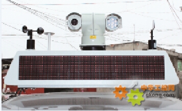

»ùÓÚ³µÔØ×¨ÓýṹÉè¼Æ£¬ÊÇÑï³¾ÔëÉùÒÆ¶¯¼à²â¡¢Ó¦¼±¼à²â¡¢ÁÙʱʩ¹¤¼à²âµÄ¼à²â·½°¸¡£
ZS4C³µÔØÊ½Ñï³¾ÔëÉù¼à²âϵͳÖ÷ÒªÌØµã
.Å䱸³µÔØ×¨ÓÃLEDÏÔʾÆÁ
.¶ÌÆÚÊ©¹¤Ñï³¾ÔëÉù¼à²âÑ¡Ôñ·½°¸
.¿É³µÄÚʵʱ²é¿´¼à²âÊý¾Ý
.¿ÉÑ¡ÔëÉù¡¢PM2.5/PM10˫ͨµÀ¼à²â»òTSP¼à²â
.Æû³µµçÔ´Ö±½Ó¹©µç
¼¼Êõ²ÎÊý
Ò».Ñï³¾¿ÅÁ£Îï¼à²â
.Ũ¶È²ÎÊý£º£¨0.001~30)mg/m³
.²âÁ¿²ÎÊý£ºPM2.5/PM10ͬ²â»òµ¥¶ÀTSP
.·Ö±æÂÊ£º0.001mg/m³
.²ÉÑùʱ¼ä£º1min/´Î
.Êý¾Ý´¢´æÖÜÆÚ£º1min
.×îС¿ÅÁ£ÎïÁ£¾¶£º0.3um
¶þ.ÔëÉù¼à²â
.ƵÂÊ·¶Î§£º20HZ~12,500HZ
.ÒÇÆ÷¾«¶È£º·ûºÏGB/T3785-2010 2¼¶IEC61672
.·Ö±æÂÊ£º0.1dB
.²âÁ¿·¶Î§£º(35~130£©dB
.²Î¿¼·½Ïò£ºµçÈÝ´«ÉùÆ÷µÄÖáÏò
.²Î¿¼Éùѹ¼¶£º94dB
.ʱ¼ä¼ÆÈ¨£º¿ì£¨F)
¹¦ÄÜ£º¼ÓÈȳýʪ¡¢¶ÏÏßÊý¾ÝÐø´«¡¢ÔËÐÐ״̬×Լ졢ÎÂʪ¶ÈÐÞÕý
