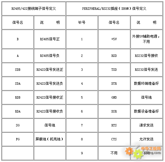

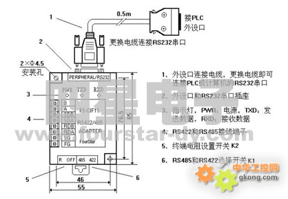

²úÆ·ÍâÐμ°¶Ë×ÓÐźŶ¨Ò壺
RS485/422½ÓÏß¶Ë×ÓÐźŶ¨Òå
PERIPHERAL/RS232²å×ù£¨DB9M£©ÐźŶ¨Òå

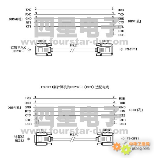

FS-CIF11ÓëPLC»ò¼ÆËã»úµÄÁ¬½Ó£º
FS-CIF11ÓëPLCµÄÍâÉè¿Ú¡¢RS232´®¿Ú»ò¼ÆËã»úµÄRS232´®¿ÚµÄÁ¬½Ó¾ùʹÓÃPERIPHERAL/RS232²å×ù£¨DB9M£©£¬²úÆ·µÄÄÚ²¿µç·»á×Ô¶¯Ê¶±ðÍâÉè¿ÚºÍRS232´®¿Ú¡£ÓÃËæ²úÆ·ËùÅäµÄÍâÉè¿ÚÁ¬½ÓµçÀ¿ÉÖ±½Ó½«FS-CIF11Á¬½Óµ½Å·Ä·ÁúCPM1A/2A¡¢CQM1¡¢C200HαµÈPLCµÄÍâÉè¿Ú£¬FS-CIF11ÓëPLCµÄRS232»ò¼ÆËã»úµÄRS232´®¿ÚµÄÁ¬½ÓµçÀÂÐèÓû§×ÔÖÆ£¬²ÎÕÕÏÂͼ¡£ÈçʹÓÃÆÁ±ÎµçÀ£¬Ç뽫ÆÁ±Î²ãº¸½ÓÔÚÁ½¸ö²åÍ·µÄÍâ¿ÇÉÏ¡£

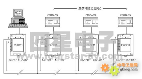

1¡¢¶þÏß°ëË«¹¤RS485ͨÐÅÍøÂ磺
½«FS-CIF11ÊÊÅäÆ÷ÉϵÄRS485ºÍRS422Ñ¡Ôñ¿ª¹ØK1²¦µ½"485"£¬½«ÍøÂçµÄʼ¶ËºÍÖն˵ÄFS-CIF11ÉϵÄÖն˵ç×èÉèÖÿª¹ØK2²¦µ½"R"£¬ÍøÂçÉÏµÄÆäËüFS-CIF11ÉϵÄÖն˵ç×èÉèÖÿª¹ØK2²¦µ½"OFF"¡£
2¡¢ËÄÏßȫ˫¹¤RS422ͨÐÅÍøÂç
ÕâÖÖ·½Ê½ÍêÈ«µÈͬÓÚÅ·Ä·ÁúCPM1-CIF11ºÍNT-AL001¡£
½«FS-CIF11ÊÊÅäÆ÷ÉϵÄRS485ºÍRS422Ñ¡Ôñ¿ª¹ØK1²¦µ½"422"£¬½«ÍøÂçµÄʼ¶ËºÍÖն˵ÄFS-CIF11ÉϵÄÖն˵ç×èÉèÖÿª¹ØK2²¦µ½"R"£¬ÍøÂçÉÏµÄÆäËüFS-CIF11ÉϵÄÖն˵ç×èÉèÖÿª¹ØK2²¦µ½"OFF"¡£
