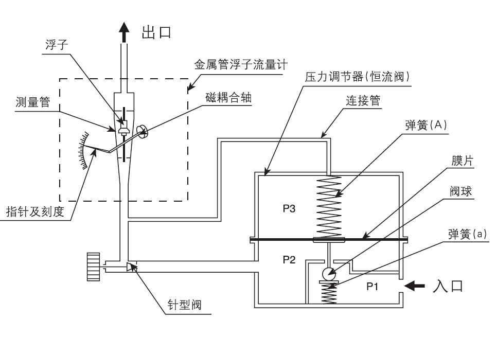

¹¤×÷Ô­Àí
¸ù¾Ý²âÁ¿½á¹¹Ê¾Òâͼ£¨ÒԺ㶨Èë¿ÚѹÁ¦ÎªÀý£©¿ÉÒÔ¿´³ö£º
µ¯ÐÔĤƬÊܵ½ÏòÉϵÄ×÷ÓÃÁ¦Îª£º
P2A+P1a .............£¨1£©
P3A+P2a+F .............£¨2£©
ÔÚѹÁ¦´¦ÓÚÆ½ºâ״̬ʱ£¬¼´£º£¨1£©=£¨2£©Ê± P2A+P1a=P3A+P2a+F.........£¨3£©
×÷ΪѹÁ¦µ÷½ÚÆ÷ĤƬµÄ²îѹP2-P3£¬ÎÒÃÇ¿ÉÒԵõ½ÒÔϵĵÈʽ£º
P2-P3=F/A-a/A£¨P1-P2£©........£¨4£©
ÓÉÓÚa C£¨ºã¶¨Öµ£©=P2-P3
µ±²âÁ¿½éÖÊÊDz»¿ÉÒÔѹËõµÄÒºÌåʱ£¬REѹÁ¦µ÷½ÚÆ÷¿ÉÒÔÊÊÓóö¿ÚѹÁ¦±ä»¯¡£¶ÔÓÚ£¨4£©Ê½ÖУ¬ÓÉÓÚP1ÊǺ㶨µÄ£¬P3ÊDZ仯µÄ£¬Òò´Ë£¬P3±äΪ£ºP3+ΔP£¬P2±äΪ£ºP2+ΔP£¬ËùÒÔ£º
C£¨ºã¶¨Öµ£©=P2-P3
