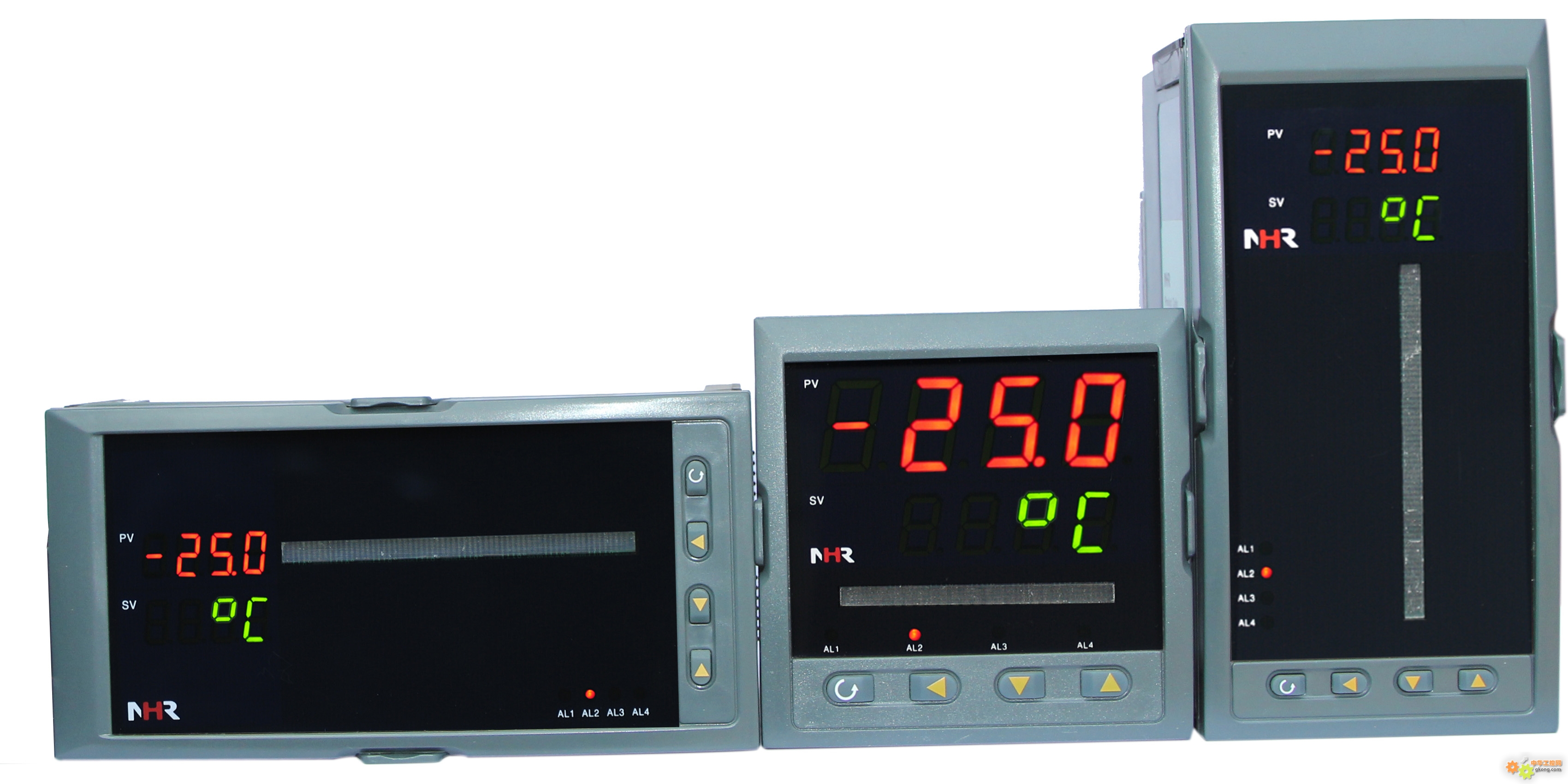

ºçÈóÍÆ³öοØÒDZí
¸ÅÊö
    NHR-5100ϵÁе¥»ØÂ·Êý×ÖÏÔʾ¿ØÖÆÒÇÕë¶ÔÏÖ³¡Î¶ȡ¢Ñ¹Á¦¡¢ÒºÎ»¡¢Ëٶȵȸ÷ÖÖÐźŽøÐвɼ¯¡¢ÏÔʾ¡¢¿ØÖÆ¡¢Ô¶´«¡¢Í¨Ñ¶¡¢´òÓ¡µÈ´¦Àí£¬¹¹³ÉÊý×ֲɼ¯ÏµÍ³¼°¿ØÖÆÏµÍ³£¬¹ã·ºÔËÓÃÓÚµçÁ¦¡¢Ê¯»¯¡¢Ò±½ð¡¢ÇṤ¡¢ÖÆÒ©¡¢º½¿ÕµÈÖî¶àÁìÓò¡£
1.µ¥Â·ÊäÈ룬˫ÆÁLEDÊýÂëÏÔʾ£¬ÇÒ´øÓйâÖùÄ£Äâָʾ¹¦ÄÜ(0¡«100%)¡£
2.¾ß±¸36ÖÖÐźÅÊäÈ빦ÄÜ£¬¿ÉÈÎÒâÑ¡ÔñÊäÈëÐźÅÀàÐÍ£¬0.2%¼¶²âÁ¿¾«¶È¡£
3.Èȵç×èÈȵçżÐźŷֱæÂÊ¿ÉÇл»:1¡æ»ò0.1¡æ¡£
4.¾ß±¸“ÉÏÏÂÏÞ±¨¾¯”¡¢“ÑÓ³Ù±¨¾¯”¡¢“¶ÏÏß±¨¾¯”¡¢“ÉÁ˸±¨¾¯”µÈ±¨¾¯¹¦ÄÜ,´øLED±¨¾¯µÆÖ¸Ê¾¡£
5.¾ßÓеçѹ¡¢µçÁ÷±äËÍÊä³öÐźſÉÑ¡¡£
6.Ö§³ÖRS485¡¢RS232´®Ðнӿڣ¬²ÉÓñê×¼MODBUS RTUͨѶЭÒé¡£
7.ÒDZí¿É´øRS232C´òÓ¡¹¦ÄÜ£¬¾ßÓÐÊÖ¶¯´òÓ¡¡¢¶¨Ê±´òÓ¡¡¢±¨¾¯´òÓ¡µÈ¹¦ÄÜ¡£
8.´øDC24VÀ¡µçÊä³ö£¬ÎªÏÖ³¡±äËÍÆ÷Åäµç¡£
9.ÊäÈë¡¢Êä³ö¡¢µçÔ´¡¢Í¨Ñ¶Ï໥֮¼ä²ÉÓùâµç¸ôÀë¼¼Êõ¡£
10.¾ß±¸¶àÖÖÍâÐγߴ缰Ñùʽ¹©Óû§Ñ¡Ôñ¡£
11.²ÎÊýÉ趨ÃÜÂëËø¶¨¡¢²ÎÊýÉèÖöϵçÓÀ¾Ã±£´æ£¬¾ß±¸²ÎÊý»Ö¸´³ö³§É趨¹¦ÄÜ¡£

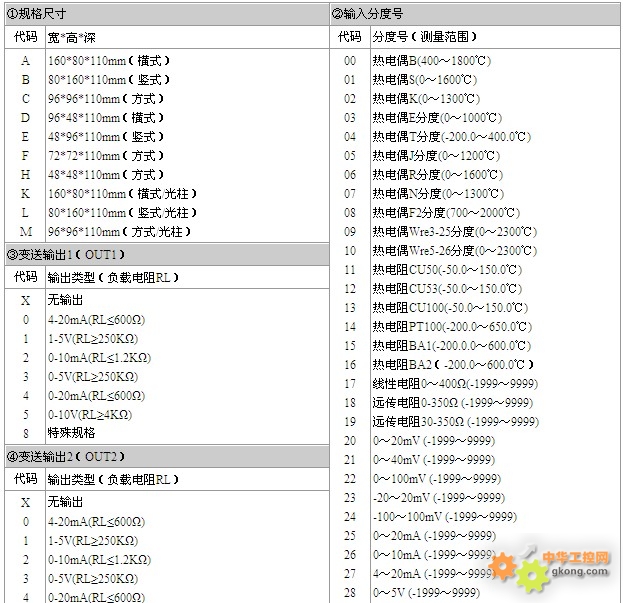

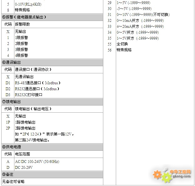

ÒDZíÑ¡ÐÍ
NHR-5100¡õ-¡õ-¡õ/¡õ/¡õ/¡õ/¡õ( )-¡õ-( )
        ¢Ù ¢Ú ¢Û ¢Ü ¢Ý ¢Þ ¢ß    ¢à  ¢á
±¸×¢£º
1¡¢Ñ¡ÐÍʱÇë¸ù¾Ý½ÓÏßͼÀ´Ñ¡Ôñ¹¦ÄÜ£¬ÓÉÓڳߴçСµÄÒDZí½ÓÏß¶Ë×ÓÉÙ´ø²»ÁËÈ«¹¦ÄÜ£¬ÓеŦÄÜÔÚͬ×é¶Ë×ÓÉÏÖ»ÄÜÑ¡ÔñÆäÖÐÒ»ÖÖ¹¦ÄÜ£»
2¡¢¹æ¸ñ³ß´çΪFÐ͵ÄÒÇ±í²»´øRS232C´òÓ¡½Ó¿Ú£»
      ¹æ¸ñ³ß´çΪHÐ͵ÄÒÇ±í²»´øRS232ͨѶ½Ó¿ÚºÍRS232C´òÓ¡½Ó¿Ú£¬ÊäÈë·Ö¶ÈºÅ²»¿ÉÑ¡Ôñ38:0¡«600V£»
3¡¢¹æ¸ñ³ß´çΪHÐÍÒÔ¼°½ÓÏß¶Ë×Ó25-36¼ä´ø±¨¾¯¹¦ÄܵÄD¡¢EÐÍÒÇ±í£¬¼ÌµçÆ÷´¥µãÈÝÁ¿ÎªAC125V/0.5A¡¢DC24V/0.5A£¬ÆäËü¹æ¸ñ³ß´çµÄÒDZí¼ÌµçÆ÷´¥µãÈÝÁ¿ÎªAC220V/2A¡¢DC24V/2A¡£
4¡¢Ñ¡ÐÍʱ±ØÐëÍêÕû£¬Ã»ÓÐÑ¡µ½µÄ¹¦ÄÜÏî²»ÄÜÊ¡ÂÔ£¬±ØÐëÓÓX”²¹ÉÏ¡£
      Àý1£ºNHR-5100A-55-0/X/2/D1/1P(24)-A
