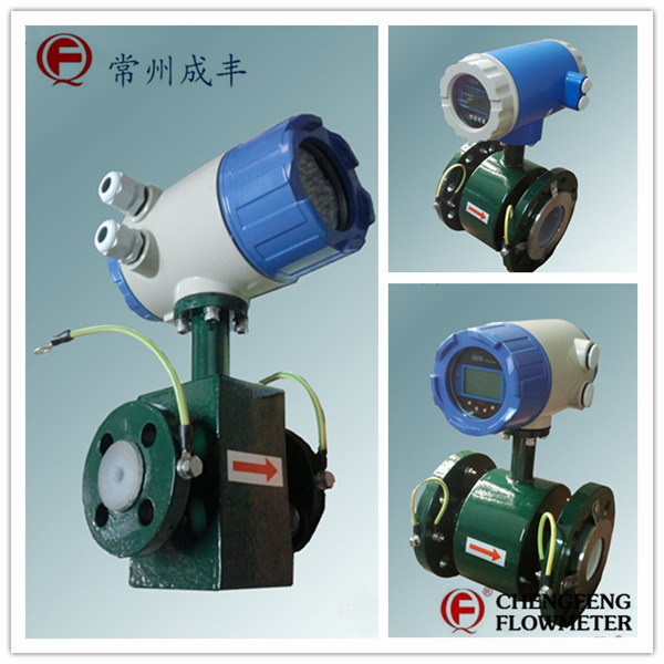

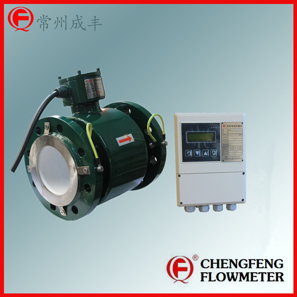

Ö÷Òª¼¼Êõ²ÎÊý
¡ô Õû»úºÍ´«¸ÐÆ÷¼¼ÊõÊý¾Ý
Ö´Ðбê×¼ JB/T9248-1999
¹«³ÆÍ¨¾¶ 3¡¢6¡¢10¡¢15¡¢20¡¢25¡¢32¡¢40¡¢50¡¢65¡¢80¡¢100¡¢125¡¢150¡¢200¡¢250¡¢300¡¢350¡¢400¡¢450¡¢500¡¢
600¡¢700¡¢800¡¢900¡¢1000¡¢1200¡¢1400¡¢1600¡¢1800¡¢2000¡¢2200¡¢2400¡¢2600¡¢2800¡¢3000
×î¸ßÁ÷ËÙ 15m/s
׼ȷ¶È ʾֵµÄ±0.5£¥(Á÷ËÙ0.8m/s)£»±4mm/s(Á÷ËÙ<0.8m/s)
Á÷Ìåµçµ¼ÂÊ ≥5uS/cm£¬
¹«³ÆÑ¹Á¦ 1.6 MPa 1.6 MPa 1.0 MPa 0.6 MPa 6.3¡¢10 MPaµÈ
DN3¡«DN150 DN15¡«DN600 DN200¡«DN1000 DN700¡«DN3000 ÌØÊâ¶©»õ
³ÄÀï²ÄÁÏ ¾ÛËÄ·úÒÒÏ©¡¢¾ÛÂȶ¡Ï𽺡¢¾Û°±õ¥¡¢¾ÛÈ«·úÒÒ±ûÏ©(F46)¡¢¼ÓÍøPFA¡¢PO
»·¾³ÎÂ¶È ´«¸ÐÆ÷ -25¡æ¡«+60¡æ
ת»»Æ÷¼°Ò»ÌåÐÍ -10¡æ¡«+60¡æ
×î¸ßÁ÷ÌåÎÂ¶È Ò»ÌåÐÍ 70¡æ
·ÖÀëÐÍ ¾ÛÂȶ¡Ï𽺳ÄÀï 80¡æ;120¡æ(¶©»õʱעÃ÷)
¾Û°±õ¥³ÄÀï 80¡æ
¾ÛËÄ·úÒÒÏ©³ÄÀï 100¡æ;150¡æ(¶©»õʱעÃ÷)
¾ÛÈ«·úÒÒ±ûÏ©(F46)
¼ÓÍøPFA
Ðźŵ缫ºÍ
½ÓµØµç¼«²ÄÁÏ
²»Ðâ¸Ö0Cr18Ni12Mo2Ti¡¢¹þÊϺϽðC¡¢¹þÊϺϽðB¡¢îÑ¡¢îã¡¢²¬/Ò¿ºÏ½ð¡¢²»Ðâ¸ÖÍ¿¸²Ì¼»¯ÎÙ
µç¼«¹Îµ¶»ú¹¹ DN80¡«DN3000
Á¬½Ó·¨À¼²ÄÁÏ Ì¼¸Ö
Á¬½Ó»·²ÄÁÏ ²»Ðâ¸Ö1Cr18Ni9Ti
Íâ¿Ç·À»¤ ND15¡«DN3000·ÖÀëÐÍÏ𽺻ò¾Û°±õ¥³ÄÀï´«¸ÐÆ÷ IP65»òIP68
Ò»ÌåÐÍ(Ô²ÐÍת»»Æ÷) IP67
ÆäËû´«¸ÐÆ÷ºÍ·ÖÀëÐÍת»»Æ÷ IP65
·À±¬ÐÍÒDZí
µÄ·À±¬±êÖ¾
Ex deia¢òCT4 IP65¡¢DN15¡«DN600
¼ä¾à(·ÖÀëÐÍ) ·ÖÀëÐ͵çÀ³§¼ÒÌṩ±ê×¼³¤¶ÈΪ10m ת»»Æ÷¾à´«¸ÐÆ÷Ò»°ã²»³¬¹ý100m£¬³¬¹ý100mÐèÌØÊâ¶©»õ
²úÆ·Ñ¡ÐͱàÂë
a.Á¬½ÓÐÎʽ
e.µç¼«²ÄÁÏ
A ·¨À¼Á¬½Ó
B ¼Ð³Öʽ
1 ²»Ðâ¸Ö0Cr18Ni12Mo2Ti
2 ¹þÊϺϽðB
3 ¹þÊϺϽðC
4 îÑ
5 ²¬/Ò¿ºÏ½ð
6 îã
b.¹«³ÆÍ¨¾¶(mm)
±àÂë ͨ¾¶ ±àÂë ͨ¾¶ ±àÂë ͨ¾¶
015 15 250 250 10A 1000
020 20 300 300 12A 1200
025 25 350 350 14A 1400
040 40 400 400 16A 1600
050 50 450 450 18A 1800
065 65 500 500 20A 2000
100 100 600 600 22A 2200
150 150 700 700 24A 2400
200 200 800 800 26A 2600
    900 900 28A 2800
        30A 3000
f.¿ÇÌå·À»¤
1 IP65
2 IP68+IP65(ÒÔ´«¸ÐÆ÷IP68+ת»»Æ÷IP65)(dÂë½ö¿ÉÑ¡2£¬3¡¢
4¡¢6£»gÂë½ö¿ÉÑ¡0£»iÂë½ö¿ÉÑ¡CR£»kÂë½ö¿ÉÑ¡01¡«02)
3 IP67(gÂë½ö¿ÉÑ¡0£»iÂë½ö¿ÉÑ¡CH£»kÂë½ö¿ÉÑ¡03)
g.·À±¬±êÖ¾
0 ÎÞ
1 ·À±¬£¬fÂëÑ¡1¡¢kÂëÑ¡02»ò03£»
h.¸½ ¼þ
0 ÎÞ
1 ½ÓµØµç¼«(DN25¡«DN3000)
2 ½ÓµØ»·(DN15¡«DN3000)
3 µç¼«¹Îµ¶»ú¹¹(DN80¡«DN3000)
c.¹«³ÆÑ¹Á¦(MPa£©
06 0.6 (DN700¡«DN3000)
10 1.0 (DN15¡«DN1000)
16 1.6 (DN15¡«DN600)
40 4.0 (DN15¡«DN150)
xx ÌØÊâ¶©»õ
i.½á ¹¹
CR ·ÖÀëÐÍ
CH Ò»ÌåÐÍ
j.µç Ô´
1 85¡«265V AC 45¡«400Hz
2 16¡«40V DC
d.³ÄÀï²ÄÁÏ
1 ¾ÛËÄ·úÒÒÏ©(F4) (DN15¡«DN1000)(²»ÊÊÓÃÓÚ¸ºÑ¹)
2 ¾ÛÂȶ¡Ï𽺠(DN50¡«DN3000)
3 ¾Û°±õ¥ (DN15¡«DN600)
4 ¾ÛÈ«·úÒÒ±ûÏ©(F46)(DN10¡«DN250)(DN65ÒÔÉÏÊÊÓÃÓÚ¸ºÑ¹)
5 PFA (DN10¡«DN250)(DN65ÒÔÉÏÊÊÓÃÓÚ¸ºÑ¹)
6 PO (DN50¡«DN400)
k.ת»»Æ÷ÐÍʽ
01 ·½·ÖÀëÐÍ¡¢µ¥µçÁ÷¡¢Ë«Âö³å¡¢Ë«±¨¾¯
02 Ô²·ÖÀëÐÍ¡¢µ¥µçÁ÷¡¢µ¥Âö³å¡¢Ë«±¨¾¯
03 Ô²Ò»ÌåÐÍ¡¢µ¥µçÁ÷¡¢µ¥Âö³å¡¢Ë«±¨¾¯
04 ·½Ò»ÌåÐÍ¡¢µ¥µçÁ÷¡¢Ë«Âö³å¡¢Ë«±¨¾¯
×¢£º1.ͨѶЭÒ飺RS232.RS485.HART¿ÉÑ¡Åä
2.ÅúÁ¿¿ØÖƹ¦ÄÜ¿ÉÑ¡Åä
3.GPRSÔ¶³Ì¼à¿Ø¹¦ÄÜ¿ÉÑ¡Åä
×¢£ºµôµç¼Ç¼¹¦ÄÜ¿ÉÑ¡Åä
