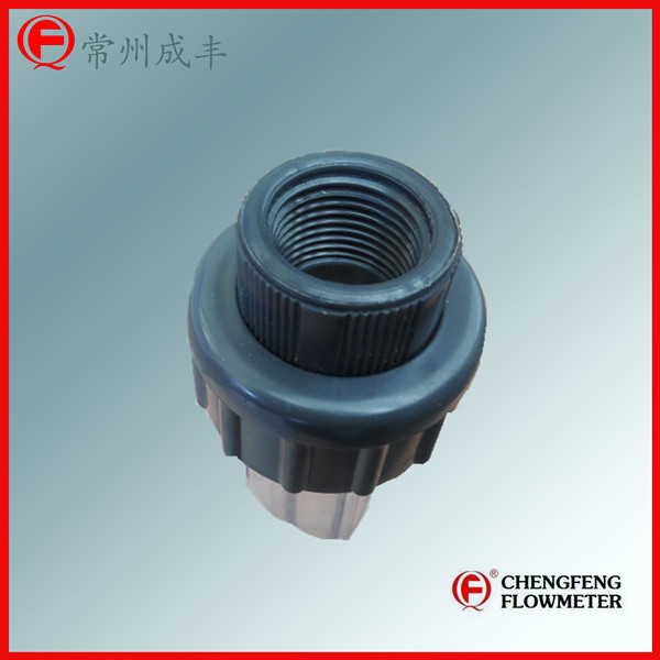

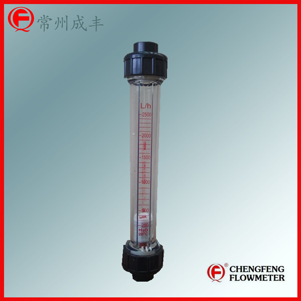

LZB-£¨£©SÐÍËÜÁϹܸ¡×ÓÁ÷Á¿¼ÆÖØÁ¿ÇᣬÄ͸¯Ê´£¬²»ÒׯÆË飬ÎÞ¶¾ÎÞζ£¬Ê¹Ó÷½±ã£¬Ö÷ÒªÓÃÓÚ»¯¹¤¡¢ÇṤ¡¢Ò½Ò©¡¢Ê³Æ·¡¢»·±£µÈ²¿ÃÅ
¶Ì¹ÜÐÍ
ͨ¾¶ ÐͺвâÁ¿·¶Î§ ³ß´ç º¸½Ó¹Ü¹æ¸ñ ÂÝÎÆ¹æ¸ñ ׼ȷ¶ÈµÈ¼¶ ÄÍѹMpa ζȡæ
L B D
DN15 LZB-15S 6-60L/h
10-100L/h
200 20 45 20 G1/2" 4 ≤0.6 0~40£¨½éÖÊΪˮ»òÈõËáÈõ¼î£©

¹ØÓÚ¸¡×ÓÁ÷Á¿¼ÆµÄһЩ°²×°Ð¡ÖªÊ¶£º
1.°²×°Ê¹ÓÃǰ£¬ÒªºË¶ÔËùÐèµÄÁ÷Á¿·¶Î§¡¢¹¤×÷ѹÁ¦ºÍ½éÖÊζȵÈÊÇ·ñÓëÑ¡ÓõÄÁ÷Á¿¼Æ¹æ¸ñÏà·û¡£
2. Á÷Á¿¼ÆÓ¦´¹Ö±°²×°£¨µ±È»£¬ÌØÊâ°²×°·½Ê½µÄ½ðÊô¹Ü¸¡×ÓÁ÷Á¿¼Æ³ýÍ⣩ÔÚÎÞÕ𶯵ĹܵÀÉÏ£¬Á÷ÌåÁ÷¹ýÁ÷Á¿¼ÆµÄ·½Ïò±ØÐë×Ô϶øÉÏ£¬²»ÒªÓÐÇãб£¬·ñÔò»á´øÀ´¶îÍâµÄÎó²î¡£
3. Á¬½ÓÁ÷Á¿¼ÆµÄ¹ÜµÀÒª±£³ÖÒ»¶¨³¤¶ÈµÄÖ±¹ÜµÀ£¬²âÁ¿ÓÐÔÓÖ¾µÄÁ÷Ìåʱ£¬Ó¦°²×°¹ýÂËÆ÷¡£
