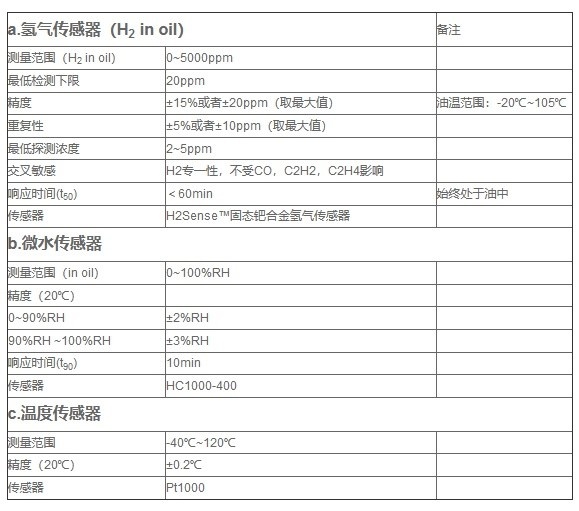

1. Ö÷ÒªÐÔÄÜÖ¸±ê

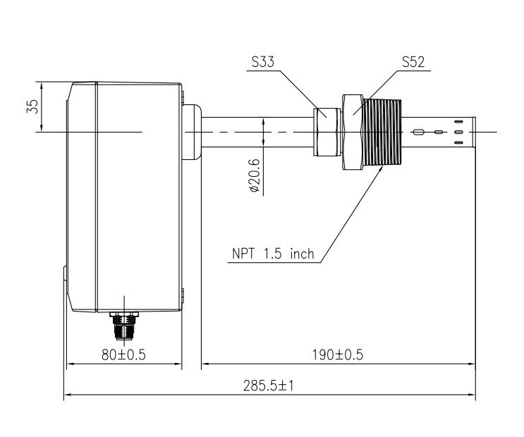

2. ½á¹¹³ß´ç
         MODEL3200ÐͱäѹÆ÷ÓÍÖÐÈܽâÇâºÍ΢ˮÔÚÏß¼à²â×°ÖÿÉʵÏÖ³äÓÍÉ豸ÈܽâÇâºÍ΢ˮÁ¿µÄÔÚÏß¼à²â¡£Î¢Ë®²âÁ¿²ÉÓÃHC1000-400ÐÍ΢ˮ´«¸ÐÆ÷£¬¿ÉÖ±½Ó²âÁ¿ÓÍÖÐÈܽâ΢ˮº¬Á¿¡£
1.Ö÷ÒªÐÔÄÜÖ¸±ê

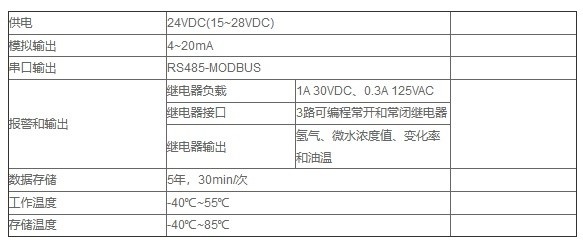

2. µçÆøÖ¸±ê¼°ÆäËû

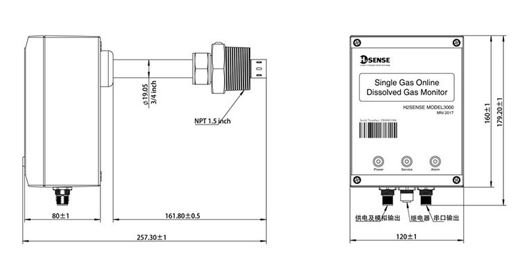

3. ½á¹¹³ß´ç
