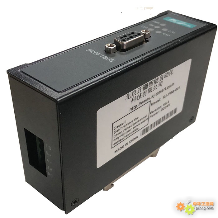

¿ª½®ÖÇÄÜMODBUSתPROFIBUSÍø¹Ø
¼ò½é£ºMODBUSתPROFIBUSЭÒéת»»Æ÷ÊÇ¿ª½®ÖÇÄÜÑз¢µÄÒ»¿îÕë¶ÔMODBUS½Ó¿ÚÉ豸½ÓÈëPROFIBUS×ÜÏßµÄЭÒéת»»Æ÷ÇÅ¡£ÔÚʵÏÖMODBUSתPROFIBUSЭÒéת»»¹ý³ÌÖУ¬¸ÃÍø¹ØÅäÖüòµ¥Áé»î£¬ÔËÐÐÊ®·ÖÎȶ¨£¬ÕæÕýʵÏÖÁËMODBUSתPROFIBUSЭÒéת»»µÄ¹¦ÄÜ¡£
MODBUSתPROFIBUSÄ£¿éµÄ»ù±¾ÐÅÏ¢:·²¾ßÓÐRS485½Ó¿ÚµÄMODBUSЭÒéÉ豸¶¼¿ÉÒÔʹÓñ¾²úƷʵÏÖÓëÏÖ³¡×ÜÏßPROFIBUSµÄ»¥Á¬¡£È磺¾ßÓÐMODBUSЭÒé½Ó¿ÚµÄ±äƵÆ÷¡¢µç»úÆô¶¯±£»¤×°Öá¢ÖÇÄܸߵÍѹµçÆ÷¡¢µçÁ¿²âÁ¿×°Öᢸ÷ÖÖ±äËÍÆ÷¡¢ÖÇÄÜÏÖ³¡²âÁ¿É豸¼°ÒDZíµÈµÈ, ¶¼¿ÉÒÔʹÓøÃMODBUSתPROFIBUSЭÒéת»»Æ÷¡£
Ïêϸ½éÉÜ£º
ÐͺţºKJ-PBG-001
¿ÉÒÔͨ¹ý²¦Â뿪¹ØÉ趨ΪÁ½ÖÖ¹¦ÄÜ£ºÔÚMODBUS²à×ö´ÓÕ¾£¨¼´MS¹¦ÄÜ£©£¬»òÕßÔÚMODBUS²à×öÖ÷Õ¾£¨¼´MM¹¦ÄÜ£©£¬ÊµÏÖMODBUSתPROFIBUS¡£
MODBUSתPROFIBUSЭÒéת»»Æ÷¼¼ÊõÖ¸±ê£º
£¨1£©Íø¹ØÔÚMODBUS²àÓÐÁ½ÖÖ¹¦ÄÜ£ºMM¹¦ÄܵÄÍø¹ØÔÚPROFIBUSÒ»²àÊÇ´ÓÕ¾£¬ÔÚMODBUSÒ»²àÊÇMODBUSÖ÷Õ¾£»MS¹¦ÄܵÄÍø¹ØÔÚPROFIBUSÒ»²àÊÇ´ÓÕ¾£¬ÔÚMODBUSÒ»²àÊÇMODBUS´ÓÕ¾£»½Ó¿Úͨ¹ýPROFIBUSͨÐÅÊý¾ÝÇøºÍMODBUSÊý¾ÝÇøµÄÊý¾ÝÓ³ÉäʵÏÖPROFIBUSºÍMODBUSµÄÊý¾Ý͸Ã÷ͨÐÅ¡£
£¨2£©ÎÞÂÛ×öMODBUSÖ÷Õ¾»¹ÊÇ´ÓÕ¾£¬¶¼Ö§³ÖMODBUS 01H¡¢02H¡¢03H¡¢04H¡¢05H¡¢06H¡¢0FH¡¢10HºÅ¹¦ÄÜ£»
£¨3£©PROFIBUSЭÒ飬·ûºÏ£»JB/T 10308.3-2001: ²âÁ¿ºÍ¿ØÖÆÊý×ÖÊý¾ÝͨÐŹ¤Òµ¿ØÖÆÏµÍ³ÓÃÏÖ³¡×ÜÏßµÚ3²¿·Ö£ºPROFIBUS¹æ·¶£»
£¨4£©±ê×¼PROFIBUSÇý¶¯½Ó¿Ú, ²¨ÌØÂÊ×ÔÊÊÓ¦£¬×î´ó²¨ÌØÂÊ12M£»
£¨5£©PROFIBUS ²àµÄÊäÈë/Êä³öÊýÁ¿ÔÚÒÔÏÂÈýÖÖ·¶Î§ÄÚ¿ÉÒÔÓÉÓû§×ÔÓÉÉ趨£º
¢ÙInput Bytes + Output Bytes ≤ 232 Bytes£»
¢Ú Max Input Bytes ≤ 224 Bytes£»
¢Û Max Output Bytes ≤224 Bytes¡£
£¨6£©±ê×¼RS-485½Ó¿Ú£¬°ëË«¹¤£¬²¨ÌØÂÊÔÚ 2400¡¢4800¡¢9600¡¢19.2K¡¢38.4K¡¢57.6K¿ÉÑ¡£»Ð£Ñéλ(ż¡¢Ææ¡¢ÎÞ)¿ÉÑ¡¡£
£¨7£©×î´óͨÐű¨Îij¤¶È£º·¢ËÍ230×Ö½Ú¡¢½ÓÊÜ230×Ö½Ú
£¨8£©¹©µç£º10—30VÖ±Á÷¿íѹ¹©µç£¬200mA
£¨9£©¹¤×÷»·¾³Î¶È: -20-65¡æ, ʪ¶È≤90%
£¨10£©°²×°£º35mmµ¼¹ì£¬»ú¿Ç¹æ¸ñ40x 110 x 74£¨mm£©
£¨11£©·À»¤µÈ¼¶£ºIP20¡£
