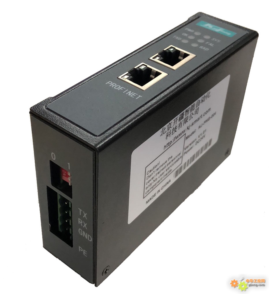

²úÆ·Ãû³Æ£º ¿ª½®ÖÇÄÜMODBUS232תPROFINETÍø¹Ø
ÐÍ ºÅ£º KJ-PNG-002
±¾Íø¹ØÐͺÅΪKJ-PNG-002£¬ÊµÏÖMODBUSתPROFINET¹¦ÄÜ£¬Äܹ»ÊµÏÖMODBUS½Ó¿ÚÒÇ±í¡¢±äƵÆ÷¡¢×Û±£¡¢ÈíÆô¶¯Æ÷µÈÉ豸½ÓÈëµ½S71500¡¢S71200¡¢CPU315-2PN/DP¡¢S7400µÈPROFINETÍøÂçϵͳ£¬ÊÇ´®¿ÚPROFINETÍø¹ØµÄÒ»ÖÖ¡£Íø¹ØÔÚPROFINETÒ»²àÊÇPROFINET´ÓÕ¾£¬ÔÚ´®¿ÚÒ»²àÎïÀí½Ó¿ÚÓÐRS-232£¬Ö§³ÖMODBUS/RTUÖ÷Õ¾»ò´ÓÕ¾¡£
MODBUSתPROFINETÍø¹ØÔÚMODBUSÒ»²à×öÖ÷վʱ£¬¿ÉÓÃÓÚÒ»¶Ô¶à¼¯³ÉMODBUS/232£¬ÐγÉMODBUS×ÓÍøÁ¬½Óµ½PROFINET£¬ÊµÏÖPROFINET¿ØÖÆÆ÷¼à¿ØMODBUSÉ豸µÄ¼¼ÊõÒªÇó¡£Íø¹ØMODBUSÒ»²à×ö´Óվʱ¿ÉÓÃÓÚ½«ÆäËûMODBUSÖ÷Õ¾£¨ÈçPLC/DCS£©ÒÔ¼°ËüµÄ´ÓÕ¾Êý¾Ý´«Êäµ½PROFINET¿ØÖÆÆ÷¡£±¾Íø¹Ø¼¼ÊõÔ­ÀíΪ´æ´¢Æ÷¹²ÏíÐÍ£¬²»ÐèÒªÖ÷Õ¾PLC/DCSµÄ±à³Ì£¬Ö»ÐèÔÚÖ÷Õ¾ÅäÖã¨ÈçSTEP7£©ÖжÔÍø¹ØMODBUS±¨ÎÄÅäÖü´¿ÉʵÏÖ×Ô¶¯Íø¹ØMODBUSÖ÷Õ¾µÄ×Ô¶¯·¢Ë͹¦ÄÜ¡£
MODBUSתPROFINETÍø¹ØÏà¹Ø²ÎÊý£º
1¡¢´®¿Ú¶ËÖ§³ÖµÄЭÒéÀàÐÍ£ºMODBUSÖ÷Õ¾¡¢MODBUS´ÓÕ¾¡¢×Ô¶¨ÒåЭÒéÒÔ¼°Í¨ÓÃģʽ£¨½ÓÊÕʽ¡¢ÎÊ´ðʽ£©£»
2¡¢´®¿Ú²ÎÊý£º
¢Ù¹¤×÷·½Ê½£º°ëË«¹¤£»
¢Ú²¨ÌØÂÊ£º300¡¢600¡¢1200¡¢2400¡¢4800¡¢9600¡¢19.2K¡¢38.4K¡¢57.6K¡¢115.2Kbps¿ÉÑ¡£»
¢ÛÊý¾Ýλ£º8λ£»
¢ÜУÑéλ£ºÎÞ¡¢Ææ¡¢Å¼¡¢±êÖ¾¡¢¿Õ¸ñ¿ÉÑ¡£»
¢Ýֹͣλ£º1¡¢2λ¿ÉÑ¡£»
3¡¢MODBUS£º
¢Ù¹¦ÄÜÂ룺01H¡¢02H¡¢03H¡¢04H¡¢05H¡¢06H¡¢0FH¡¢10HºÅ¹¦ÄÜ£»
¢Ú¸ñʽ£ºRTU¸ñʽºÍASCII¸ñʽ£»
¢Û¹¦ÄÜ£ºÐ´ÃüÁîÁ¬ÐøÊä³ö¡¢½ûÖ¹Êä³ö»ò·ê±äÊä³öµÄ¿ÉÑ¡Ôñ¹¦ÄÜ£»
¢Üÿ¸öÖ÷Õ¾×î¶à¿ÉÅäÖÃ48ÌõMODBUSÃüÁ
4¡¢¹©µç£º24VDC£¨11V~30V£©£»
5¡¢¹¤×÷»·¾³Î¶ȣº-20¡æ~60¡æ£»¹¤×÷»·¾³Êª¶È£º5% to 95%(ÎÞÄý¶)£»
6¡¢ÄÚÖþ²µç·À»¤£º15KV ESD£»Í¨ÐŶ˿ڸôÀ룺3KV£»
7¡¢»úе³ß´ç£º40mm£¨¿í£©×110mm£¨¸ß£©×74mm£¨É£»
8¡¢·À»¤µÈ¼¶£ºIP20£»
