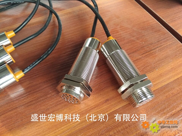

ËÄ¡¢ºêÎïÁªÔÚÏßʽÔëÉù´«¸ÐÆ÷¼ò½é
HB-NS502ÔÚÏßʽÔëÉù´«¸ÐÆ÷ÊÇHONSOR¸ù¾ÝÊг¡ÐèÇó¶ø¶©ÖÆ¿ª·¢µÄÒ»¿îÊý×ÖÔÚÏßʽ²âÁ¿ÉùÒôµÄ´«¸ÐÆ÷£»¸ù¾ÝÊг¡µÄ·¢Õ¹ºÍÐèÇóºêÎïÁª¶¨ÏòÑз¢µÄÒ»¿îÒÔ±ê×¼modbusͨѶÐÒéÊä³öµÄRS485ÐźÅÔÚÏßʽÔëÉù´«¸ÐÆ÷£¬¸ÃÔëÉù´«¸ÐÆ÷ÃÖ²¹ÁËÊг¡µÄ¿Õȱ£¬½â¾öÁËÈËÀàÔÚÉùÒôÁìÓò²âÁ¿µÄÎÊÌ⣬HB-NS502ÔÚÏßʽ´«¸ÐÆ÷¹ã·ºÓ¦ÓóÇÊл·¾³½¨É裬¹¤µØÔëÒôµÄ¼à²â£¬Ð¡ÇøÑ§Ð£ÔëÒôµÄÔÚÏß¼à²â¡£
ÔÚÏßʽÔëÉù´«¸ÐÆ÷
ÔÚÏßʽÔëÉù´«¸ÐÆ÷

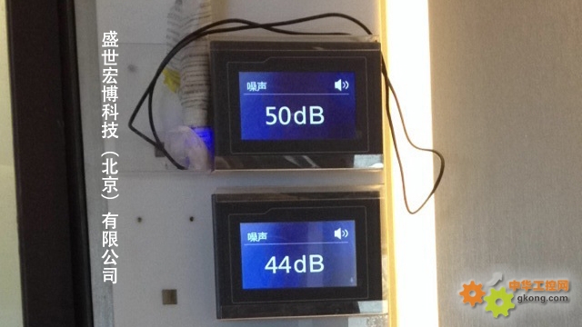

Æß¡¢ÔÚÏßʽÔëÉù´«¸ÐÆ÷Ó¦Óó¡ºÏ
ÔëÉù´«¸ÐÆ÷ÔÚÏßÏÔʾÆÁ
