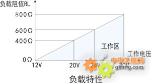

¹¤×÷µçѹ£º18¡«36VDC
Êä³öÐźţº4¡«20mA£¨¶þÏßÖÆ£©   1¡«5V£¨ÈýÏßÖÆ£©

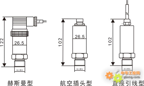

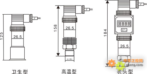

³ß´ç´óС

ÎÀÉúÐÍ¿¨¹¿Á¬½Ó
¸ßÎÂÐÍ(´øÉ¢ÈÈÆ¬)
