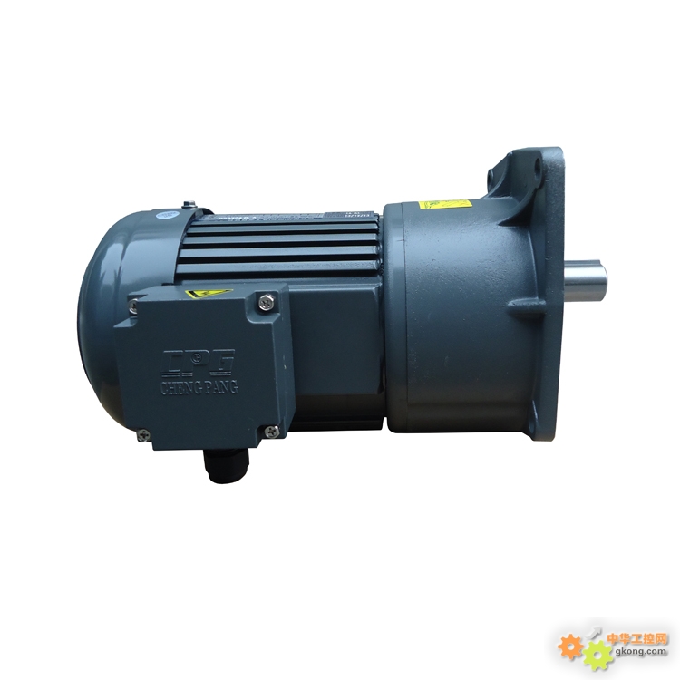

̨ÍåCPG³Ç°î³ÝÂÖ¼õËÙµç»ú ¹æ·¶ÈçÏ£º
»úÐÍ´úºÅ£ºCH(ÎÔʽÉ豸¡¢º¬µç»ú)CV£¨Á¢Ê½É豸¡¢º¬µç»ú£©CHM£¨ÎÔʽÈëÁ¦·¨À¼³ÝÂÖ¼õËÙ»ú¡¢×ÔÅä¸÷ÀàÂí´ï£©CVM£¨Á¢Ê½ÈëÁ¦·¨À¼³ÝÂÖ¼õËÙ»ú¡¢×ÔÅä¸÷ÀàÂí´ï£©CHD£¨ÎÔʽ˫Öá³ÝÂÖ¼õËÙ»ú£©CVD£¨Á¢Ê½Ë«Öá³ÝÂÖ¼õËÙ»ú£©¡£
µç»ú¹¦ÂÊ£º100w-3700w,ËÙ±È1£º3.5...1800£¨¿É¶¨×öËÙ±ÈΪ1£º10£¬1£º20ÕýÊý±È¼õËÙÆ÷£©
ÊÊÓõçѹ£º
ÈýÏà50HZ£¨220V/230V/240V/380V/400V/415V/440V£©
ÈýÏà60HZ £¨220V/240V/380V/415V/440V/460/480V600V£©
µ¥Ïà50HZ£¨ 110v/115v/200v/220V/230V£©
µ¥Ïà60HZ£¨ 110V/220V/240V£©
Ñ¡Å丽¼þ£ºDC-90Vɲ³µÆ÷¡¢SYBÊÖ¿ªÊÍɲ³µÆ÷¡¢Ç¿ÖƵçÉÈ¡¢µÈ
ÌØÕ÷¼°¹¦Óãº
ÏîÄ¿£ºÈýÏ๵ͨÂí´ï¡££¨µ¥Ï๵ͨÂí´ï£© ά»¤µÈ¼¶£ºÈ«ÃܱÕÍâÉÈÐÍIP-54¡£ £¨°ëÃܱÕÍâÉÈÐÍ£© Íâ¿Ç£º0.1-3.7KW,ÂÁºÏ½ð/Ìú¿Ç¡£ £¨0.1-1.5KWÂÁºÏ½ð/Ìú¿Ç£©
Ö÷ÕÅ·½·¨£ºÈ«Ñ¹Æð¶¯¡££¨0.1-0.2KW×÷ÒµµçÈÝÆð¶¯0.4-1.5KWÆð¶¯µçÈÝ+ÀëÐÄ¿ª¹Ø£©
¶¨¸ñ£ºÁ¬Ðø×÷Òµ¡£ ¾øÔµµÈ¼¶£ºF-¼¶¾øÔµ¡£ ÊÊÓû·¾³:ζÈ-10¡æTO+40¡æ£»Êª¶È90£¥ÒÔÏ¡£
ÊÊÓü«Êý£º2P¡¢4P¡¢6P¡¢8P¡£
Êä³öתÊý(4P)£º50HZ=1340-1400ת£»60HZ=1610-1740ת¡££¨50HZ=1360-1430ת£»60HZ=1640-1720ת£©
¸ù¾Ý¹æ·¶£º¹ú¼Ê/¹ú¼Ò¹æ·¶IEC-34,CNS-10919ACCORDKNG TO IEC-34,CNS-10919
º£°Î£º1000¹«³ßUNDER 1000 M
½ÓÏߺУºÑ¡ÓÃIP55¼¶·ÀË®ÐÍÂÁºÏ½ð½ÓÏߺÐ
²¿·ÖÀàÐÍÈçÏ£º
CH1/CV1  CH2/CV2  CH3/CV3  CH4/CV4  CH5/CV5  CH6/CV6
0.1KW£º
CH100-3S/CH100-5S/CH100-10S/CH100-15S/CH100-20S/CH100-25S/CH100-30S/CH100-40S
CH100-45S/CH100-50S/CH100-60S/CH100-70S/CH100-80S/CH100-90S/CH100-100S/CH100-120S
CH100-140S/CH100-150S/CH100-160S/CH100-180S/CH100-200S/CH100-250-1800S
0.2KW£º
CH200-3S/CH200-5S/CH200-10S/CH200-15S/CH200-20S/CH200-25S/CH200-30S/CH200-40S
CH200-45S/CH200-50S/CH200-60S/CH200-70S/CH200-80S/CH200-90S/CH200-200S/CH200-120S
CH200-140S/CH200-150S/CH200-160S/CH200-180S/CH200-200S/CH200-250-1800S
0.4KW£º
CH400-3S/CH400-5S/CH400-10S/CH400-15S/CH400-20S/CH400-25S/CH400-30S/CH400-40S
CH400-45S/CH400-50S/CH400-60S/CH400-70S/CH400-80S/CH400-90S/CH400-400S/CH400-120S
CH400-140S/CH400-150S/CH400-160S/CH400-180S/CH400-200S/CH400-250-1800S
0.75KW£º
CH750-3S/CH750-5S/CH750-10S/CH750-15S/CH750-20S/CH750-25S/CH750-30S/CH750-40S
CH750-45S/CH750-50S/CH750-60S/CH750-70S/CH750-80S/CH750-90S/CH750-750S/CH750-120S
CH750-140S/CH750-150S/CH750-160S/CH750-180S/CH750-200S/CH750-250-1800S
1.5KW£º
CH1500-3S/CH1500-5S/CH1500-10S/CH1500-15S/CH1500-20S/CH1500-25S/CH1500-30S/CH1500-40S
CH1500-45S/CH1500-50S/CH1500-60S/CH1500-70S/CH1500-80S/CH1500-90S/CH1500-100S/CH1500-120S
CH1500-140S/CH1500-150S/CH1500-160S/CH1500-180S/CH1500-200S/CH1500-250-1800S
2.2KW£º
CH2200-3S/CH2200-5S/CH2200-10S/CH2200-15S/CH2200-20S/CH2200-25S/CH2200-30S/CH2200-40S
CH2200-45S/CH2200-50S/CH2200-60S/CH2200-70S/CH2200-80S/CH2200-90S/CH2200-100S/CH2200-120S
CH2200-140S/CH2200-150S/CH2200-160S/CH2200-180S/CH2200-200S/CH2200-250-1800S
3.7KW
CH3700-3S/CH3700-5S/CH3700-10S/CH3700-15S/CH3700-20S/CH3700-25S/CH3700-30S/CH3700-40S
