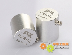

²úÆ·Ãû³Æ£º PXRϵÁÐгÕñʽ¸ßÁéÃô¶ÈÉù·¢Éä´«¸ÐÆ÷
ÐÍ ºÅ£º PXR15
PXRϵÁÐÉù·¢Éä´«¸ÐÆ÷¼¼Êõ²ÎÊýÒ»ÀÀ±í
ÐͺÅ
гÕñƵÂÊ(kHz)
10dB´ø¿í
ÁéÃô¶È(dB)
Íâ¹Û(mm)
Íâ¿Ç²ÄÁÏ
PXR50
500
300~1000
>60
§¶17×16
ÂÁºÏ½ð
¶¥½ÓÍ·´ø´ÅÎü¸½×°ÖÃ
PXR40
400
100~500
>65
§¶17×16
ÂÁºÏ½ð
²à½ÓÍ·´ø´ÅÎü¸½×°ÖÃ
PXR30
300
80~400
>60
§¶17×16
ÂÁºÏ½ð
²à½ÓÍ·´ø´ÅÎü¸½×°ÖÃ
PXR20
200
150~600
>60
§¶17×16
ÂÁºÏ½ð
²à½ÓÍ·´ø´ÅÎü¸½×°ÖÃ
PXR15I
150
100~400
>105
§¶30×35
²»Ðâ¸Ö
Á½ÏßÖÆ£¬BNC½Ó¿Ú£¬ÄÚÖÃǰ·Å
PXR15I3
150
100~400
>105
§¶30×35
ÂÁºÏ½ð
ÈýÏßÖÆ£¬²àÃæÒýÏߣ¬ÄÚÖÃǰ·Å
PXR15
150
100~400
>65
§¶18×18
²»Ðâ¸Ö
²à½ÓÍ·ÎÞ´ÅÎü¸½×°ÖÃ
PXR15RMH
150
100~400
>65
§¶25×18
²»Ðâ¸Ö
²à½ÓÍ·´ø´ÅÎü¸½×°ÖÃ
PXR07
70
40~100
>70
§¶22×25
ÂÁºÏ½ð
²à½ÓÍ·ÎÞ´ÅÎü¸½×°ÖÃ
PXR04AI
40
35~45
-44dB*
§¶30×50
ÂÁºÏ½ð
BNC¶¥²¿½Ó¿Ú£¬ÄÚÖÃǰ·Å¿ÕÆøñîºÏ´«¸ÐÆ÷
PXR04A
40
35~45
-44dB*
§¶30×32
ÂÁºÏ½ð
BNC¶¥²¿½Ó¿Ú£¬¿ÕÆøñîºÏ´«¸ÐÆ÷
PXR04I
40
30~140
>120
§¶30×55
²»Ðâ¸Ö
PXR04
40
30~140
>80
§¶22×25
²»Ðâ¸Ö   ÂÁºÏ½ð
²à½ÓÍ·ÎÞ´ÅÎü¸½×°ÖÃ
PXR03
30
20~110
>75
§¶22×25
ÂÁºÏ½ð
²à½ÓÍ·ÎÞ´ÅÎü¸½×°ÖÃ
PXR03RMH
30
20~110
>75
§¶25×20
ÂÁºÏ½ð
²à½ÓÍ·´ø´ÅÎü¸½×°ÖÃ
PXR02
20
10~70
>70
§¶22×33
ÂÁºÏ½ð
²à½ÓÍ·ÎÞ´ÅÎü¸½×°ÖÃ
PXR001
1
0.1~1.5
90mv/g
§¶29×117
ÂÁ+Í­
·ÀË®ÂñÈëʽ
