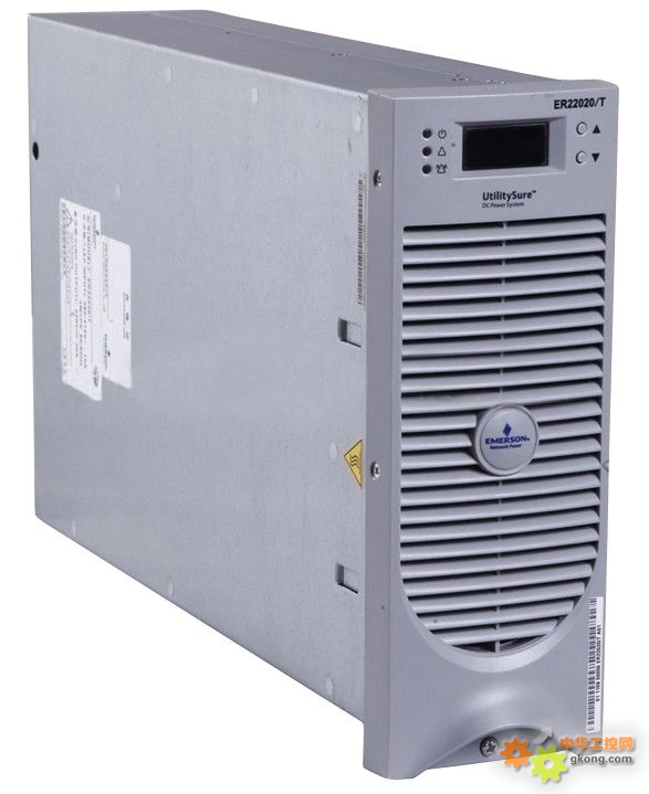

²úÆ·Ãû³Æ£º ER22020/TµçÔ´Ä£¿é
ÐÍ ºÅ£º ER22020/T
°¬Ä¬Éú³äµçÄ£¿éER22020/T ¼¼Êõ˵Ã÷
°¬Ä¬Éú³äµçÄ£¿éER22020/T£¬ER11040T5²ÉÓÃÏȽøµÄÒÆÏàгÕñ¸ßƵÈí¿ª¹ØµçÔ´¼¼ÊõºÍ·çÀäÉ¢ÈÈÉè¼Æ£¬²ÉÓÃÄÚÖÃCPU¼¯É¢Ê½¿ØÖÆ·½Ê½£¬¹¤×÷Îȶ¨¿É¿¿£¬Í¨¹ýCE°²¹æ¡¢µç´Å¼æÈݱê×¼ÈÏÖ¤£¬Í¨¹ý¹ú¼Ò¡¢ÐÐÒµ²úÆ·ÐÍʽ¼ìÑé¡£
1¡¢ ÈýÏàÈýÏßµçѹÊäÈ룬ÈýÏàµçÁ÷ƽºâ
2¡¢ ³¬¿íÊäÈëµçѹ·¶Î§£¨323¡«475V£©£¬ÊÊÓ¦µçÍøÄÜÁ¦Ç¿
3¡¢ ¶ÀÌØµÄȱÏàÏÞ¹¦ÂÊ£¨°ëÔØ£©Êä³öÉè¼Æ£¬Ê¹Ó÷¶Î§¸ü¿í
4¡¢ ²ÉÑùÓÐÔ´¹¦ÂÊÒòÊýУÕý¼¼Êõ£¬¸ß¹¦ÂÊÒòÊý£¬µÍг²¨º¬Á¿
5¡¢ Ôö¼Ó¹ÊÕÏ´úÂëÏÔʾ£¬·½±ã¹ÊÕϼì²é
6¡¢ ²ÉÓÃÈí¿ª¹Ø¼¼Êõ£¬Ð§Âʸߣ¬µç´Å¼æÈÝÐÔºÃ
7¡¢ ²ÉÓÃDSPÊý×Ö¿ØÖƼ¼Êõ£¬CAN×ÜÏßͨѶ½Ó¿Ú£¬¸ß¹¦ÂÊÃܶÈÉè¼Æ
8¡¢ ¿É´øµç²å°Î£¬ÔÚÏßά»¤£¬·½±ã¿ì½Ý
9¡¢ ·çÀäÉè¼Æ£¬²ÉÓÃζȺ͵çÁ÷ÁªºÏÖÇÄÜ¿ØÖÆ·çÉÈÎÞ¼¶µ÷ËÙ 10¡¢ ³¬¿í¹¤×÷ζȷ¶Î§£¬»·¾³ÊÊÓ¦ÐÔÇ¿ 11¡¢ ͨ¹ýCE°²¹æEN60950-1¡¢µç´Å¼æÈÝEN55022 Class A±ê×¼ÈÏÖ¤£¬·ûºÏÅ·ÃËRoHSÖ¸Á°²È«ÂÌÉ«»·±££»
¼¼Êõ²ÎÊý£º
ÊäÈëµçѹ£¨V£©£º260¡«530£¨ÈýÏàÈýÏߣ©£¬
ÊäÈëµçÁ÷£¨A£©≤15£¬
½»Á÷ÊäÈëÆµÂÊ£¨Hz£©£º45¡«65£¬
ЧÂÊ≥92£¥£¬
¹¦ÂÊÒòÊý≥0.99£¬
ÊäÈë×Üг²¨º¬Á¿≤5%£¬
Êä³öµçѹ·¶Î§£¨V£©£º
220VdcϵÁУº176¡«320£¬110VdcϵÁУº88¡«160
£¨ER11040T5£º64~160Vdc£©£¬
¶î¶¨Êä³öµçÁ÷£¨A£©£º20    ×î´óÊä³öµçÁ÷£¨A£©22£¬
110VdcϵÁжÊä³öµçÁ÷£¨A£©£º40£¬
×î´óÊä³öµçÁ÷£¨A£©44£¬
ÈíÆô¶¯Ê±¼ä(S)3¡«8£¬
Êä³öºãÁ÷·¶Î§10£¥¡«110£¥£¬
ÎÈÁ÷¾«¶È≤±0.5£¥£¬
ÎÆ²¨ÏµÊý≤0.1£¥£¬
ÎÈѹ¾«¶È≤±0.5£¥£¬
¾ùÁ÷²»Æ½ºâ¶È≤±5£¥£¬£¨µäÐÍÖµ3£¥£¬50£¥¡«100£¥¶î¶¨¸ºÔØ£©£¬
ÒôÏìÔëÒô(dB)<55£¬
±£»¤ÌØÐÔ, Êä³ö¶Ì·±£»¤£º110%Ir£¬
¿É×Ô»Ö¸´£¬Êä³ö¹ýѹ±£»¤£º
±£»¤ºóÎÞÊä³ö, ²»¿É»Ö¸´£¬Êä³öǷѹ±£»¤£º
±£»¤ºóÓÐÊä³ö£¬¿É»Ö¸´£¬ÊäÈë¹ýѹ±£»¤£º
±£»¤ºóÎÞÊä³ö£¬¿É»Ö¸´£¬ÊäÈëǷѹ±£»¤£º
±£»¤ºóÎÞÊä³ö£¬¿É»Ö¸´£¬È±Ïà±£»¤£º
ÏÞ¹¦ÂʰëÔØÊä³ö£¬¹ýα£»¤£º
±£»¤ºóÎÞÊä³ö£¬¿É»Ö¸´£¬·çÉÈζȿØÖÆ£º
ζȺ͵çÁ÷ÁªºÏ¿ØÖÆ·çÉÈת¶¯£¬
°²¹æ£º·ûºÏEN60950-1¼°GB/T19826-2005ÒªÇó£¬
EMC£º·ûºÏEN55022 Class A¼°GB/T19826-2005ÒªÇó£¬RoHS£º
·ûºÏÅ·Ã˺ÍÖйúRoHSÖ¸ÁMTBF(h£©>300£¬000£¬
¹¤×÷ζÈ(¡æ), -40¡«+65£¬
´¢´æÎ¶È(¡æ)£º£­40¡«+70£¬
Ïà¶Ôʪ¶È≤95£¥£¬
´óÆøÑ¹Á¦(kPa)£º70¡«106£¬
»úе²ÎÊý, ³ß´ç£¨¸ß׿í×É£¨mm£©£º242×88×388£¬
ÖØÁ¿(kg)£º8£¬ÀäÈ´·½Ê½£º
·çÀ䣬·À³¾Éè¼Æ¡£
