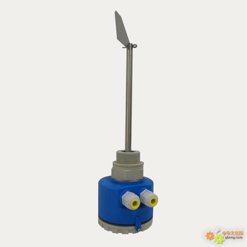

²úÆ·Ãû³Æ£º ×èÐýÁÏλ¿ª¹ØFTE30-FAB1µÂ¹úE+H
ÐÍ ºÅ£º FTE30-FAB1
Soliswitch FTE30ÏÞλ¿ª¹Ø ×èÐýʽÎïλ¿ª¹Ø
E+H¶÷µÂ˹ºÀ˹×èÐýÎïλ¼ÆFTE30-FAB1ÔÚÍâÐÎÉè¼ÆÉϺܼòµ¥£¬ÊÇÒ»ÖÖ»úе½á¹¹£¬¼«Æä¼á¹Ì¡¢¾­¼ÃµÄ¹ÌÌåÉ¢ÁÏÏÞλ¿ª¹Ø£¬¼á¹ÌµÄ¾ÛºÏÎïÍâ¿ÇºÍÒ»Ì廯½á¹¹Ê¹Æä³ÉΪ¼ì²â¹ÌÌåÉ¢ÁÏÂú²Ö¡¢¿Õ²ÖÒÔ¼°±¨¾¯µÄÀíÏë´«¸ÐÆ÷¡£ÒDZí²ÉÓÃÓÅ»¯µÄ¾ÛºÏÎï²ÄÖÊ£¬½á¹¹Àι̣¬ÊÊÓÃÓÚ·Û³¾±¬Õ¨Î£ÏÕÇøÓò¡£
E+H¶÷µÂ˹ºÀ˹×èÐýÎïλ¼ÆFTE30-FAB1ÓÅÊÆ
•  ¿É¿¿¡¢¾­¼ÃµÄ×èÐýʽ¿ª¹Ø
•  ×î¸ß°²È«±ê×¼
•  ³ÉÊìµÄ²âÁ¿Ô­Àí
•  »¬¶¯ÀëºÏÆ÷
•  ·À»¤µÈ¼¶IP65
•  ·Û³¾20Çø
E+H¶÷µÂ˹ºÀ˹×èÐýÎïλ¼ÆFTE30-FAB1Ó¦ÓÃÁìÓò
•  ¹ý³ÌÁ¬½Ó£ºG 1½", PBT; G 1½", 1.4305; Reinforced shaft G 1½", 1.4305
•  ´«¸ÐÆ÷³¤¶È£º½éÓÚ 100 mm (4") ºÍ 600 mm (24") Ö®¼äµÄ²»Í¬±ê×¼³¤¶È£¬ÀÂÉþÑÓÉ쳤¶È 2,000 mm (80")£¨¿Éµ÷½Ú£©
•  ζȣº-20...+80 °C (-4...+170 °F)
•  ѹÁ¦£º0.5...1.8 bar (7...25 psi)
E+H¶÷µÂ˹ºÀ˹×èÐýÎïλ¼ÆFTE30-FAB1ÌØÕ÷ºÍ¹æ¸ñ
²âÁ¿Ô­Àí
×èÐýÎïλÒÇ
ÌØµã/Ó¦ÓÃ
ͨÓÃÐÍ£¬¹ÌÌåÁϲֵÄÂú¹Þ¡¢¿Õ¹ÞºÍ±¨¾¯¼ì²â
ÌØµã
·À»¤ÕֵĽÂÁ´Í·
µçÔ´/ͨÐÅ
230 VAC 50/60 Hz£¬115 VAC 50/60 Hz£¬48 VAC 50/60 Hz£¬24 VAC 50/60 Hz£¬20 ... 28 VDC
»·¾³Î¶È
-20…+60¡æ£¨176¨H£©
¹ý³ÌζÈ
-20…80¡æ
¹ý³ÌѹÁ¦£¨¾øÑ¹£©/×î´ó¹ýѹÏÞ¶¨Öµ
0,5 bar ... 1,8 bar
½éÖʵÄ×îСÃܶÈ
>= 100 g/l
Ö÷Òª½ÓÒº²¿¼þ
»¤Ì×£º1.4305£»Ðýת̽ͷ£º1.4305
¹ý³ÌÁ¬½Ó
G 1 1/2, PBT£¬G 1 1/2, 1.4305£¬ÔöÇ¿»¤Ì×G 1 1/2, 1.4305
´«¸ÐÆ÷³¤¶È
100 mm¡¢200 mm¡¢300 mm¡¢400 mm¡¢500 mm¡¢600 mm£»Ì½Í·Àµij¤¶ÈÔ¼2000 mmÇҿɽضÌ
ͨÐÅ
Êä³ö£º¿É½»»»´¥µã¿ª¹ØÊä³ö£¬×î´ó10 A/250 VAC
Ö¤Êé/ÈÏÖ¤
·Û³¾·À±¬Çø10£¬ATEX 1/3D IP65 T110¡æ
Ñ¡Ïî
¼ÌµçÆ÷
Ó¦ÓÃÏÞÖÆ
×î´ó¾§Á£Îª50mm
