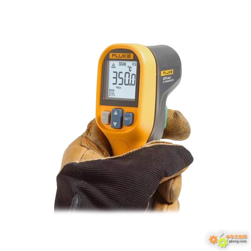

MT4 MAX/MT4 MAX+ºìÍâ²âÎÂÒǸÅÊö
¸£Â»¿ËÊDzâÊÔ¹¤¾ßÐÐÒµµÄÁìÏÈÕߣ¬Æ¾½è 65 ÄêµÄרҵ¾­Ñ飬Éú²ú³öÁË MT4 MAX¡¢MT4 MAX+ ºìÍâ²âÎÂÒÇ¡£ÒÇÆ÷µÄ¾«¶ÈÄÜÈ·±£²âÁ¿µÄ׼ȷÐÔ£¬¶øÇÒ¼Û¸ñÒ²·ûºÏÄúµÄÔ¤Ë㷶Χ¡£¸Ã¿îÇáÇɵÄСÐͺìÍâ²âÎÂÒÇÄܹ»³ÐÊÜ 1 Ã׵ĵøÂä³å»÷£¬Òò´ËÄú¿É·ÅÐÄʹÓá£
MT4 MAX/MT4 MAX+ºìÍâ²âÎÂÒÇÌØµã
1¡¢²ÉÓþ«Ãܼ¤¹â¼¼Êõ£¬Ê¹²âÁ¿¸ü׼ȷ²¢¿ÉÖØ¸´²âÁ¿
2¡¢´ø±³ÕյƵĠLCD ´óÐÍÏÔʾÆÁ±ãÓÚÓû§²é¿´ºÍ¶ÁÈ¡ÐÅÏ¢
3¡¢ÇáÐÍСÇɵÄÉè¼Æ±ãÓÚ½«ÒÇÆ÷×°È빤¾ßÏä
4¡¢MT4 MAX: 8:1 µÄ¾àÀëÓë¹âµã³ß´ç±È
5¡¢MT4 MAX+: 10:1 µÄ¾àÀëÓë¹âµã³ß´ç±È
6¡¢IP40 ·À»¤µÈ¼¶Ìṩ¶îÍâµÄ±£»¤
7¡¢ÏÔʾ×îС¡¢×î´ó»òƽ¾ùζȣ¬»òÁ½´Î²âÁ¿ÖµÖ®¼äµÄ²îÖµ
8¡¢¸ßκ͵Íξ¯±¨£¬¿É¿ìËÙÏÔʾ³¬³öÏÞÖÆµÄ²âÁ¿Öµ
9¡¢µçԴΪһ (1) ½Ú AA µç³Ø
10¡¢Ò»Äê±£ÐÞ
MT4 MAX/MT4 MAX+ºìÍâ²âÎÂÒDzÎÊý
¹æ¸ñ
ζȷ¶Î§
MT4 MAX:   -30 °C ÖÁ 350 °C£¨-22 °F ÖÁ 662 °F£©
MT4 MAX+: -30 °C ÖÁ 400 °C£¨-22 °F ÖÁ 752 °F)
¾«¶È£¨»·¾³Î¶ÈΪ 23 °C ± 2 °C ʱµÄ¼¸ºÎУÕý£©
≥ 0 °C£º
MT4 MAX:   ¶ÁÊý ± 2.0 °C »ò ± 2.0 %£¬È¡½Ï´óÖµ
MT4 MAX+: ¶ÁÊý ± 1.5 °C »ò ± 1.5 %£¬È¡½Ï´óÖµ
≥-10 °C ÖÁ <0 °C£º
± 2.0 °C
< -10 °C£º
± 3.0 °C
≥ 32 °F£º
MT4 MAX:   ¶ÁÊý ± 4.0 °F »ò ± 2.0 %£¬È¡½Ï´óÖµ
MT4 MAX+: ¶ÁÊý ± 3.0 °F »ò ± 1.5 %£¬È¡½Ï´óÖµ
≥ 14 °F ÖÁ < 32 °F£º
± 4.0 °F
< 14 °F£º
± 6.0 °F
ÏìӦʱ¼ä£¨95 %£©
<500 ms£¨¶ÁÊýµÄ 95 %£©
¹âÆ×ÏìÓ¦
8 mm ÖÁ 14 mm
·¢ÉäÂÊ
0.10 ÖÁ 1.00
¾àÀëÓë¹âµã³ß´ç±È
10:1£¨ÔÚÄÜÁ¿Îª 90 % ʱ¼ÆËãËùµÃ£©
ÏÔʾÆÁ·Ö±æÂÊ
0.1 °C (0.2 °F)
¿ÉÖØ¸´ÐÔ£¨¶ÁÊýµÄ %£©
MT4 MAX:   ¶ÁÊýµÄ ± 1.0 % »ò ±1.0 °C
(±2.0 °F)£¬È¡½Ï´óÖµ
MT4 MAX+: ¶ÁÊýµÄ ± 0.8 % »ò ±1.0 °C
(±2.0 °F)£¬È¡½Ï´óÖµ
µçÔ´
1 AA IEC LR06 µç³Ø
µç³ØÊÙÃü
¿ªÆô¼¤¹âºÍ±³¹âʱΪ 12 Сʱ
ÖØÁ¿
220 g (7.76 oz)
³ß´ç
(156 x 80 x 50) mm (6.14 x 3.15 x 2) in
¹¤×÷ζÈ
0 °C ÖÁ 50 °C£¨32 °F ÖÁ 122 °F£©
´æ·ÅζÈ
-20 °C ÖÁ +60 °C£¨-4 °F ÖÁ 140 °F£©£¬ÎÞµç³Ø
¹¤×÷ʪ¶È
10 % - 90 % Ïà¶Ôʪ¶È£¬30 °C (86 °F) ʱÎÞÀäÄý
¹¤×÷º£°Î
ƽ¾ùº£°Î 2000 m
´æ·Åº£°Î
ƽ¾ùº£°Î 12000 m
µøÂä²âÊÔ
1 m
·À»¤µÈ¼¶£¨IP£©
IEC 60529 ¹æ¶¨µÄ IP40
Õ𶯺ͳå»÷
IEC 68-2-6 2.5 g, 10 ÖÁ 200 Hz, IEC 68-2-27, 50 g, 11 ms
ºÏ¹æ
EN/IEC 61010-1
¼¤¹â°²È«
FDA ºÍ EN 60825-1 ¶þ¼¶
µç´Å¼æÈÝÐÔ±ê×¼
61326-1 EN 61326-2
