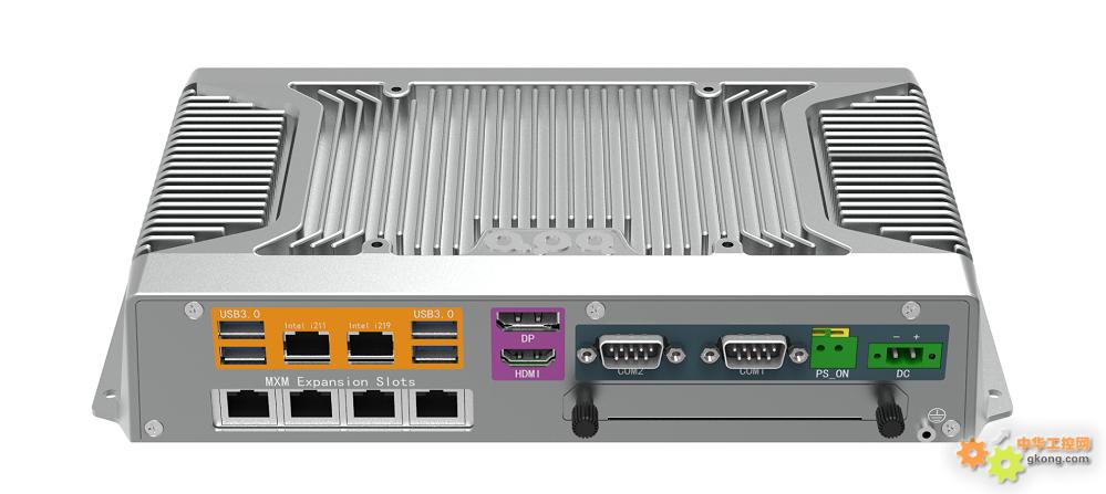

E8Êǰ¢ÆÕÆæ»ùÓÚʵʱÔËËã¡¢¶àÈÎÎñÔËËã¡¢¶à½Ó¿ÚÐÅÏ¢²É¼¯µÈÓ¦ÓÃÐèÇ󿪷¢µÄµÍ¹¦ºÄ¡¢¸ßÐÔÄÜ¡¢¶àI/O¡¢ÎÞ·çÉȽô´ÕÐÍǶÈëʽµçÄÔ¡£Õû»ú»ùÓÚIntel Skylake-UºÍCeleronµÍ¹¦ºÄƽ̨¿ª·¢£¬¼ÓÈëCPUÄ£¿é»¯Éè¼Æ¡¢I/OÄ£¿é»¯Éè¼Æ¡¢Ä£¾ß»¯Éè¼Æ¡¢¿íѹºÍI/O·À»¤Éè¼Æ£¬ÔÚ±£Ö¤É豸¸ßÆ·ÖʵÄͬʱ£¬½µµÍÉ豸Ìå»ý¡¢²¢ÌáÉýÉ豸ÐÔÄܺÍI/OµÄÀ©Õ¹ÐÔ£¬ÒÔÂú×㹤ҵ4.0¿ØÖÆ¡¢»úÆ÷ÈË¡¢ÖÇÄܽ»Í¨¡¢»úÆ÷ÊÓ¾õµÈ¿ìËÙÏÖ³¡×ÜÏßÐÐÒµÐèÇó¡£

➤ Intel µÚ6/7® Skylake-UϵÁУ¬CeleronTM/i3/i5ÒÆ¶¯´¦ÀíÆ÷
➤ CPUÄ£¿é»¯Éè¼Æ£¬ÎÞ·çÉÈÉ¢ÈÈÉè¼Æ
➤ 4¸öÔ­Éú¸ßËÙUSB3.0
➤ 2~6 Intel˫ǧÕ×ÍøÂ磨֧³ÖJumboFrameºÍEtherCAT£©
➤ ȫп¹ÕðÐͳéÀ­2.5inchÓ²Å̲֣¬Í¬Ê±Ö§³ÖmSATA SSD
➤ ¶àÖÖÀ©Õ¹·½Ê½£º2*miniPCIE¡¢16*DIO (Optional)£¬MXM(APQ)
➤ 2*COM£¬Ö§³ÖRS232/RS485£¨¸ôÀ룩
➤ 12~28V DC¿íѹÊäÈë
➤ -20¡æ~60¡æ¿íι¤×÷
➤ ¼æÈÝP series ÏÔÊ¾Ãæ°å£¬ÐγÉ12~21 inch P series -E8ƽ°åµçÄÔ

ÎÒÃÇÔÚÄ£¿é»¯µÄ»ù´¡ÉÏÉîÈ빤ҵµçÄÔºËÐIJ¿¼þ£¬½«Õû»ú²ð·Ö³ÉCPUºËÐÄÄ£¿é¡¢ÔذåÄ£¿é¡¢aDoorÄ£¿é¡¢MXMÄ£¿é£¬½øÒ»²½ÌáÉý²úÆ·µÄЧÂʺÍά»¤ÐÔ£¬ÎªÐÐÒµ²úÆ·µÄODMÌṩ¸üºÃµÄ¼¼Êõƽ̨£¬¿ÉʵÏÖ4ǧÕ×ÍøÂç¡¢16·¸ßËÙGPIO¡¢´®¿Ú¡¢CAN¡¢USBµÈ½Ó¿ÚµÄ¶îÍâÀ©Õ¹£¬Óë´Ëͬʱ£¬ÎÒÃÇ»¹¿Éͨ¹ý2ÕÅmini PCIEͬʱÀ©Õ¹4G¡¢WiFi¡¢BTµÈ¹¦ÄÜ£¬ÒÔʵÏÖ²»Í¬ÐÐÒµµÄ¿ìËÙ±ê×¼»¯Ó¦Óã¬ÌáÉý²úÆ·Æ·ÖʺÍЧÂʵÄͬʱ£¬Ëõ¶ÌÏîÄ¿ÖÜÆÚ¡£
2¡¢µÍ¹¦ºÄ¸ßÐÔÄܵĴ¦ÀíÆ½Ì¨
Õû»ú²ÉÓõÄIntel SkylakeµÚÁù´ú΢´¦ÀíÆ÷¼Ü¹¹£¬²ÉÓÃ14ÄÉÃ×ÖÆ³Ì£¬ÊÇIntel Haswell΢¼Ü¹¹¼°ÆäÖÆ³Ì¸Ä½ø°æIntel Broadwell΢¼Ü¹¹µÄ¼ÌÈÎÕß¡£ÔÚ±£Ö¤Õû»ú¾ßÓнϵ͹¦ºÄµÄͬʱ²úÉú¸üÇ¿µÄÔËËãÄÜÁ¦£¬Í¬Ê±¼æ¹Ë¶ÔÎÞÏßÏÔʾºÍ¸ßÐÔÄÜÏÔ¿¨µÄÐèÇó¡£
3¡¢±³ÌùÎÞ·çÉÈÉ¢ÈÈϵͳ
ÈÈÁ¿ÊÇÈκεç×Ó²úÆ·µÄÀÏ»¯´ß»¯¼Á£¬³¤Ê±¼ä¶Ñ»ýµÄ·¢ÈÈÎÊÌ⣬¶¼»áÓ°ÏìÔªÆ÷¼þµÄʹÓÃÊÙÃü¡£¼õÉÙÈÈ·øÉä¶ÔÖܱߵÄÓ°Ïì¼°¿ìËÙʹÈÈÁ¿É¢·¢£¬ÊÇËùÓÐϵͳɢÈÈÉè¼ÆËù×ñÑ­µÄ»ù±¾Ô­Ôò¡£ÎªÁË×î´óÏ޶ȽµµÍÈÈÁ¿´«µÝ·³ÌºÍÔö´ó¿ÕÆøÉ¢ÈÈÃæ»ý£¬ÎÒÃDzÉÓÃCPUÁã¾àÀëÓëÏȽøÈȹܿìËÙÉ¢ÈÈ·½Ê½£¬Ê¹Ð¾Æ¬µ¼ÈÈ×°ÖÃÓëÖ÷»úÍâ¿ÇÈÜÓÚÒ»Ì壬¸ü¿¹Õð£¬ÈÈËð¸üµÍ£¬¶Ì¾àÀë¿ìËÙÉ¢ÈÈ£¬ÓÐЧ±£Ö¤²úÆ·µÄ³¤ÊÙÃüÎȶ¨ÔËÐС£
4¡¢³¬¸ßËÙ´«ÊäÄÜÁ¦
ΪÁ˸üºÃµÄÂú×㹤ҵÏÖ³¡¶ÔÊý¾Ý²É¼¯µÄ¸ßÖÊÁ¿ÒªÇó£¬ÎÒÃÇΪE8Æ¥ÅäÁË4·ԭÉúUSB3.0£¬ÒÔ¼°×î´óÖ§³Ö6¸ö¶ÀÁ¢µÄIntel 10/100/1000 Ethernet£¬Ö§³Ö9K JumboFrameºÍEtherCAT£¬´«ÊäЧÂÊÌáÉý50%ÒÔÉÏ¡£
5¡¢È«Ä£¾ß»¯ÖÆÔ칤ÒÕ
ÔÚ±£Ö¤E8½á¹¹Ç¿¶È¡¢³ß´ç¾«È·¶Èͬʱ£¬ÎªÊ¹Æä¾ßÓÐÓÅÐãµÄ³ÉÐÍÓë×ÅÉ«ÐÔÄÜ£¬ÌáÉýÉú²úЧÂÊ£¬ÎÒÃÇΪ´ËÆ¥ÅäÁËȫģ¾ßÖÆÔ칤ÒÕ£¬ÒÔ´ïµ½ÔÚʵ¼ÊµÄ¹¤ÒµÏÖ³¡Ó¦ÓÃÖУ¬³Ö¾Ã¿¹ÀÏ»¯µÄ×÷Óá£
6¡¢¸üÎȶ¨µÄ²Ù×÷ϵͳ
Windows Embedded²Ù×÷ϵͳ£¬ËüÌṩÁËÒµÄÚÁìÏȵĿɿ¿ÐÔ¡¢°²È«ÐÔºÍÐÔÄÜ¡£ÆäÁé»îµÄǶÈëÐÔÄܸüÊÊÓÃÓÚ¸÷µÍ¹¦ºÄ²úÆ·µÄ¿ª·¢ÓëÔËÐС£FBWF»ùÓÚÎļþµÄд±£»¤¹ýÂË£¬ÔÚ»º´æ£¨Äڴ棩ÖжÔËùÓÐÎļþ½øÐÐд²Ù×÷£¬²»µ«ÄÜÈÃϵͳÔÚÆµ·±µÄ·Ç·¨¶ÏµçÖÐÎȶ¨ÔËÐУ¬·ÀÖ¹²¡¶¾µÄÇÖº¦£¬»¹ÄÜÑÓ³¤´æ´¢É豸µÄʹÓÃÊÙÃü£¬´ïµ½Ò»´ÎÖ²ÈëÓÀ¾ÃʹÓá£
7¡¢³¬¿íѹµÄÊäÈ뷽ʽ
´ÓµÚÈý´Î¹¤Òµ¸ïÃü·¢Õ¹ÒÔÀ´£¬ÏµÍ³¸ß¶È¼¯³É·¢Õ¹£¬¶ø¸÷É豸˲¼äµÄÆô¶¯£¬¶¼»áµ¼ÖµçѹµÄ²»Îȶ¨£¬Ò²»á´øÀ´ÎÉÂÒÆµÂʵĸÉÈÅ£¬Òª±£Ö¤É豸µÄÎȶ¨ÔËÐм°¶ÔµçÍøµÄµÍ¸ÉÈÅ£¬Ö§³ÖEMI¹æ¸ñµÄ¿íµçѹÊäÈëÏÔµÃÓÈÎªÖØÒª£¬Òò´Ë£¬ÎÒÃÇΪǶÈëʽµçÄÔE8Æ¥ÅäÁËDC12~28VÊäÈ룬²¢¼¯³ÉÁ˹ýÁ÷¡¢¹ýѹºÍ·´½Ó±£»¤µÈ´ëÊ©¡£
