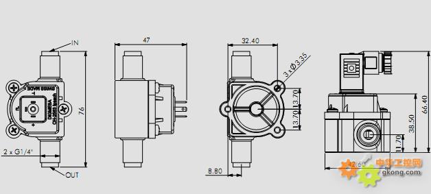

938Á÷Á¿·¶Î§±í£º0.04£­0.6L/MIN 1mm
938Á÷Á¿·¶Î§±í£º0.05£­0.80L/MIN 2mm
938Á÷Á¿·¶Î§±í£º0.10£­2.40L/MIN 3mm
938Á÷Á¿·¶Î§±í£º0.15£­3.80L/MIN 4mm
938Á÷Á¿·¶Î§±í£º0.30£­9.30L/MIN 6.3mm
938Á÷Á¿·¶Î§±í£º1.40£­18.00L/MIN 7mm
938Á÷Á¿·¶Î§±í£º3.00£­30.00L/MIN 10mm
FHKU 938-1510-01Á÷Á¿·¶Î§£º0.041£­0.6 L/MIN 1.0MM G1/4ÍâÑÀ
FHKU 938-8515-01Á÷Á¿·¶Î§£º0.042£­1.25L/MIN 1.5MM G1/4ÍâÑÀ
FHKU 938-1520-01 Á÷Á¿·¶Î§£º0.091£­2.4 L/MIN 2.0MM G1/4ÍâÑÀ
FHKU 938-1530-01 Á÷Á¿·¶Î§£º0.10£­2.40L/MIN 3.0MM G1/4ÍâÑÀ
FHKU 938-1540-01Á÷Á¿·¶Î§£º0.123£­8.38 L/MIN 4.0MM G1/4ÍâÑÀ
FHKU 938-2540-01Á÷Á¿·¶Î§£º0.123£­8.38 L/MIN 4.0MM G1/4ÍâÑÀ
FHKU 938-7540-01Á÷Á¿·¶Î§£º0.123£­8.38L/MIN 4.0MM G1/4ÍâÑÀ
FHKU 938-1856-01Á÷Á¿·¶Î§£º0. 30£­9.30 L/MIN 5.6MM G1/4ÍâÑÀ
FHKU 938-3570-01Á÷Á¿·¶Î§£º1.4£­18L/MIN 7.0MM G1/4ÍâÑÀ
FHKU 938-6300-01Á÷Á¿·¶Î§£º0.30£­30 L/MIN 10MM G1/2ÍâÑÀ
FHKU 938-6500-01Á÷Á¿·¶Î§£º3.0£­30L/MIN 10MM G1/2ÍâÑÀ
FHKU 938-6800-21Á÷Á¿·¶Î§£º1.4£­18L/MIN 10MM G1/2ÍâÑÀ 21Ϊ´øÏÔʾ

937ϵÁÐÐͺţºNozzle£¨Åç×죩Âö³åplMin£¨Ð¡Á÷Á¿£©lmMax£¨´óÁ÷Á¿£©lm
1.0mmϵÊý2063СÁ÷Á¿0.0410´óÁ÷Á¿0.5670
1.2mmϵÊý1700СÁ÷Á¿0.0505´óÁ÷Á¿0.8225
1.5mmϵÊý1314СÁ÷Á¿0.0427´óÁ÷Á¿1.2504
2.0mmϵÊý988СÁ÷Á¿0.0911´óÁ÷Á¿2.4055
2.5mmϵÊý760СÁ÷Á¿0.1503´óÁ÷Á¿3.7478
3.0mmϵÊý565СÁ÷Á¿0.1022´óÁ÷Á¿5.6310
4.0mmϵÊý381СÁ÷Á¿0.1235´óÁ÷Á¿8.3893
5.6mmϵÊý236СÁ÷Á¿0.3088´óÁ÷Á¿9.2647
ѹÁ¦·¶Î§£º´ó20.0bars
ζȷ¶Î§£º-10¡«65¡æ
²âÁ¿¾«¶È£º±1%
ÈÏÖ¤£ºNSF¡¢CE
²ÄÁÏ£ºPBT£¨Arnite£©¡¢PPS(Ryton)¡¢PVDF¡¢PA(Grivory)
FHKU938-650001-GB Arnite²ÎÊý±í
Nozzle£¨Åç×죩l/m10.0mmÂö³åpl¡¡¡¡65Min£¨Ð¡Á÷Á¿£©3.00Max£¨´óÁ÷Á¿£©lm¡¡30.00
