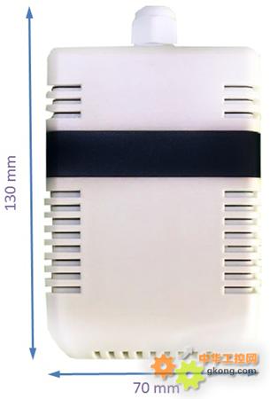

¡ù ²úÆ·ÌØµã
KZCD-10¶þÑõ»¯Ì¼±äËÍÆ÷²ÉÓÃ˫ͨµÀ·ÇɫɢºìÍâÆøÌå¼ì²â¼¼Êõ¼ì²âÔ­Àí£¬ÄÚÖÃζȲ¹³¥¹¦ÄÜ£¬¾ßÓиßÁéÃô¶È¡¢ÎÞÑõÆøÒÀÀµÐÔ¡¢Ê¹ÓÃÊÙÃü³¤¡¢²âÁ¿¾«¶È¸ß¡¢Îȶ¨ÐԺá¢Öظ´ÐԺᢲâÁ¿·¶Î§¿í²»ÊÜÆäËü±³¾°ÆøÌ壨CH4¡¢H2S¡¢SO2¡¢N2¡¢O2 µÈ£©Ó°ÏìµÈÌØµã¡£¿É¹ã·ºÓÃÓÚÆøÏó¡¢»·¾³¡¢Å©Òµ¡¢ÑøÖ³Òµ¡¢ÎÂÊÒ¡¢ÊµÑéÊÒ¡¢Å¯Í¨ÖÆÀä»»·ç¿ØÖƵȸ÷ÀàÐè¶þÑõ»¯Ì¼Å¨¶È²âÁ¿µÄ³¡ºÏ¡£

¡ù ¼¼ÊõÖ¸±ê
²âÁ¿²ÎÊý
²âÁ¿Ô­Àí£ººìÍâ˫ͨµÀ¶þÑõ»¯Ì¼²âÁ¿
Ô¤ÈÈʱ¼ä£º3·ÖÖÓ
ÏìӦʱ¼ä£º90Ãë
·ÀË®µÈ¼¶£ºIP54
°²×°·½Ê½£º±Ú¹Ò°²×°£¨´øÓбڹҰ²×°°å£©
ĬÈÏÏßÀ³¤¶È£º1Ã×£¨¿É¶¨ÖƼӳ¤£©
ÍâÐγߴ磺³¤*¿í*¸ß=130*70*42£¨mm£©
¹¤×÷»·¾³
¹¤×÷»·¾³ÎÂ¶È £º-20~60¡æ
¹¤×÷»·¾³Êª¶È£º0-95% RH£¨ÎÞÄý½á£©
ÊäÈëÊä³ö
RS485£¬¹¤×÷µçѹ 12-30V/DCÖ±Á÷
0-2V£¬¹¤×÷µçѹ 12-30V/DCÖ±Á÷
4-20mA£¬¹¤×÷µçѹ 12-30V/DCÖ±Á÷
