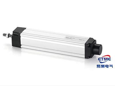

LWHÖ±Ïß´«¸ÐÆ÷£¨µç×ӳߣ©ÏµÁÐ
ͨÓÃÀ­¸ËʽֱÏßÎ»ÒÆ´«¸ÐÆ÷£¬¹¤×÷Á¿Òª´ï1250mm£¨ÆäËüÐг̿ɶ©ÖÆ£©¡£
LWHϵÁÐÖ±ÏßÎ»ÒÆ´«¸ÐÆ÷ÊDzÉÓýӴ¥Ê½µ¼µç̼Ĥ¼¼Êõ»¬¶¯±ä×èÆ÷Ô­Àí¿ª·¢³öÐÂÒ»´ú¸ß¾«¶ÈÖ±ÏßÎ»ÒÆ´«¸ÐÆ÷£¨µç×ӳߣ©£»
½ô´ÕµÄÍâÐÎÉè¼Æ¼ÓÉÏ×îеĵçÄÔÏßÐÔÐ޿̼¼ÊõÅäºÏ½ø¿Ú˿״µçË¢£¬¾¡¿ÉÄÜÌá¸ßÁ˲úƷʹÓÃÊÙÃü¼°¾«¶È¡£
LWHÖ±ÏßÎ»ÒÆ´«¸ÐÆ÷
ÌØÐÔ£º
• ʹÓÃÊÙÃü³¤,ÔËÐдÎÊý¿É´ï50X106
• ÏßÐÔÓÅÒì
• ·Ö±æÂʸßÓÚ0.01mm
• ¸ßÔËÐÐËÙ¶È
• DIN430650±ê×¼²åÍ·ºÍ²å×ù
• ·À»¤µÈ¼¶IP6
• Ð¿îÍâ¹Û

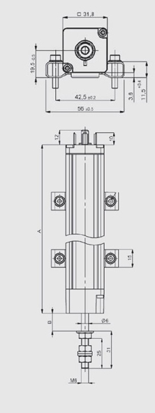

ÓÐЧÐÐ³Ì 75¡«1250mm£¬ÏßÐÔ¾«¶È 0.15% FS£¬Öظ´¾«¶È0.01mm ¡£ÐÂÒ»´úµç×ӳ߲»½öÓµÓо«ÃÀÍâ¹Û£¬¸ü¾ß±¸ÐÂÒ»´úµç×ӳߵĸ߾«¶È£¬³¤ÊÙÃüµÈÌØµã£»²úÆ·´ÓÉú²úµ½È«¼ì³ö³§¶¼ÑϸñÒªÇó¡£ÃÜ·âÐÔÄÜ´ó´óÌá¸ß£¬´ÓÒÔǰµÄIP56µ½ÏÖÔÚIP67 ÊôÓÚÒ»¸öÖʵķÉÔ¾£¡

µçÆøÁ¬½Ó DIN43650±ê×¼4¼«¶ÆÒø²å×ù
