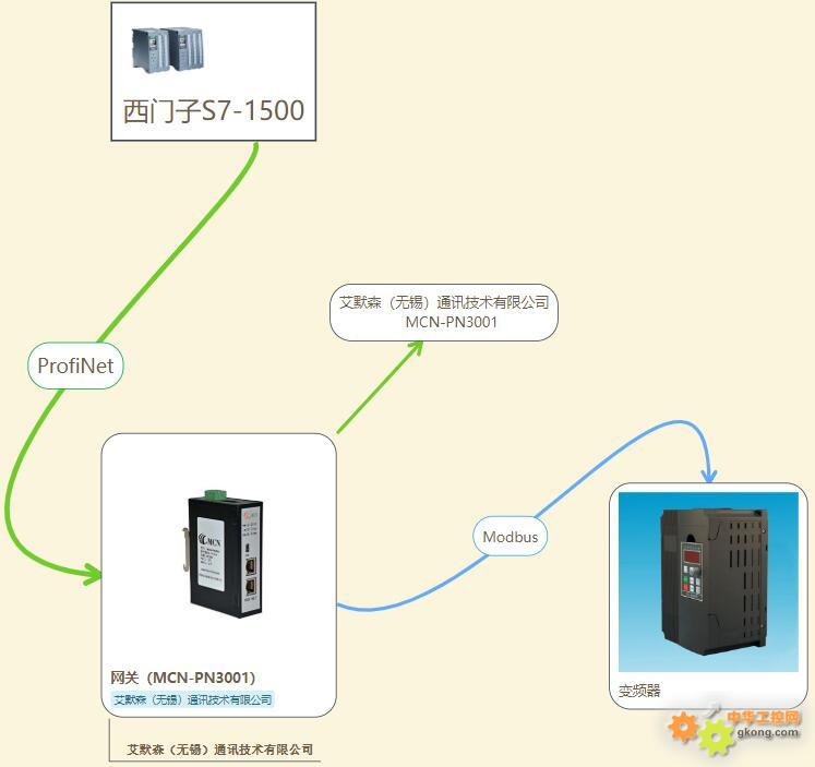

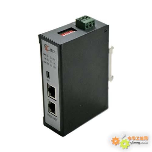

ÎÞÎý°¬Ä¬É­ModbusתProfinetÍø¹Ø»ù±¾ËµÃ÷£ºÎÞÎý°¬Ä¬É­PN3001ʵÏÖModbusתProfinet¹¦ÄÜ£¬½«Modbus½Ó¿ÚÉ豸½ÓÈëProfinetÍøÂ磬¿ÉÁ¬½Ó¶à¸ö¾ßRS232/RS485½Ó¿ÚµÄÉ豸µ½ProfinetÍøÂç¡£µäÐ͵Ĵ®ÐÐÓ¦ÓÃ:½«±äƵÆ÷£¬´«¸ÐÆ÷£¬Ö´ÐÐÆ÷£¬ÈË»ú½çÃæ£¬ÌõÂëɨÃèÆ÷£¬RFID¶ÁÈ¡Æ÷£¬ºÍ¹¤Òµ³ÆÖØÉ豸µÈ½ÓÈëµ½ProfinetÍøÂ磨ÀýÈçÎ÷ÃÅ×ÓS7-1500,S7-1200,S7-400,S7-300£©¡£
ÎÞÎý°¬Ä¬É­ModbusתProfinetÍø¹Ø²úÆ·ÁÁµã£º
1¡¢ÅäÖ÷½±ã£¬Óû§²»±ØÁ˽âProfinet IOºÍModbus¼¼Êõϸ½Ú£¬ÎÞÐèÈκαà³Ì¾Í¿ÉÒÔÍê³É¶ÔÍø¹ØµÄÅäÖã»
2¡¢Êý¾ÝÍÌÍÂÁ¿´ó£¬1440×Ö½ÚÊäÈëÊý¾Ý+1440×Ö½ÚÊä³öÊý¾Ý£»
3¡¢3ͨµÀ¶ÀÁ¢¸ôÀëRS485½Ó¿Ú£¬3·RS485½Ó¿ÚÍêÈ«¸ôÀ룬¿ÉÉèÖóɲ»Í¬²ÎÊý£¨²¨ÌØÂÊ£¬ÆæÅ¼Ð£Ñ飩£¬Á¬½Ó¸÷ÖÖÉ豸£»
4¡¢Ë«Â·Profinet½Ó¿Ú£¬¾ßÓн»»»»ú¹¦ÄÜ£¬ÏÖ³¡Á¬½Ó¸ü¼Ó·½±ãÖ±½Ó¡£
5¡¢µ÷ÊÔ·½±ã£ºÌṩµ÷ÊÔÅäÖÃÈí¼þ£¬Ö§³ÖË«ÏòÊý¾Ý¼àÊÓ¡¢Ö§³ÖÃüÁî״̬¼àÊӵȣ»
ÎÞÎý°¬Ä¬É­ModbusתProfinetÍø¹Ø²úÆ·¼ò½é£º
¶©»õºÅMCN-PN3001£¬¸ÃModbusתProfinetÍø¹ØÎªModbus/232/485תProfinetÍø¹Ø£¬ÊÇ´®¿ÚתProfinetÍø¹ØµÄÒ»ÖÖ£¬¾ß±¸´óÊý¾ÝÁ¿Í¨Ñ¶ÄÜÁ¦£¬1440×Ö½ÚÊäÈëÊý¾Ý+1440×Ö½ÚÊä³öÊý¾Ý¡£Íø¹ØÔÚProfinetÒ»²àÊÇProfinet IO ´ÓÕ¾£¬ÔÚ´®¿ÚÒ»²àÎïÀí½Ó¿ÚÓÐRS-485»ò-232Á½ÖÖ£¬Ö§³ÖModbus/RTUÖ÷Õ¾»ò´ÓվЭÒé¡£¸ÃModbusתProfinetÍø¹ØModbusÒ»²à×öÖ÷վʱ¿ÉÓÃÓÚÒ»¶Ô¶à¼¯³ÉModbus/485¡¢»òÒ»¶ÔÒ»¼¯³ÉModbus/232É豸£¬ÐγÉModbus×ÓÍø²¢Á¬½Óµ½Profinet£¬ÊµÏÖProfinet¿ØÖÆÆ÷¼à¿ØModbusÉ豸µÄ¼¼ÊõÒªÇó¡£Íø¹ØModbusÒ»²à×ö´Óվʱ¿ÉÓÃÓÚ½«ÆäËûModbusÖ÷Õ¾£¨ÈçPLC/DCS£©ÒÔ¼°ËüµÄ´ÓÕ¾Êý¾Ý´«Êäµ½Profinet¿ØÖÆÆ÷¡£¸ÃModbusתProfinetÍø¹Ø¼¼ÊõÔ­ÀíΪ´æ´¢Æ÷¹²ÏíÐÍ£¬²»ÐèÒªÖ÷Õ¾PLC/DCSµÄ±à³Ì£¬Ö»ÐèÔÚÖ÷Õ¾ÅäÖã¨ÈçSTEP7£©ÖжÔÍø¹ØMODBUS±¨ÎÄÅäÖü´¿ÉʵÏÖÍø¹ØModbusÖ÷Õ¾µÄ×Ô¶¯·¢Ë͹¦ÄÜ¡£
