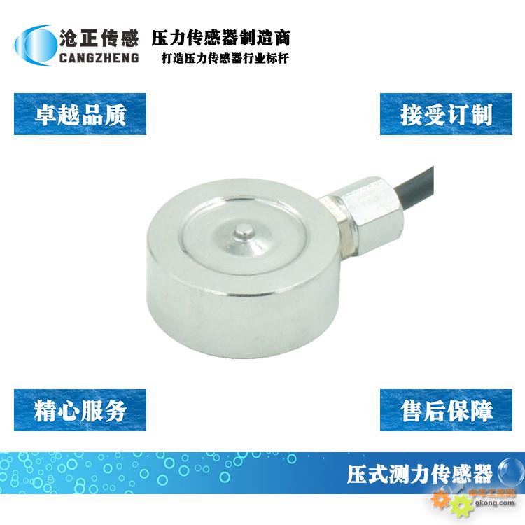

²úÆ·Ãû³Æ£º ΢ÐÍѹÁ¦´«¸ÐÆ÷_²âÁ¦´«¸ÐÆ÷CAZF-Y15
ÐÍ ºÅ£º CAZF-Y15
Æ· ÅÆ£º ²×Õý´«¸Ð
²×Õý΢ÐÍѹÁ¦´«¸ÐÆ÷_²âÁ¦´«¸ÐÆ÷CAZF-Y15
²úÆ·Ãû³Æ£ºÑ¹Á¦´«¸ÐÆ÷£¬Î¢ÐÍѹÁ¦´«¸ÐÆ÷£¬Î¢ÐͲâÁ¦´«¸ÐÆ÷
²úÆ·ÐͺţºCAZF-Y15
ÌØµãÓëÓÃ;£º
  • ²»Ðâ¸Ö²ÄÖÊ
  • ÍâÐγߴçС£¬±äÐÎÁ¿Ð¡
  • ¶¯Ì¬ÏìӦƵÂʸß
  • ÊÊÓÃÓÚÆû³µÑ¹×°¡¢×Ô¶¯»¯×é×°¡¢3C²úÆ·²âÊÔ¡¢ÐÂÄÜÔ´²úÆ·×é×°¡¢Ò½ÁƼì²â¡¢»úÆ÷ÈËÁìÓò£¬Ä£¾ß×é×°¼°ÆäËû¹¤ÒµÑ¹Á¦²âÁ¿¼°¿ØÖÆÏµÍ³

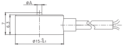

ÍâÐγߴ磺
΢ÐÍѹÁ¦´«¸ÐÆ÷CAZF-Y15³ß´çͼ
 Î¢ÐÍѹÁ¦´«¸ÐÆ÷CAZF-Y15³ß´ç¶ÔÕÕͼ
