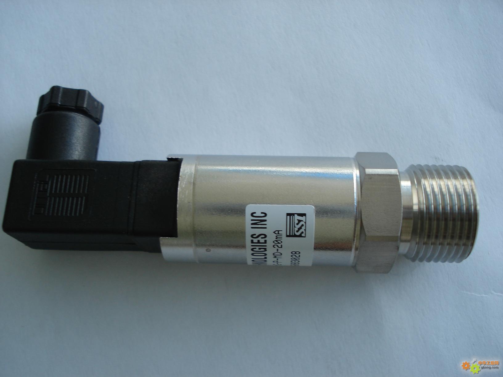

²úÆ·Ãû³Æ£º P51-16BARS-A-MD20mA ѹÁ¦±äËÍÆ÷
ÐÍ ºÅ£º P51-16BARS-A-MD20mA ѹÁ¦±äËÍÆ÷
Æ· ÅÆ£º µÂ¹úwachendorff
£¬¸Ã²úÆ·²ÉÓð뵼Ìå´«¸ÐÆ÷£¬¾­²»Ðâ¸Ö¸ôÀë³äÓÍ·â×°£¬Ìå»ýСÇÉ£¬¾«¶È¸ß£¬Îȶ¨ÐԺã¬Á¿³Ì´Ó£­100KPaÖÁ40MPa²»µÈ£¬¿ÉÖ±½ÓÓÃÓÚ¸¯Ê´¼°·Ç¸¯Ê´ÐÔ½éÖʵıíѹ¡¢ÃÜ·â±íѹ¡¢¾øÑ¹µÄ²âÁ¿£¬¿ÉÔÚ£­40¡«105¡æÄÚÎȶ¨¹¤×÷²¢±£³Ö¸ßÓÚ0.5¼¶µÄ¾«¶È£¬¹ã·ºÓÃÓÚ¹¤Òµ¡¢ÉÌÒµ¡¢Æû³µÁìÓòµÄ²úÆ·Éú²úÅäÌס£
Ó¦ÓÃÁìÓò
P51-16BARS-A-MD20mA ѹÁ¦±äËÍÆ÷ÐÔÄܲÎÊý£¨³ýÌØ±ð±ê×¢ÍâËùÓÐÊý¾Ý¾ùÔÚ22¡æ²âÁ¿µÃ³ö£©
Êä³ö·½Ê½        0.5 to 4.5 Volts    4-20 mA    1-5 Volts
¾«¶È1        <0.50% FS    <0.50% FS    <0.50% FS
ÎÂ¶ÈÆ¯ÒÆ
(-40¡æ to 105¡æ)        <0.50% FS    <0.50% FS    <0.50% FS
×ÛºÏÎó²î        <1.0% FS    <1.0% FS    <1.0% FS
Îȶ¨ÐÔ        <0.25% FS/Äê    <0.25% FS/Äê    <0.25% FS/Äê
Áãµã²¹³¥ 2        0.50V    4.0mA    1.0V
Âú¶ÈÊä³ö 3        4.5V    20mA    5.0V
¹¤×÷ζȠ       -40 to 105¡æ    -40 to 105¡æ    -40 to 105¡æ
´¢´æÎ¶Ƞ       -40 to 105¡æ    -40 to 105¡æ    -40 to 105¡æ
°²È«Ñ¹Á¦        3 x FS    3 x FS    3 x FS
ÆÆ»µÑ¹Á¦
¾øÑ¹²úÆ·        10 x FS or 15,000 Psia    10 x FS or 15,000 Psia    10 x FS or 15,000 Psia
ÆÆ»µÑ¹Á¦
±íѹ²úÆ·        5 x FS    5 x FS    5 x FS
µçÆøÐÔÄÜ
¹©µçµçѹ    5+/-0.5    8 to 30 Volts    8 to 30 Volts
¹©µçµçÁ÷    <5 mA        <5 mA
Êä³öµçÁ÷    0.45 mA  Max        0.45 mA  Max
ÏìӦʱ¼ä    <1 ms    <1 ms    <1 ms
¼«ÐÔ±£»¤    ÓР   ÓР   ÓÐ
¿É¿¿ÐԺͻ·¾³Ö¸±ê
    ²âÊÔÌõ¼þ    ²ÎÊýÖµ    µ¥Î»
Íâ¿Ç²ÄÁÏ    304L & 316L ²»Ðâ¸Ö    £­    £­
ѹÁ¦¡¢Î¶ÈÑ­»· 4    0 to FS @ 8Hz; and -40¡æ to 105¡æ    >1.8×106    ´Î
ÈÈÑ­»·³å»÷    105¡æ to -40¡æ, 0.5 hr soaks at Temp.(2s Transfer)    250    ´Î
Õñ¶¯²âÊÔ    10 to 2050 Hz, 20 Sinusoidal, 3 Axes    144s    Ð¡Ê±
µç´Å¼æÈÝÐÔ    80 MHz – 1 GHz    100     V/M
ʪ¶È    85¡æ and 90% to 95% R.H.    250    Ð¡Ê±
ÖØÁ¿    Model 51 with M12×1.5 6g 304L Stainless Port    ≤85    ¿Ë
1 °üÀ¨ÏßÐÔ£¬³ÙÖͺÍÖØ¸´ÐÔÖ¸±ê£¨BFSL£©
2±äËÍÆ÷ÔÚ0ѹÁ¦µÄÊä³öÌõ¼þÏÂ
3±äËÍÆ÷ÔÚÂúÁ¿³ÌѹÁ¦ÏÂ
4Ôڱ궨Á¿³ÌµÄѹÁ¦·¶Î§ÄÚ²âÊÔ
