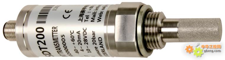

²úÆ·Ãû³Æ£º SDT200¶µã±äËÍÆ÷
ÐÍ ºÅ£º SDT200
SDT200¶µã±äËÍÆ÷
СÇɵÄ̽ͷÊÊÓÃÓÚСÐ͹¤Òµ¸ÉÔï»ú¡¢Îü¸É»ú£¨Îü¸½Ê½¸ÉÔï»ú£©¡¢ÖƵª»ú¡¢×ªÂÖ³ýʪ»úµÈ¸ÉÔïÉ豸ÅäÌ×
У׼ÖÜÆÚ³¤£¬µÍά»¤
¶µã²âÁ¿·¶Î§-80...+60¡æ £¬×¼È·¶È±3¡æ
·´Ó¦Ñ¸ËÙ
Ö±½Ó°²×°ÖÁѹÁ¦´ï20 barµÄ¹ÜµÀÖÐ
IP65 (NEMA 4) ±£»¤£¬·À³¾¡¢·ÀÍÁ¡¢·ÀË®½¦
Èü¼×¹«Ë¾Â¶µãУÑéϵͳΪ¹ã´ó¶µãÓû§ÌṩάÐÞ¶µãÒÇ¡¢Ð£×¼Â¶µãÒÇ¡¢±ê¶¨Â¶µã´«¸ÐÆ÷µÈ·þÎñ
¶µãζȲâÁ¿
 ±ê×¼Á¿³Ì
 ²âÁ¿·¶Î§ (µäÐÍ)       -60...+60¡æ Td
 ×¼È·¶È (-50...+60¡æ£© ±3¡æTd
 À©Õ¹Á¿³Ì
 ²âÁ¿·¶Î§ (µäÐÍ)       -80...+60¡æ Td
 ×¼È·¶È (-60...+60¡æ£© ±3¡æTd
 ¹¤×÷»·¾³
 ÎÂ¶È           0...+60¡æ
 Ïà¶Ôʪ¶È       0...100 %RH
 Ñ¹Á¦           0...20 bar
 ÊäÈëºÍÊä³ö
 ¹¤×÷µçѹ
   µçѹÊä³ö     12...28 VDC
   µçÁ÷Êä³ö     18...28 VDC
 Ä£ÄâÊä³ö     4 ...20 mA (3-wire)
 »úе²¿·Ö
 ÖØÁ¿           218g(4.16oz)
 Íâ¿Ç²ÄÁÏ       ²»Ðâ¸ÖÍâ¿Ç(AISI 316L), ËÜÁÏñ(ABS/PC)
 ·À»¤µÈ¼¶       IP65 (NEMA 4)
